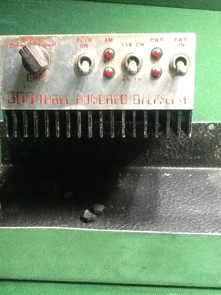

Used this liner for 30 yrs while I was trucking. Loaned it out and this is how I got it back. What do I need repair it.

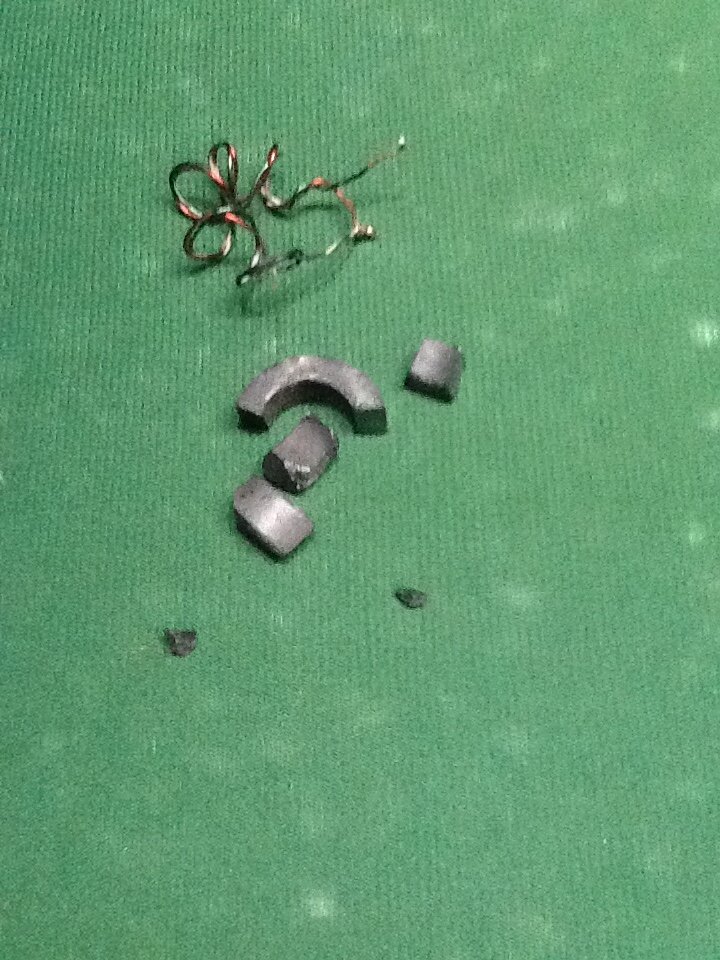

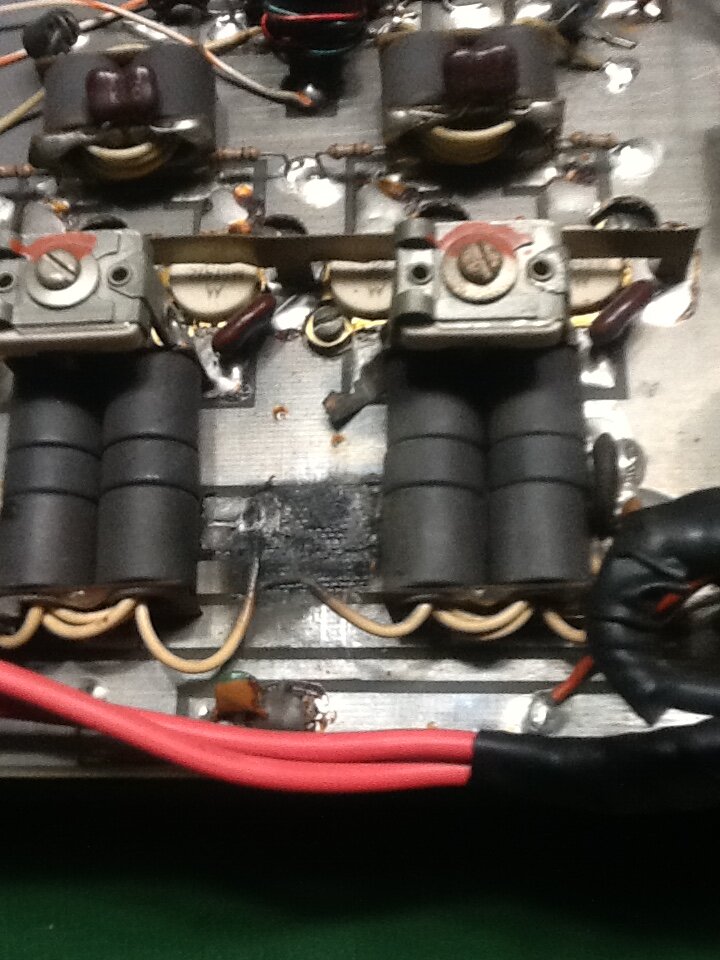

That is one torched combiner. You "COULD" get lucky and that's all that it needs, but I wouldn't bet on it. There is a strong chance that the transistors are smoked and I don't know that those are readily available anymore.
It might be the case where you need to decide just how much money that you want to throw at it.

The 'friend' did one of two things, most likely.
1: Connected it to an antenna with a bad coax, bad ground or other fault causing a high SWR.
2: Used a radio that was way too big, and pumped several times the allowable drive wattage into it.
We have found that when there are no penalties for destroying an amplifier with misuse that people tend to misuse amplifiers.
I'll guess that the guy who borrowed it has not suggested paying for the repairs.
The smoked combiner tells you that after one of the two pairs of RF transistors had failed, he kept transmitting until all the smoke was released.
Ask him if he had to open both the driver and passenger-side windows to exhaust the smoke.
Considering the age of this amplifier I would probably classify it as "totaled". Might very well cost less to replace it than to repair it properly.
