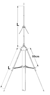

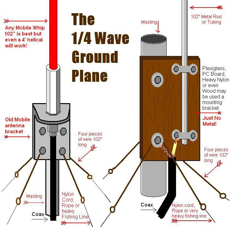

It sounds like a good ol' Avanti A400 Starduster to me. Confirm that any of the 4 sections are around 9 feet in length.- That will confirm that it's a CB Base Antenna. The 3 Ground Plane Radials slope DOWNward. Is a 1/4 Wave Ground Plane. Prolly a million of them were sold in the 1970's & '80's. Could buy then for like $35 bucks. Wide-banded with flat 1:1 SWR from 26.0-28.0mhz. I believe the orig. Avanti would take 2,000 watts but it's modern copy-replacement, the Sirio M-400 I believe is only rated for 900 to 1,000 watts.
High Angle of radiation is fine for local talking and some types of DX. But if you want BEST in a vertical then you'll want a 5/8 wave ground plane.
An original Avanti with all the parts in excellent condition - somebody may give you 2 to 3 hundreds bucks for it, especially on eBay. They're collector's items.
