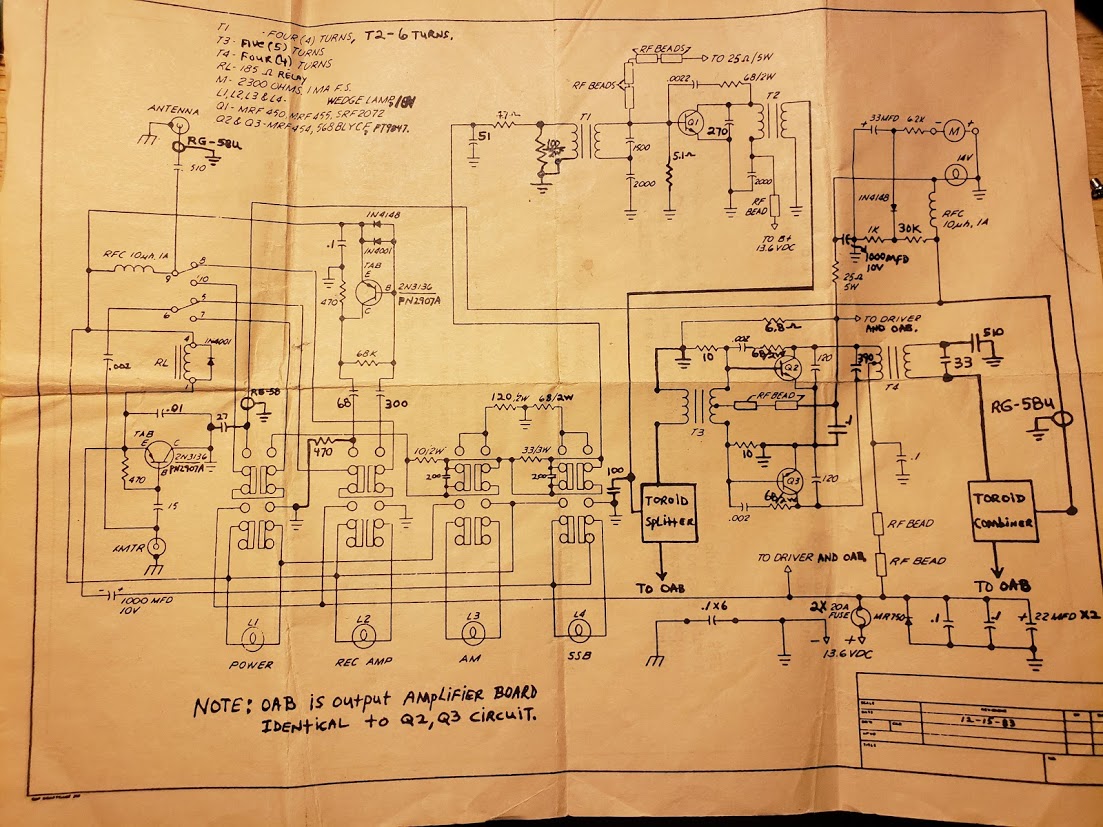

Here is an old schematic I have that might help clear some things up.
Cool! Must be the oldest DX667 schemo I've seen.
Not sure how it helps a guy with a two-fifty, though.
It lists different transistors and the wraps on the different transformers that go with them.
I think this more lines up with the DX600, but there is enough information to figure out how a 250 or 350 would have been setup.
