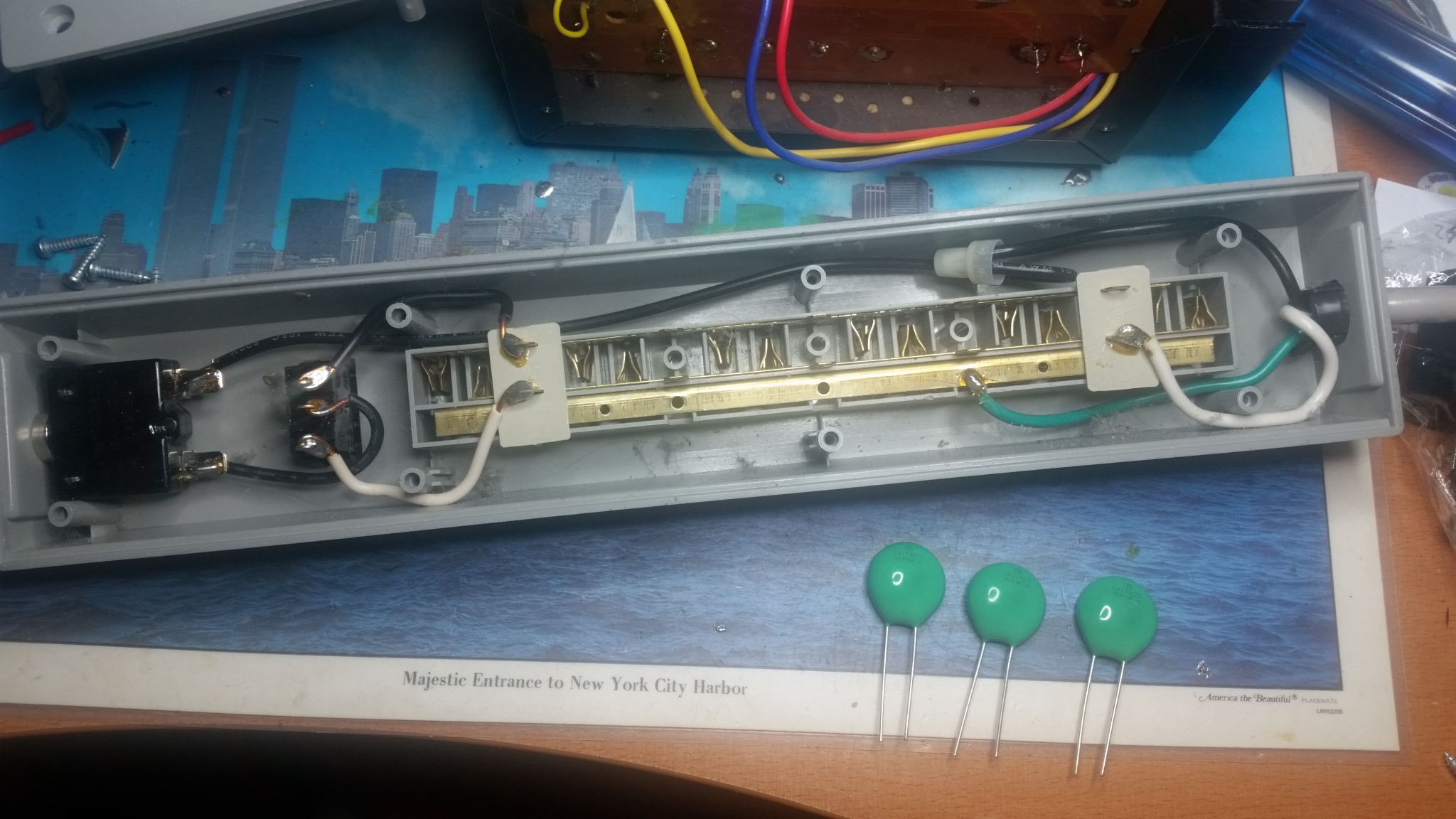

I was going to make my own power strip set-up, at my bench,
on the wall, by just mounting about three metal electrical boxes
on the wall, so I don't have to keep moving cords around on
my 6-outlet metal power strip.
But while at ACE Hardware last year, I saw this nice power strip.
27 inches long with 12 outlets spaced apart about an inch.
Also a 15A circuit breaker, and 2 ways to mount on a wall.
about 40 dollars. it can be opened up, and MOVs added.
Maybe it has one.
I just looked online and they still sell this.
Made by Monster.
(click on this) www.acehardware.com Monster power strip

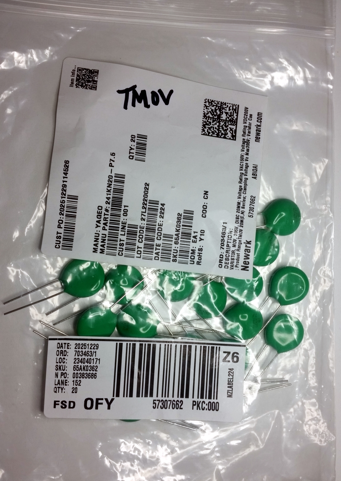

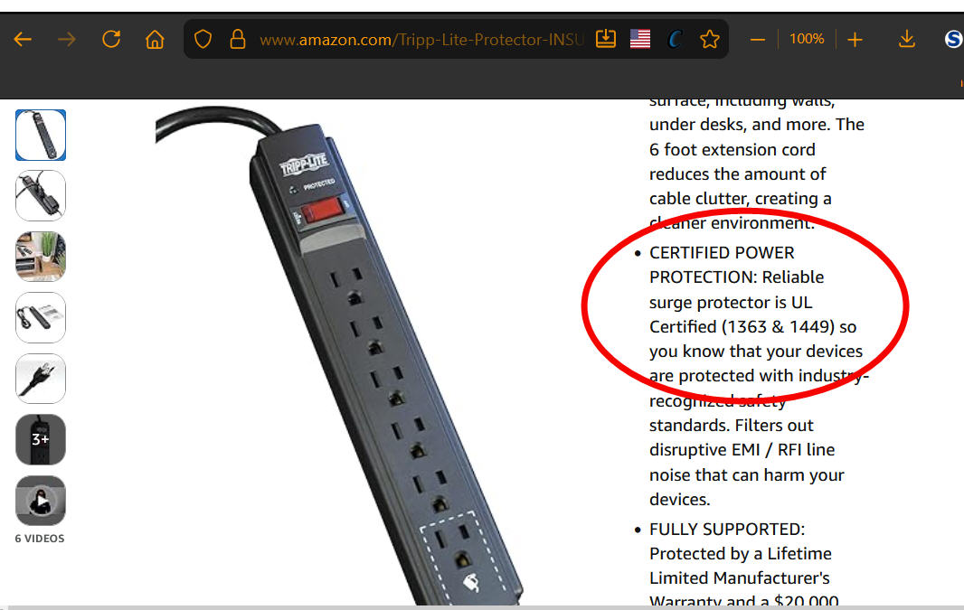

TMOV's and iTMOV's provide an extra layer of fuse protection to the upstream fusing. If purchasing a new surge protection device (SPD) or a discrete component, see that it meets the UL 1449 standard. This is for SPDs in North America.
A search on Amazon for UL 1449 compliant devices listed many but numerous failed to actually provide details that they were UL 1449 compliant.
https://www.amazon.com/surge-protector-ul-1449-Electronics/s?k=surge+protector+ul+1449&rh=n%3A172282
Still want to install your own TMOV? I asked the nearest Master Electrician, Electronics Engineer and SPD power bar designer (aka ChatGPT) on how to install this TMOV in a unprotected power bar. After receiving a tongue lashing from this "HAL 9000", it proceeded to provide instructions on how to do it properly. See attached PDF.
