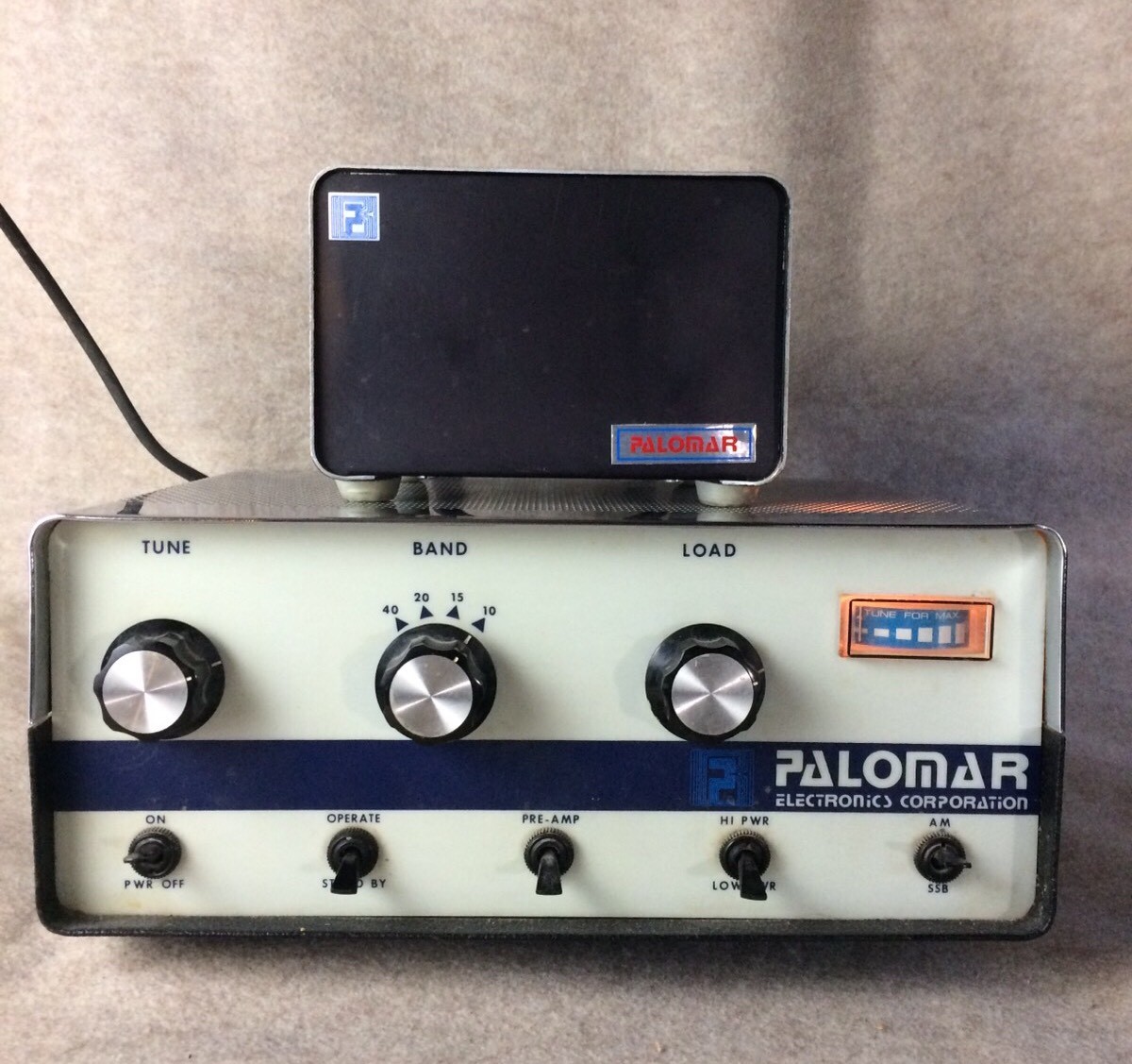

I bought this amp without tubes I think there is a couple of different ones used doe any know how to tell which ones I have yellow face black plastic switches any help would be appreciated I know there is a wealth of knowledge on here thanks for listening
A look at the diameter of the plate-cap clips will reveal the tube type it was built with.
If they are 3/8-in. in diameter, it came with 6LF6 tubes.
And if they're 1/4-in. it used 6KD6 tubes.
There are other numbers that will work, but the biggest concern will be how tall they are. The height of replacement tubes is nearly always taller than the ones it was built with. The tubes produce in the 70s were just shorter. Palomar stopped making the 300A in 1979 or so, and most any tubes you buy will be newer than the amplifier.
And too tall.
If one or more plate caps touches the metal cover while it's powered on, this is seriously bad juju for the power supply.
There is more than one way to skin this cat, but be mindful of the gap between those plate caps and the underside of the top cover.
And be safe!

Tube came 6lf6 matched for plate voltage we will see if it works was real dirty cleaned it looks like caps are new they are small 100uf only putting four watts in I will start on low dont have a variac
And too tall.
And be safe!
Just make sure to put a parasitic-suppressor choke on each of the four final tube's clips.
Good chance all you see between the clip and the plate choke where the four of them come together is plain bare wire.
The factory originally slid a small hollow bead of ferrite over each of the four plate-cap wires. It served as a choke for VHF frequencies. Serves to prevent the tubes from oscillating.
Just one problem. The ferrite bead would get hot, crack and fall off the wire.
Usually happened the first year it was used in any regular way.
That was a long time ago. What we do is to wind a four-turn coil around a 47 or 56 ohm 2 Watt resistor. The resistor's leads are usually long enough to reach from the top of the plate choke to the tube's cap.
Some amplifiers appear to work okay without these chokes. And some amplifiers will oscillate and cause headaches. The extra frequencies this produces are called parasitic signals.
The chokes serve to suppress this. Hence the name.
Or you can roll the dice and see how it behaves without them.
