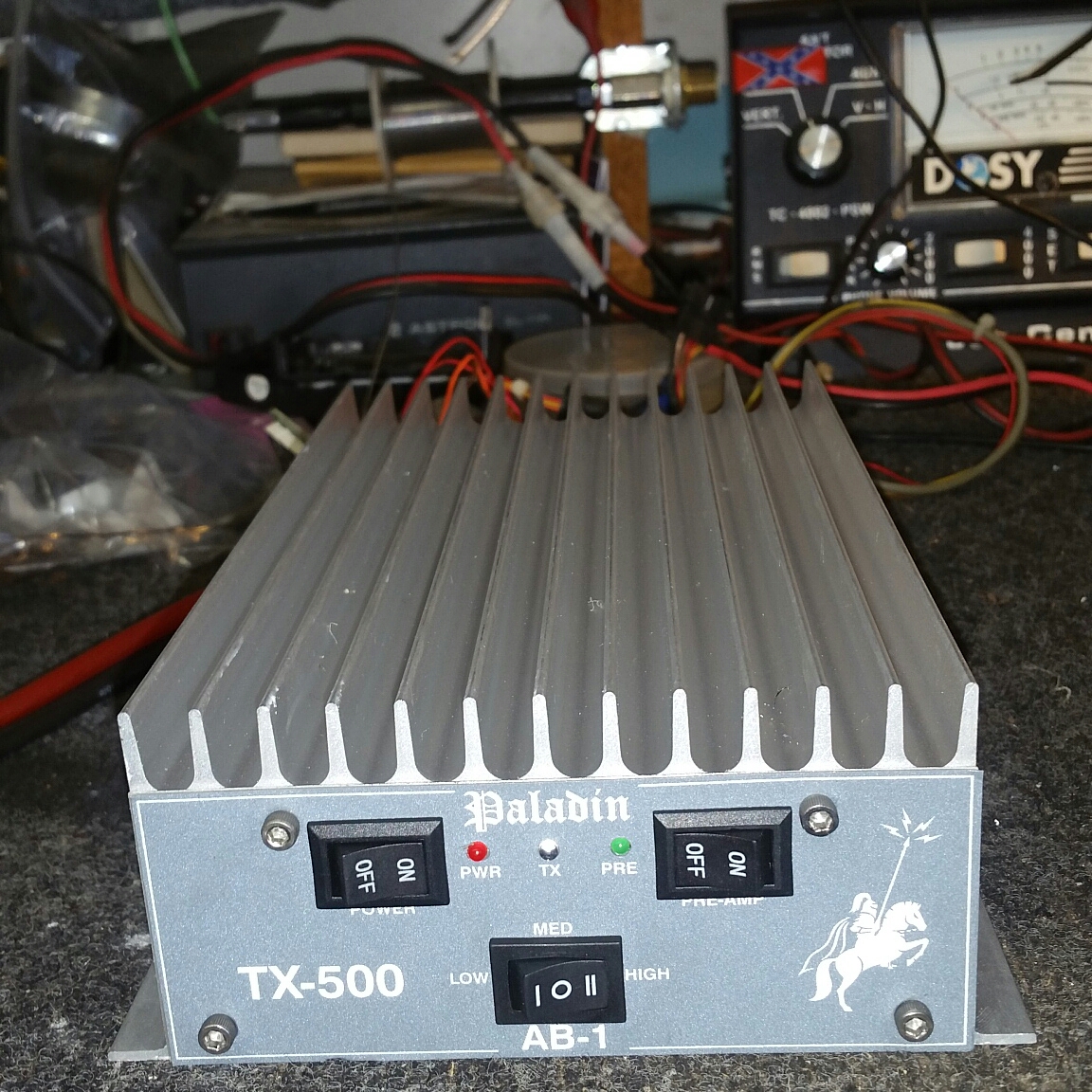

Palomar 600 with 4 2879s. If It is the amp I am thinking of there is a jumper inside to go from low drive to high drive. Either way I dont think a dual final would be to much
Does it look similar to this one.
I am know a little about them ;)
If it is like the vern built, all black amp labeled Palamar Elite or just 600, it may or may not have the bias shorted out to prevent the amp from being unstable.
Most of these were 1 1446 driving 4 1446 transistors.
A dual final export is about it if you want it to run clean.
Jeff
