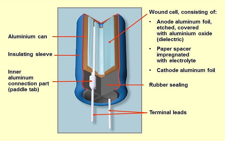

Sounds like you have done this before. Not sure what a electrolytic cap looks like, should be easy to figure this out. I have worked on military and AT&T towers. Tubes in the 60's and watched all the changes over the last 50 years. My first step will be to get the chassis out of the case and do a visual and dust off with some spray and air. Then I will plug it in. I will take some pics and post them.
I've fixed a radio or three; yes.
Its just common knowledge that electrolytic caps are the first to go; always has been and will be.
Fluid electrolyte inside dries out over time - is all.
