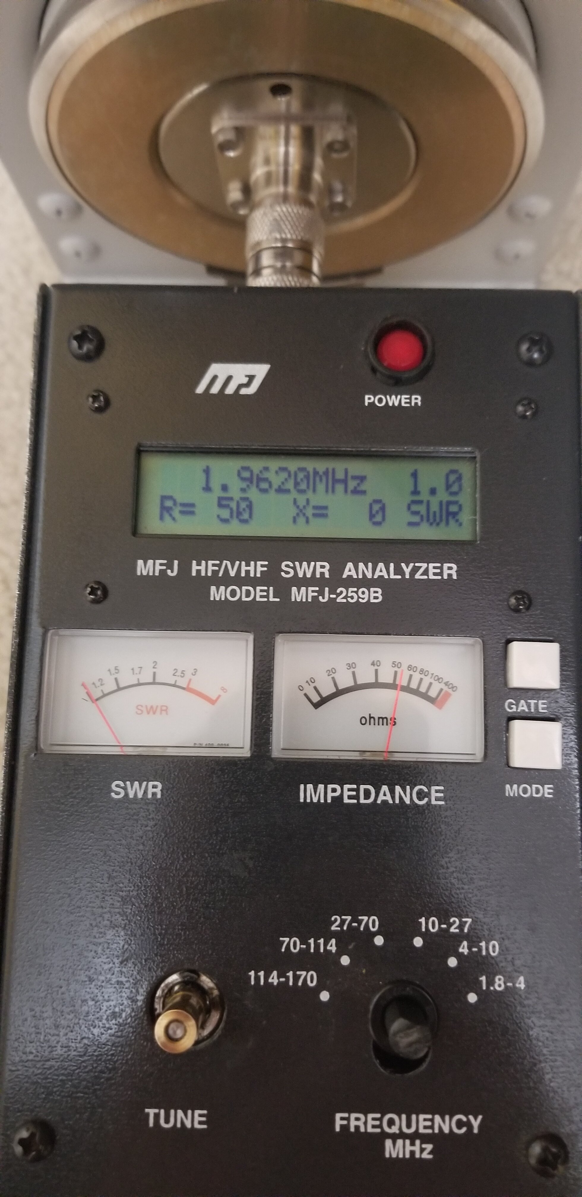

The MFJ-259B is showing 1.0:1 SWR R=38 X=0
Never shows R=50. Needs something fixed in it.

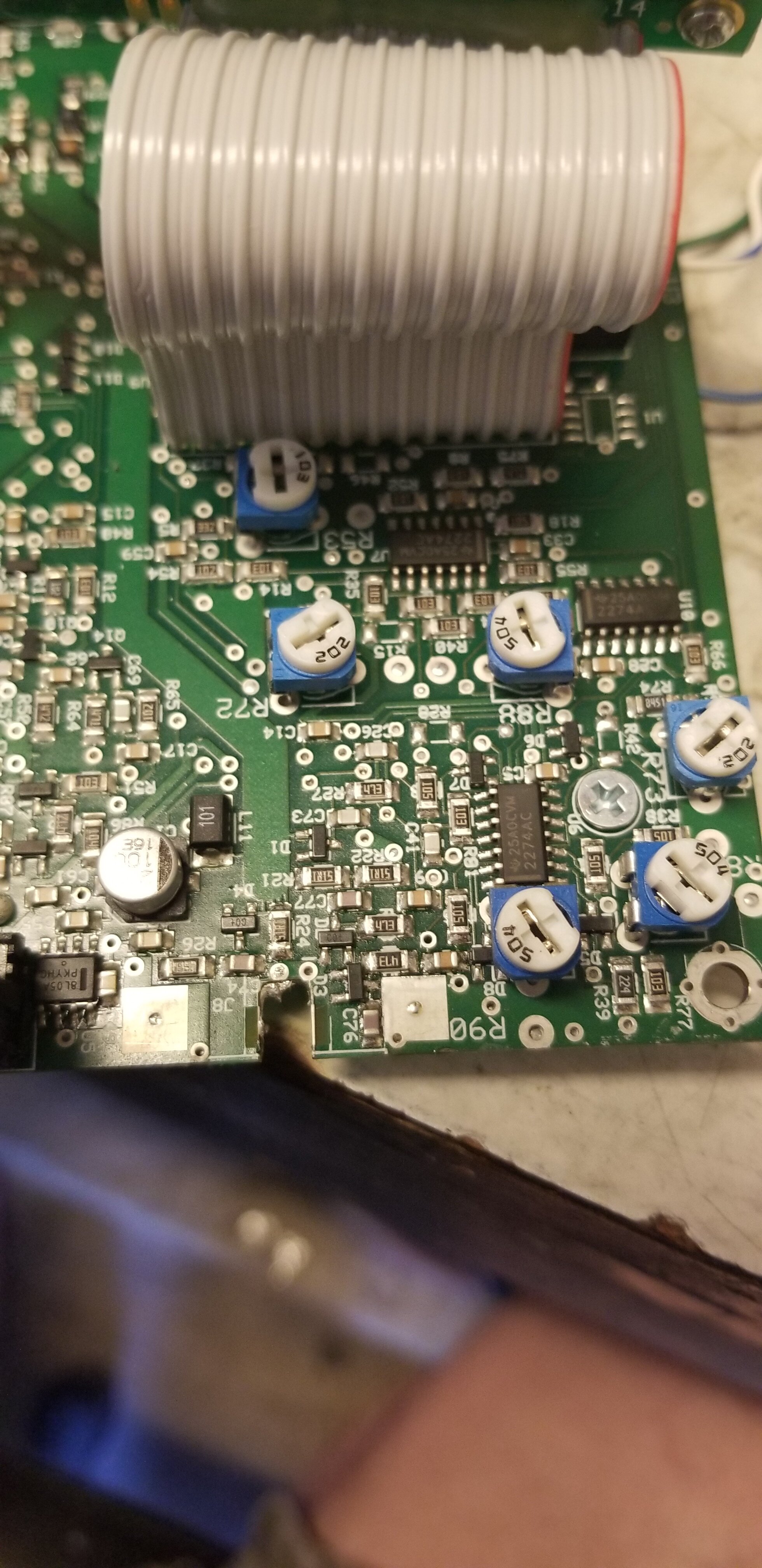

As of Sunday I am in a similar boat with my 259b. I believe it happened when I was trying to build a 6 meter matching device for my doublet. I think static zapped the detector diodes when i connected it directly to the ladder line.
It was working fine, then all of a sudden the readings just seemed weird. It shows a 1.1 swr at R=75 and X=0. I connected it to a dummy load and got 1.2 swr, r=80 and x=0.
I will open it up and try to fix. I will keep you posted if I have any luck.

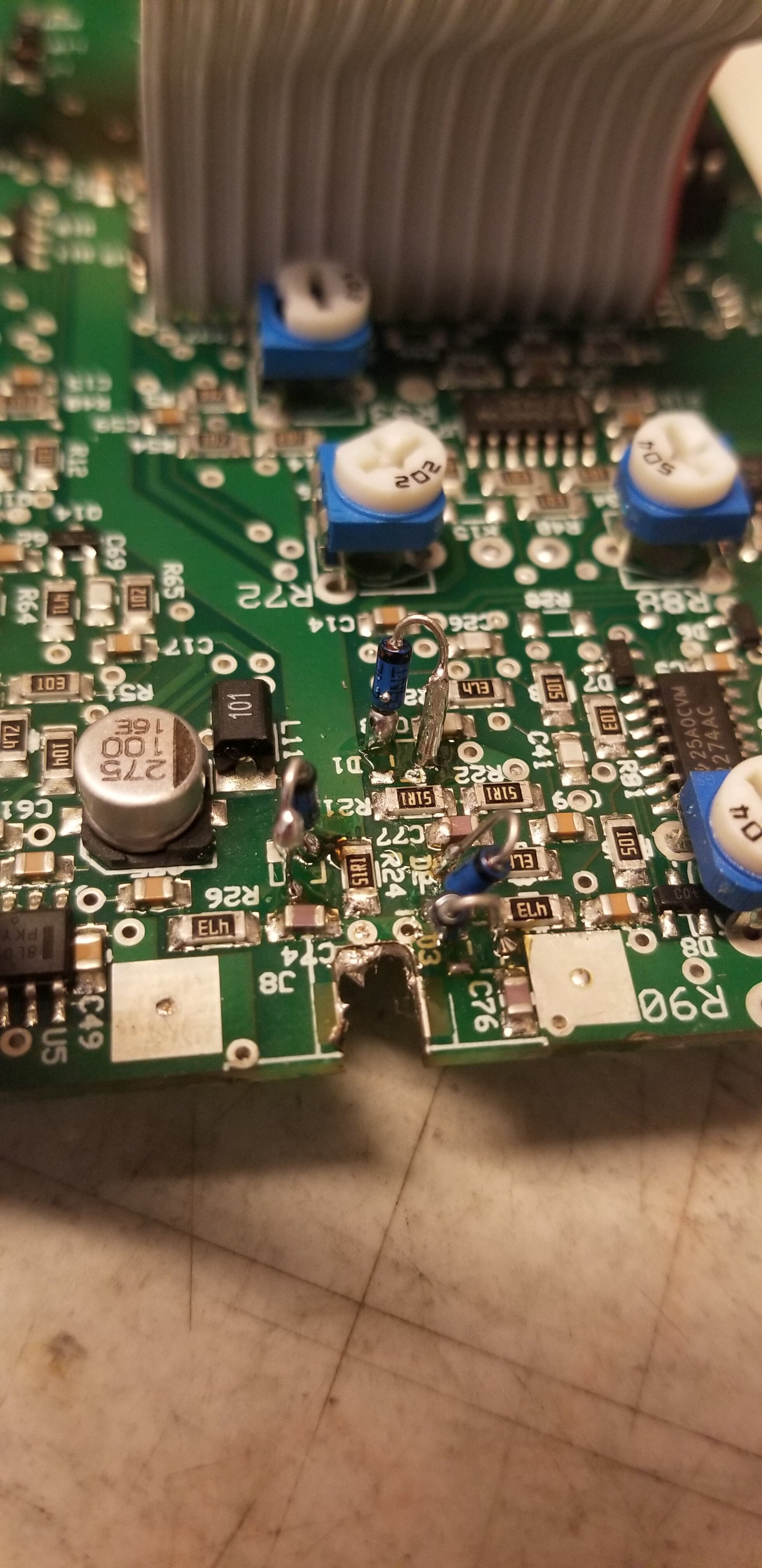

Ok. It wasn't that bad. Diodes D1 thru D4 appear to be the culprits. I don't have any smt tools but will take donations. They all tested .275 ish volts on my el cheapo muti meter and didn't show any leakage when I reversed the leads. I went to the trouble of taking the damn thing apart and decided to go all in.
I had some 1N6263 diodes in the bin so why not....
A bit off on 2m, but 2m sucks anyway. :)
Well, ain't that cool.
Thanks!
Did you know your SMT board seems to have grown a couple of diode shaped warts?
