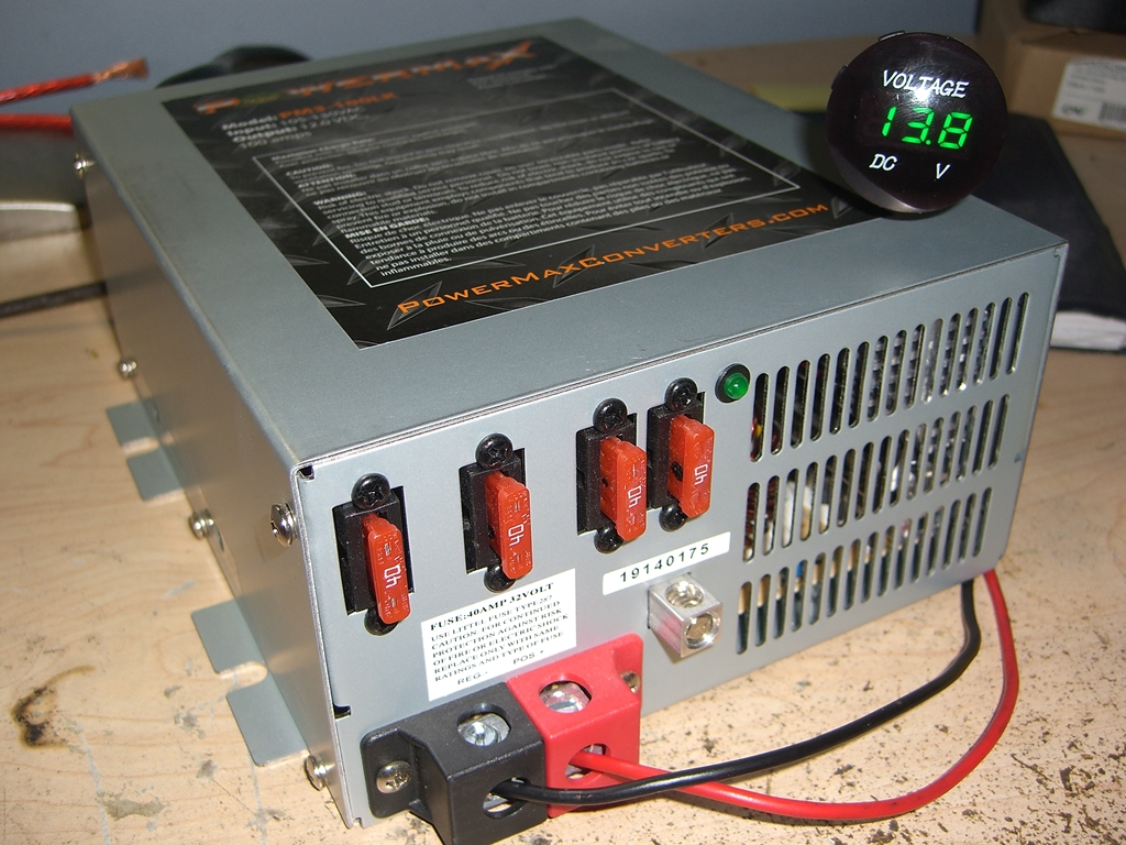

OK, I have one of these batteries, I use for backup "whatever". I have an Anderson style connector on it to connect it to my CB setup, or I can connect it to my battery backup supply that I have the internet modem and router on.
Can I use the Powermax to keep it maintained? Like if I connect it to my base setup, in parallel with the Powermax, I wouldn't have to worry about the power supply frying the battery from overcharge, would I? Right now I just use a Harbor Freight float charger to keep it topped up...
If this works, I'm half tempted to run some cables down to the modem's backup power supply and run both CB and backup off the battery and Powermax. It would not need that much current down to the backup, so no need for 8Ga there, but 2 birds 1 stone....

The powermax is designed to maintain batteries on campers. You can run through the battery, or right off powermax, while maintaining the battery. The converters are designed to cycle for batteries.
