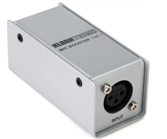

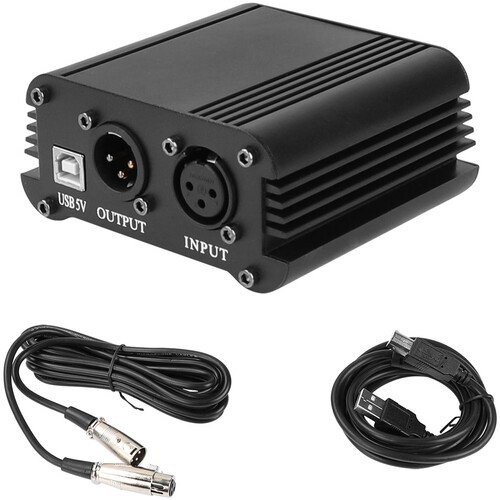

Looking for input if adding this with my Heil PR-781 mic would make up for the low audio from my Icom 746 non-pro
Klark Teknik Mic Booster CM-1 In-Line Microphone Preamplifier
BH# KLMICBSTRCM1 • MFR #0838AAT86001
CAMVATE 48V Phantom Power Supply with USB Cable Adapter and XLR Cable
BH# CAC2660 • MFR #C2660

You don't need Phantom power for this mic.
I would rather add RF speech processor.
Mikethe reason for the experiment is that the non-Pro model has lower-level audio inputs. The Pro series upgraded to higher-gain mic preamplifiers designed to handle a wider variety of microphones.
A W2IHY device will add both speech processing and input gain - that's what I would go for. In fact, that's what I did when i had a 746. And I kept for the 746 Pro and later the Elecraft K3.
