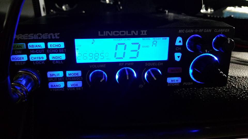

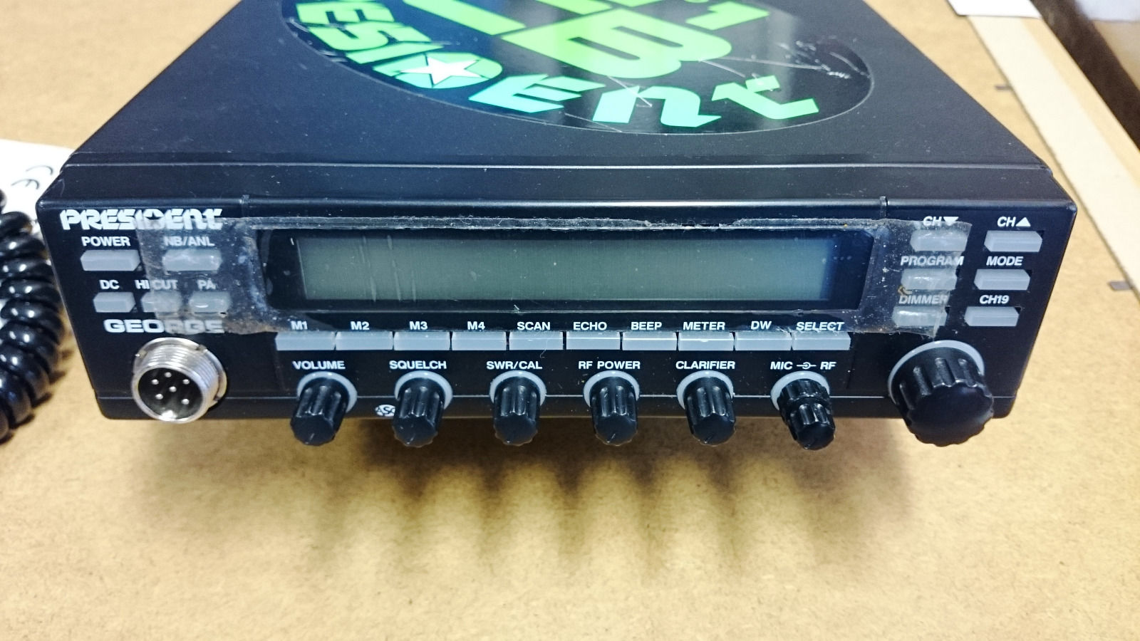

Hi folks and what I'm after is assuming both radios are in great shape and tuned similar, WHICH is the usual better OVERALL performer in your HONEST opinion please ? ? ?
When you put your vote in, please give at least a short description as to why you lean towards one or the other or maybe some folks think they are so close to really tell which is...
THANKS in advance - Retro

I can't speak about the Lincoln II but can offer some insight on the George as I have had two of them. They are good radios but have a couple of design and feature quirks that may be off-putting for some.
The high point of the George is it's receiver which was so amazing that even today it holds up as one of the great ones. Quiet, sensitive and the ASC somehow knows the difference between a weak signal and static so it won't sit there and 'chatter'. I repeat: When properly aligned the receiver on the George will hear a dime drop on a carpeted floor in a bowling alley 100 miles away. It's that good.
With full metering the George will let you know what's going on when. The dual-color selection is nice and the display is easy to read even in the brightest light.
While I am not generally a fan of roger beeps, this radio has a rather pleasant one. Also enjoyable is the echo, which is either on or off. The level is variable but that has to be done on the inside of the radio. Again, it's really a good feature on this rig. Enough echo to put some punch behind your voice, not enough to make you sound like a yahoo.
Plenty of internal power and the George has a front-panel RF power adjustment.
Frequency coverage is somewhat lacking if you plan on using this on the 10m band. IIRC it tops out well before the voice portion of 10m. Curious thing about the George: It was the first CB radio to use it's own internal software to make the frequency mods. Depending on the sequence entered it would operate on 40 CH US, 40 CH UK FM, or International mode which gave you everything.
In 'International' mode the dimmer switch becomes the bandswitch.
I tried many different mics on mine and never really found one better than the stock mic but YMMV. BTW, if anyone has a stock mic for a George, I'd be interested in buying it!
If the George has any one fatal flaw it would be the inability to move the frequency in less than 5 KHz increments and the clarifier (which only moves the receiver) is only good for about 2KHz. It's not much of an issue on AM but on SSB it can be annoying when trying to tune a signal. Also the knobs are kind of small and difficult to adjust in a mobile environment.
The built-in security system is a pain as it has to be re-entered every time the radio is powered on unless it hooked to a constant 12v source. I've never found anyone who can bypass this and it can be a hazard because after 3 or 4 attempts if the wrong code is entered the radio will brick and has to be sent back to President- assuming that they still support this model after so many years. Remember: they came out in the mid-90s.
I went to the George after my HR2510 was stolen. In many ways it is a superior radio to the 2510 but the lack of fine-tuning on the VFO, small knobs and that annoying security system keeps me from putting it on my personal All-Star list.
In spite of it's quirkiness I like it. They don't come up for sale very often so if this is the one you are thinking of adding, don't delay.

I heard a Linc 2 on 10 meter once. The guy should be ashamed to operate it. Worse sounding mobile I have in quite some time. And the George only able to tune in 5 and 10 khz steps, what a joke. Instead of putting roger bleeps and echo crap in these radios, why not DSP and maybe repeater offsets and PL

Lincoln 2 has offsets and tones.
Funny thing too about the Lincoln 2 sounding bad on 10 meters. They only sound bad when you tell the other operator it's a Lincoln 2. When you tell them it's a yaesu 857D they suddenly sound great. My biggest gripe with the Lincoln isn't Roger beeps and echo chambers they have "off " buttons but rather the frequency layout.

Now to add another set of info to this post... I do already have the President George and like it quite a bit ! I just bought a mint like new with box and everything and enhanced in all the ways I enjoy my rigs upgraded President Lincoln 2 version 3 and it's due to arrive this week... So I'll update with some impressions and thoughts appropiately when I can to add to this post. I sure appriciate everyones input so far !

I had a brand new 99v2 and it was junk. Not knocking all 99v2's just the one I had. QC must have been absent the day mine was built. President Lincoln 2 is a much better radio than the 99v2.
