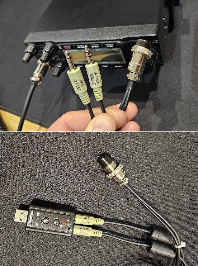

FYI - the new AT-6666PRO (will be released next month) supports all this, and has VOX all built in, so you wouldn't need the Signalink. You could make a simple cable to do the job. It's also much more stable than the LII+ which is a help for digital modes. Also, there will be an update to the AT-5555Nii which will also support this same functionality soon. Maybe something to think about.
As fourstringburn said, you could also go for something that is made for the job, like a 7300. It depends how serious you are and where your interests lie.
A pic of my cable for the AT-6666PRO is attached.
