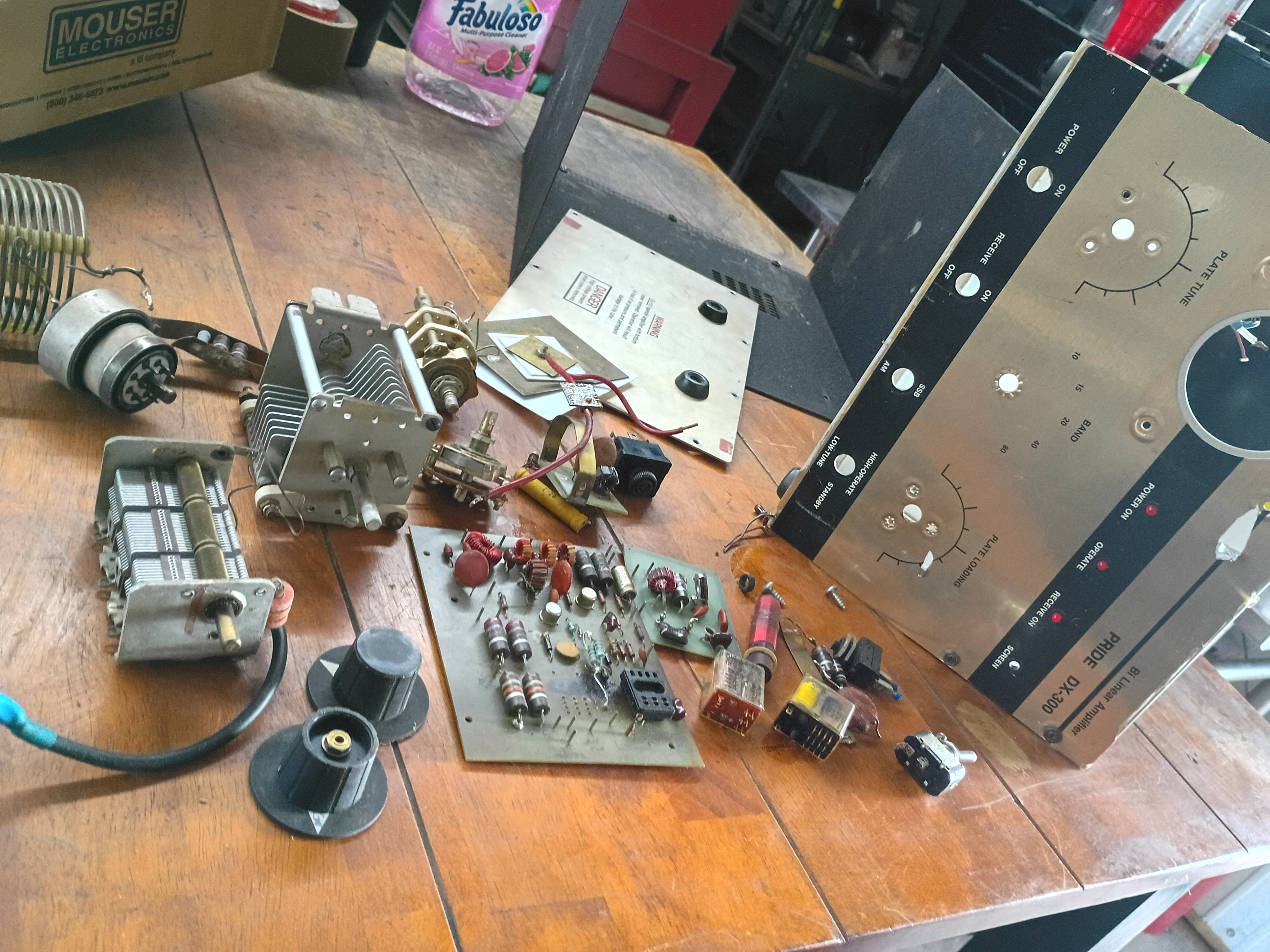

I've got what I call a pride puzzle!
It was given to me by a good friend. And I'm really a fan of these dx300 amplifiers so I must bring it back to life!
So far here is what it's missing or will need.
Missing both transformers.
Missing plate choke.
Missing meter.
Missing main relay socket on the burnt up input board! So will need a new relay/ input board.
Missing all the switches.
Missing the blower fan.
Will need a new face Plate. ( No problem as I sell them and plenty in stock)
Will need both of Hv and Lv Nomad boards and anti suicide updates.
Will need a new tube.
I've got a couple new old stock covers so won't have to do any painting and body work to this nasty cover.
And I'm sure lots of little things like missing screws ect.
I've already acquired a High voltage transformer from Nomad! (Thanks again).
No reply from Mr. Bill Curd on his FB page about a low voltage transformer. But I've found that Floyd has replacements in stock at his website Eagle Made. So I've got one one the way.
I'm already about $450.00 into this amplifier and will needs lots more before it's done! Lol
Probably end up having more into it then I could sell it for! Lol but what can I say I like working on them and hate to see it in its current condition.
I better get to chewing because I think I bit off too much !
Wish me luck.

The road to Hell is paved with good intentions. The DX300 I'm rehabbing this week was gonna be the photo model for my HV transformer substitute package instructions. But I got greedy and it's being rebuilt with the original HV transformer. I'll get paid sooner this way. But there's another derelict Pride in the back room. With any luck I'll use that one to shoot instruction pics.
Then again, if you think you've got the idea from the body-bag post, just reach out. If you don't need the whole step-by-step spelled out there's no reason you should have to wait for it to get composed. I have the transformers and the modified HV pc board on hand. Still haven't come up with a price. Really oughta do that.
