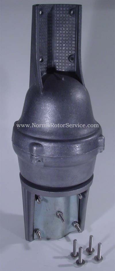

Also, any problem with putting a rotor at the top of the pole (since I am discarding the top section, this should give a little more 'meat' at the top)? Suggestions on mounting the rotor would be appreciated.

Don't discard the top section slid it down inside for extra strength...use all the other sections slide down inside as much as possible to get just past the top support at 25 ft.
Leave just enough of the biggest section at top of well mounted (Bracket/LAG screws etc...) near the 25ft support to mount rotor. Then add only enough tubing out of the top of the rotor to mount beam (1-2ft) and hope for the best...Anything more and Guys are the only answer to support rotor and suggest 3 element beam(Horizontal only)...Maybe a Moxon (2 element) would be something to think about...otherwise your asking for a issue ! IF beam was to be Vertical...Suggest not!
Make sure the bottom of the pole is secure(say drive a H/D pipe 2-3 ft down) and slide bottom of pole over that...The mount at 10-15ft should also be very secure to building(NO FLEX) in pole...
