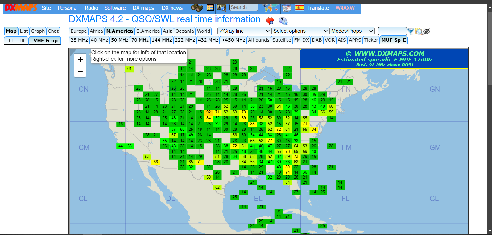

6m veterans
is the Sp-E info shown above:
A) Accurate
B) Somewhat accurate
C) Useless
If accurate should these Sp-E levels be supporting stateside SSB propagation? Is the band open but few stations are taking advantage? Is the band not open at these Sp-E levels? Or is my Moxon @30 ft just too lame to hear the traffic? Or is the majority of the traffic using the FT-Cheat modes?
Enquiring minds want to know..................
7 3
Reactions: AudioShockwav
The maps are fairly accurate. I've been using them for years.
Not sure about 6 meters, but 11 is wide open right now across the whole of North America & beyond.
I have everything from the East Coast to California coming in right now as well as most of the Pacific Rim countries and much of South America. It's literally S9+20 on every channel.
I would imagine 6 meters should be hopping as well (I don't have a rig that goes up there), but there are only a tiny number of operators up there compared to 11 so it can seem very empty (just like 10 meters) even when there are amazing conditions.
Openings on 10 & 11 meters are apples/oranges to 6m. Most HF openings over the past few months have been F2 layer. In my short experience the F2 MUF rarely gets high enough to allow 6m openings, most are Sporadic E layer or Tropospheric ducting openings. Sporadic being the key word.
Regarding the map above, I'm just trying to learn what to look for to try to catch the rare openings a bit more often. Hoping to pick the brain of someone who's experienced a bunch of Solar Cycle maximums
7 3
7 3
Yes 6 does not play be the rules
Actually, there are times I think it makes its own rules.
The band is silly. Almost Flatline CK. Then you get a burst and a run from UK/Euro like I had in Nov. I have never experienced quite this low of activity on SSB/CW. The Sun is not pumping out some "particle" 6 meters needs. I keep hearing the so-called experts ...wait...wait it will be F2 madness this Winter...Well here we are...Hello .. over :love: :cool:

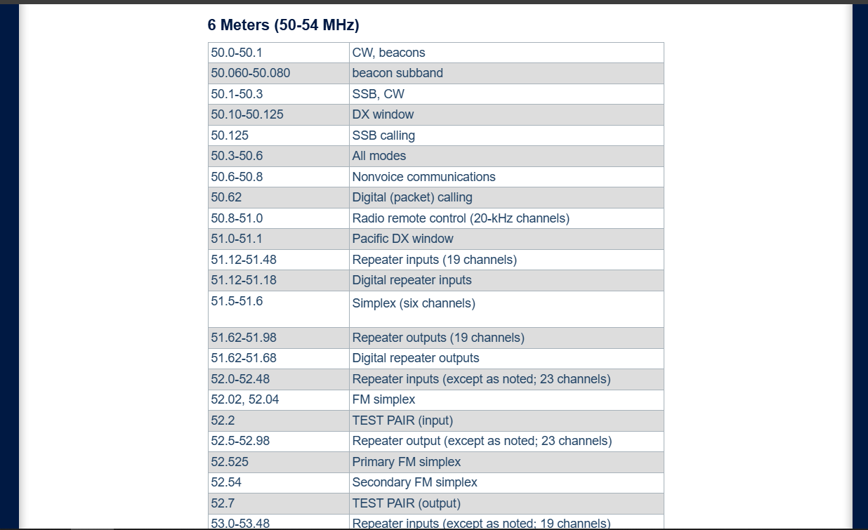

I am 100% new to 6m...
I just am confused on where to go since you get about 4 MHz of of the band, but thats a lot. Any tips or pointers on where to go or to monitor? And if I wanted to go QSY to a different frequency, where are some ideal spots?
What modes are you looking to use?
Screenshot (70).png https://www.arrl.org/band-plan
Mainly SSB, so looks like the chunk of 50.1 to 50.3 is the window for that. Unless I am seeing it wrong, then the calling frequency being 50.125 MHz. So it would be ok to use lets say 50.130, or would it be better to go to the all modes portion of 50.300 to 50.600?
50.100 to 50.125 is the SSB (USB) DX window. North American stations do not call CQ in this window but can work any international DX stations calling CQ/QRZ. 50.125 is the NA calling frequency but you can call CQ on any freq in the SSB portion, generally 50.125 to 50.200. Most mornings east of the Mississippi there may be some traffic on 50.145, from just before sunup and lasting for 1-2 hours.
