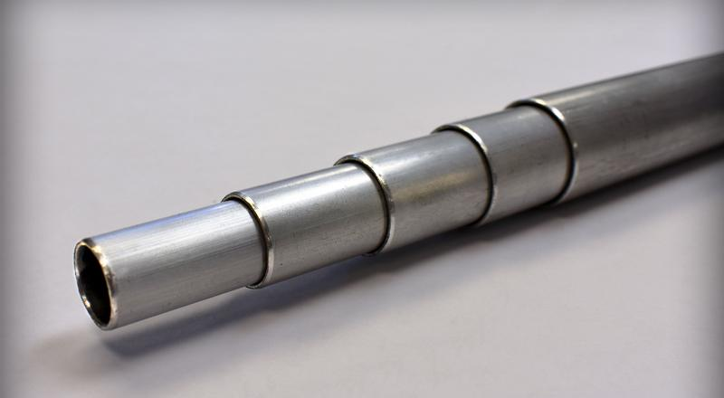

Appreciate it. I did save some aluminum tubing from a bed I recently took out of the house. That may work out just fine. :)
Reactions: AudioShockwav
You only need Two pieces 56 inches long...be easy to tune if the tubing would slide together

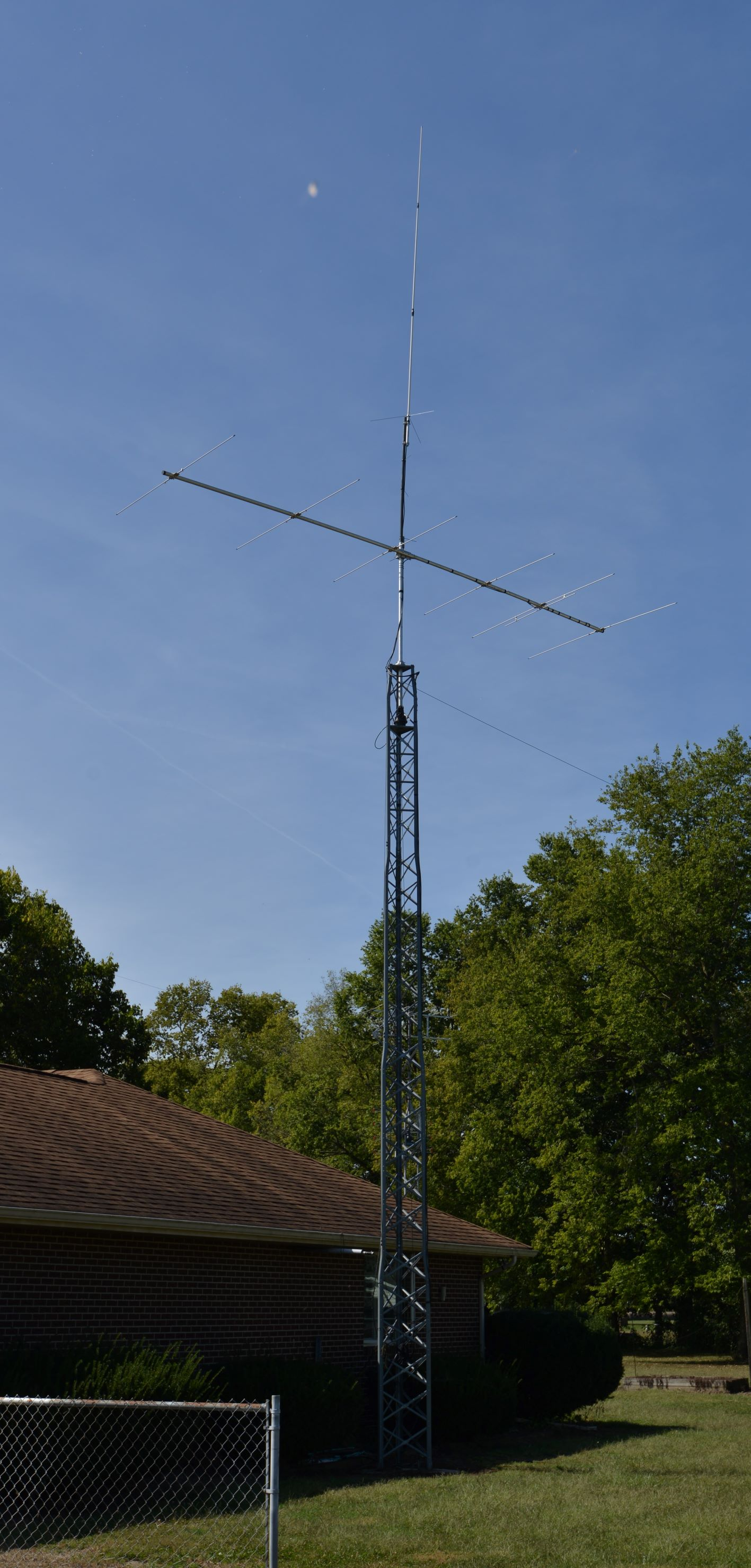

What's your rotator Gary?
A 15+ year old Yaesu DX800XA ...that has been abused!! Way overkill for that antenna...I'll be adding a 12-element wide space for 2 meters (14 ft boom) in Spring...New longer mast and all new 1/2" Heliax on 2m/vert and 6m beam....Hmmm still don't have a 440 antenna... :love: :coffee:

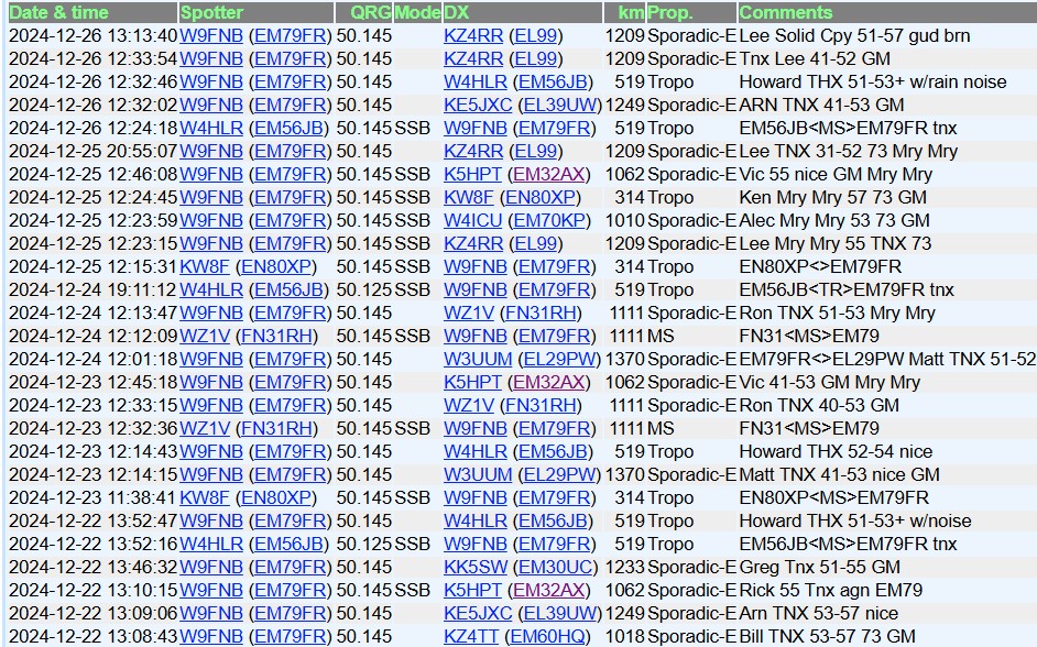

We still have quite a few on EVERY morning from 11:30z to 13:00z+ on 50.145 USB...I'll average 5-6 US States every morning...couple weeks ago had 11 states /several VE-VA's...all in about a hour...Yea 6m never open:cool:
