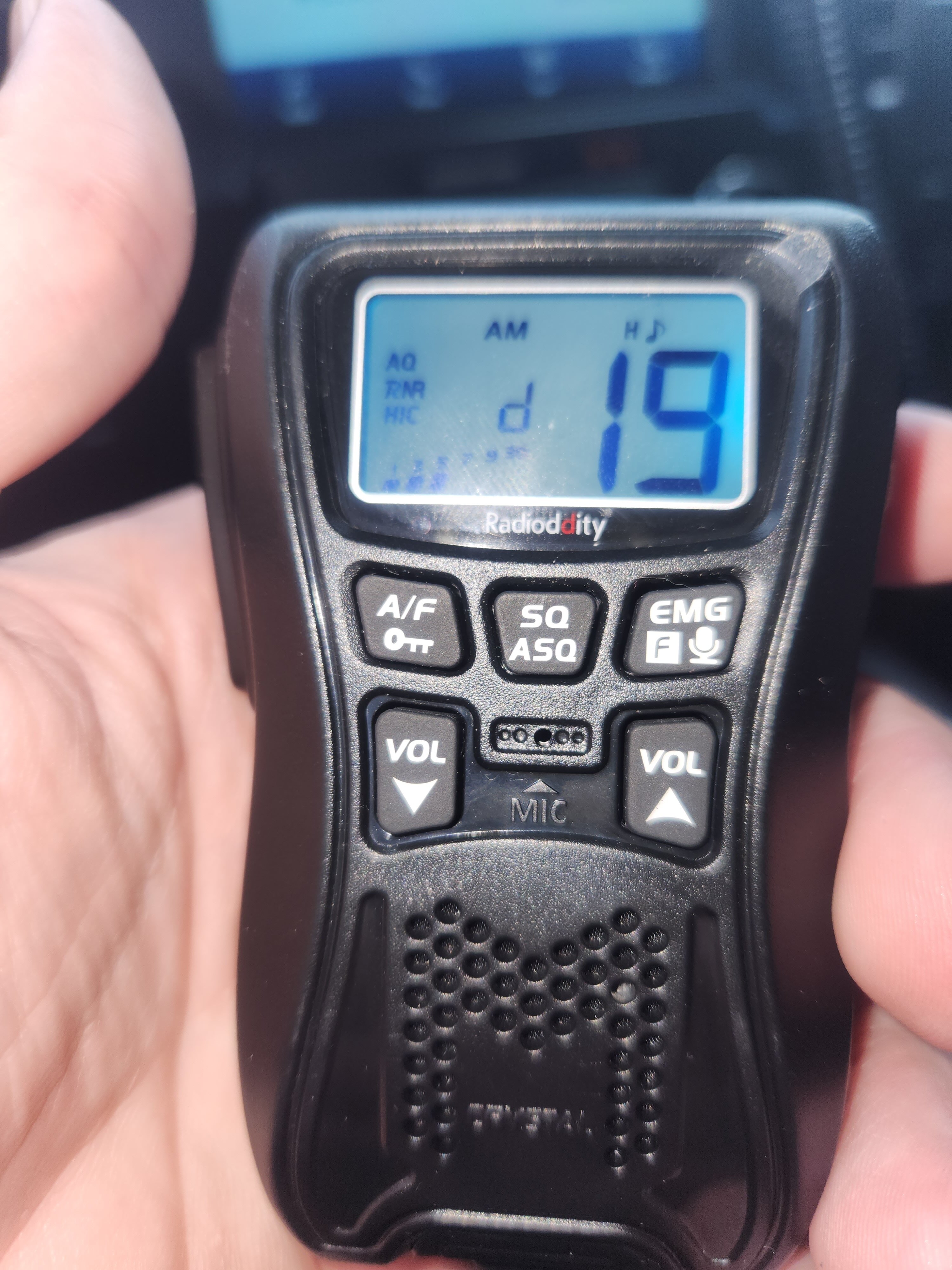

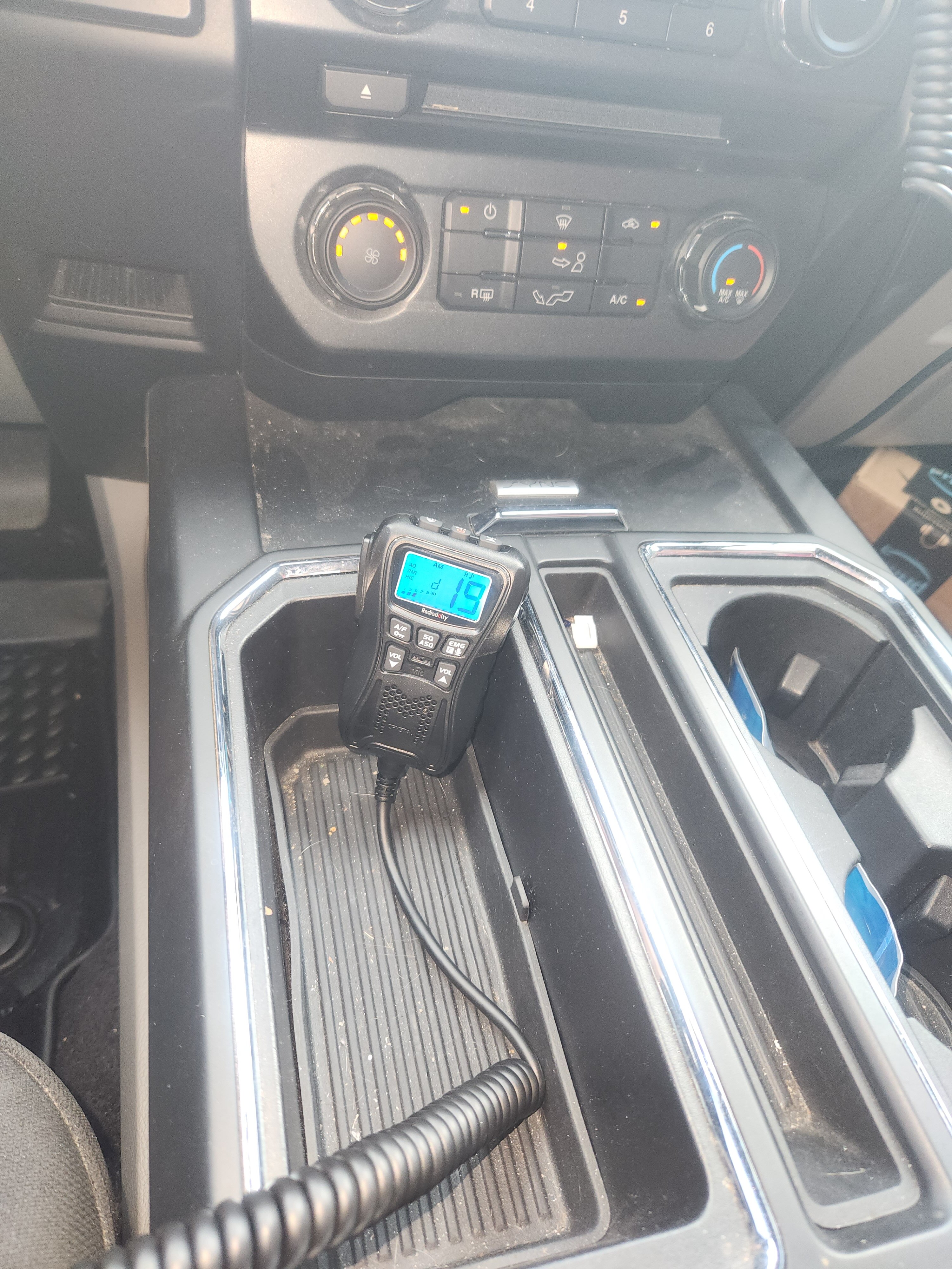

Got a nice little fully featured AM/FM one hand mobile radio recently.
It is a rebadged Anytone Graces.
So far it's been great fun. It has all the fancy stuff like transmit DSP and recieve DSP, auto squelch (like President's ASC) the only thing is there's no rotary volume or squelch these are controlled through the menu system which can be annoying. That said, it's a killer little radio and the guts of it are in a box approaching the size of a pack of smokes for those of you that smoke. The mic feels excellent in the hand just the right shape and weight.
The "mic" also contains the speaker and all controls. It connects to the guts box via a cat 5/6 cable. I added an extender to route this invisibly up to my center console. It's new to me still but for 100 bucks it's a steal. I've done the one jumper conversion and have all the expanded bands. Oh yes, despite what one YouTube video advises, do NOT cut the white wire! This puts you up in the 28mhz 10m ranges and you can't get back down. Had to re-solder my white wire and add some heat shrink. Stick to moving the jumper one space over.
