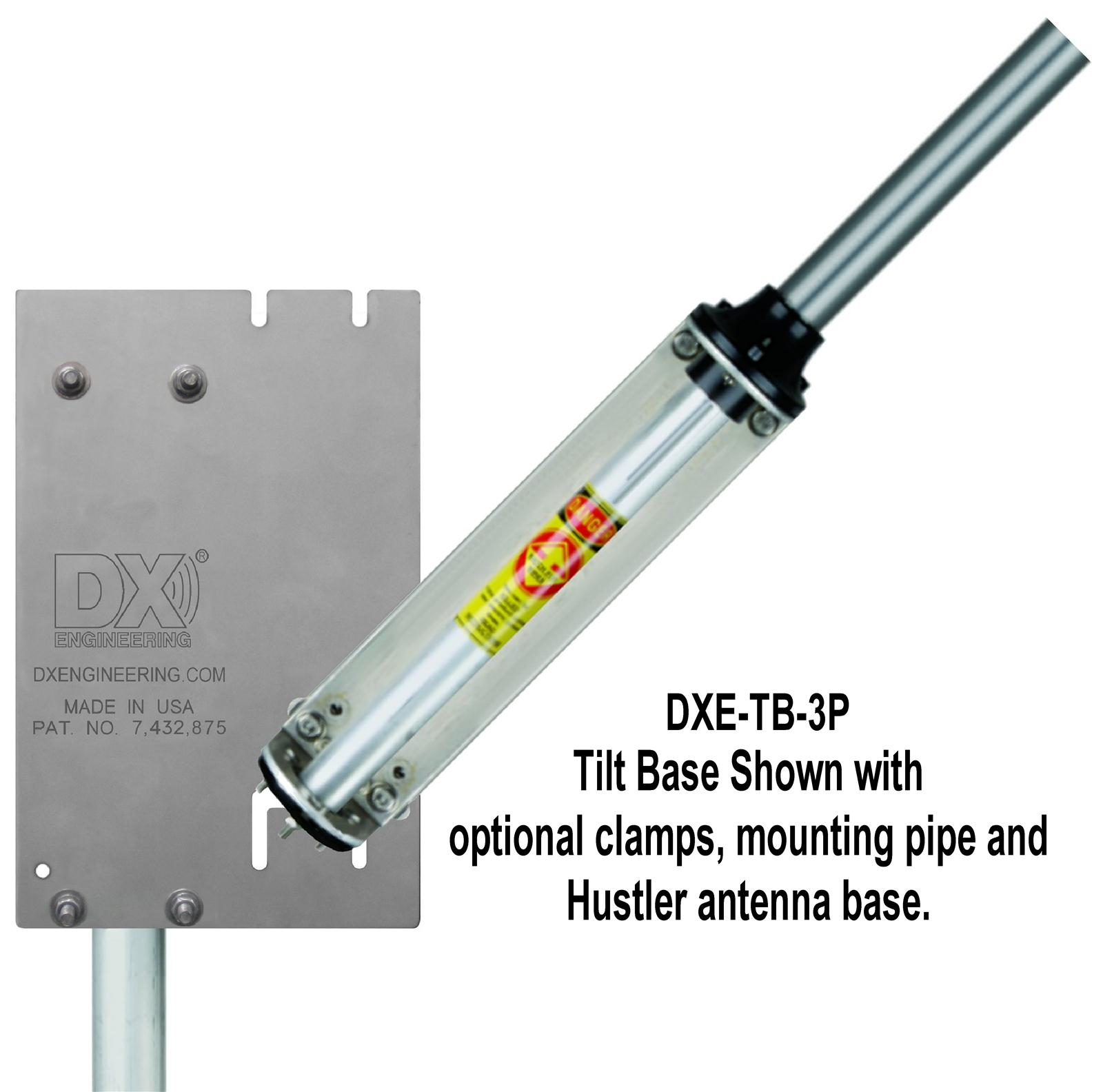

Be interesting to see if a tilt-over mount (say, for a camper) might be utilized. We're thinking about picking a 20ish footer up at some point and I can see doing a lot of POTA activations when camping. This would be a little more manageable solution than the 6BTV I was thinking about using, albeit with manual band change.
The antenna is light enough that it will probably work, assuming you can find a sturdy enough mount. I don't think I would try it with the typical CB-style fold over as the leverage with an antenna of this size will be too much. HiQ Antennas makes one that will work.
