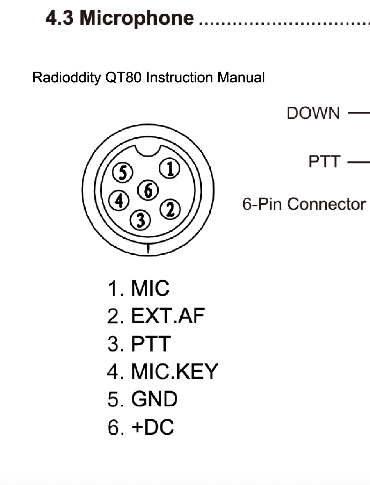

Somebody help me out. Here is the Mic wiring from the QT80 Manual. Unclear is Pin 4. wtf is Mic Key? For Cobra 4 Pin matchup would RX (black) go to Pin 4 ?

Somebody help me out. Here is the Mic wiring from the QT80 Manual. Unclear is Pin 4. wtf is Mic Key? For Cobra 4 Pin matchup would RX (black) go to Pin 4 ? View attachment 73723
4. MIC.KEY is for the UP and DN buttons on the microphone.
FYI - On some other radios (like the AT-5555Nii and QT-60) the UP and DN keys are shared with the PTT line, which can result in unwanted channel jumping if your microphone connections become high resistance (dirty, worn out, not connected securely, etc). Moving this function to its own dedicated pin solves this potential issue.
Here's what I'm wanting to do. Scored used like new 80 for $205 shipped today. Going to use as base. Would like to put my D104 TUG8 to it. From what I've seen on other diagrams and explanations ..... only 3 wires of a 4 wire mic are needed. Audio to 1, (red TX) to 3 and Shield to 5. The Black (RX) wire on a 4 wire (cobra) would be No Connection. Can you confirm this Pez or anyone else reading? Thanks !
