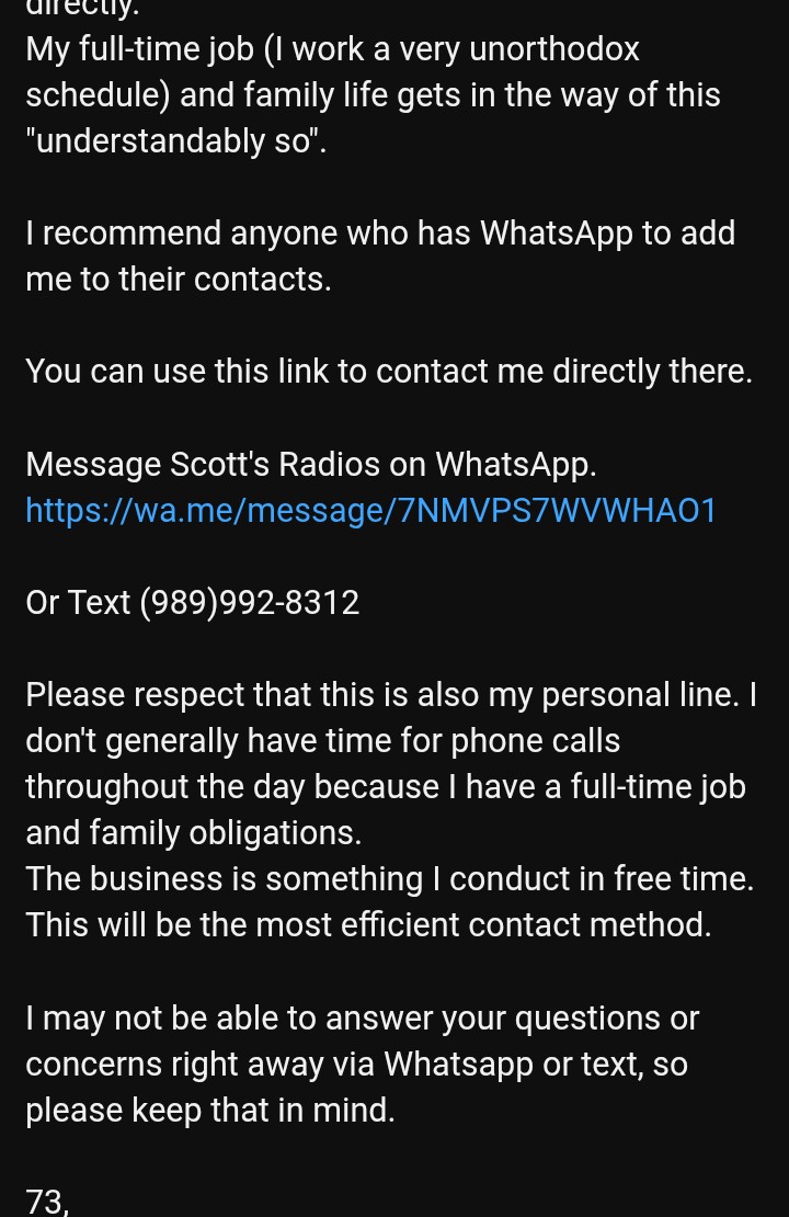

So anywho I just ordered this Adapter from Scotts. Not many peeps seem to be carrying them. Wallcott has one with a 6 inch cord extender to it for twice the price ..... so I'm getting this Standard Adapter from Scott's ..... despite the fact that his website does not indicate In Stock or not nor does he post a phone number for contact ...... who TF Business doesn't have a phone number?
He has it posted on his YouTube page, he isn't a full time radio shop it's a second job so to speak.
Here is a screenshot
