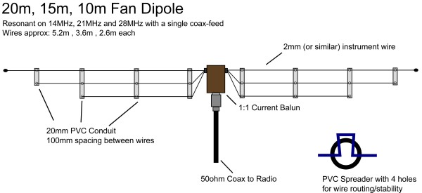

a fan dipole uses a common feed point for all the elements, the mfj-918 or any other 1:1 current balun would work fine

a fan dipole uses a common feed point for all the elements, the mfj-918 or any other 1:1 current balun would work fineView attachment 20784
So I can take the 918 1:1 balun hang it on a wooden pole. Start with my 20m wire, then eventually add a 10m and 40m to the same set of eyelets on the left and right sides of the 918. keeping in mind to use PVC or some other means to separate the antenna leads by 100 mm.
so I can take the 918 one to one balun hanging on a wooden Pole. start with my 20m wire. then eventually add a 10m and 40m to the same set of eyelets on the left and right sides of the 918. keeping in mind to use PVC or some other means to separate the antenna Leeds by 100 mm
YES
