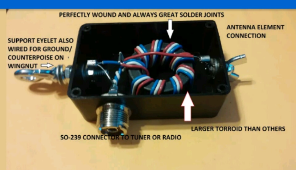

Ordered today end fed box with 9-1 unun in it. 40' of LMR-240 and 2 new PL-259's.. I plan on using ground counterpoise wire on the end fed box too.
Did measuring, I should be able to get to 45-50 on a slope..
Then both rigs will be up and going..
Who knows if you need 9:1 since no one know your antenna resistance nor reactance.
Mike
Its an End Fed matchbox from EBay. Has a 9:1 unun in it, has ground/counterpoise lug on outside of matchbox as well.
I ordered up the MFJ915 1:1 choke/balun inline with double SO239 on each end..
The 'matchbox' end fed maker suggests no counterpoise/ground on the actually box.. But does say if I want to use the 1:1 choke/balun to put it at the feed point. (Guessing antenna feed point just before the matchbox)..
Does that make sense??
