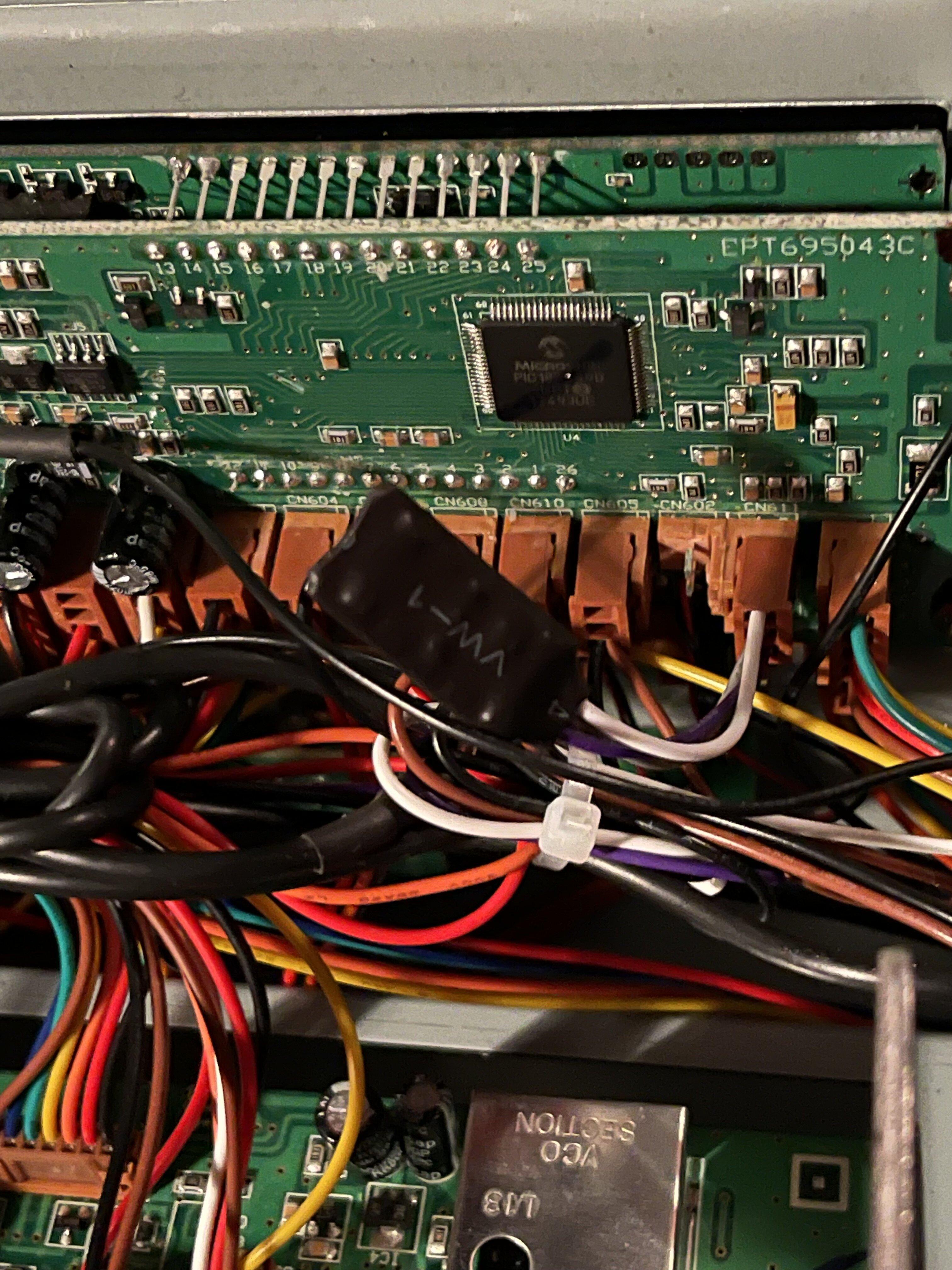

As the 2995DX comes into the country, it's a ham-frequency radio only, 12 and 10 meters. This is the only way they can get it across the border on the up-and-up.
A small module, I call it the 'dongle' is plugged into one socket on the computer/display circuit board. This unlocks all the frequencies between the two ham bands, from 24.5 to 30 MHz.
Some dealers just plug it in before shipping the radio. Others will pack the module, usually between the inside and outer cartons. Getting it installed is then the buyer's problem.
