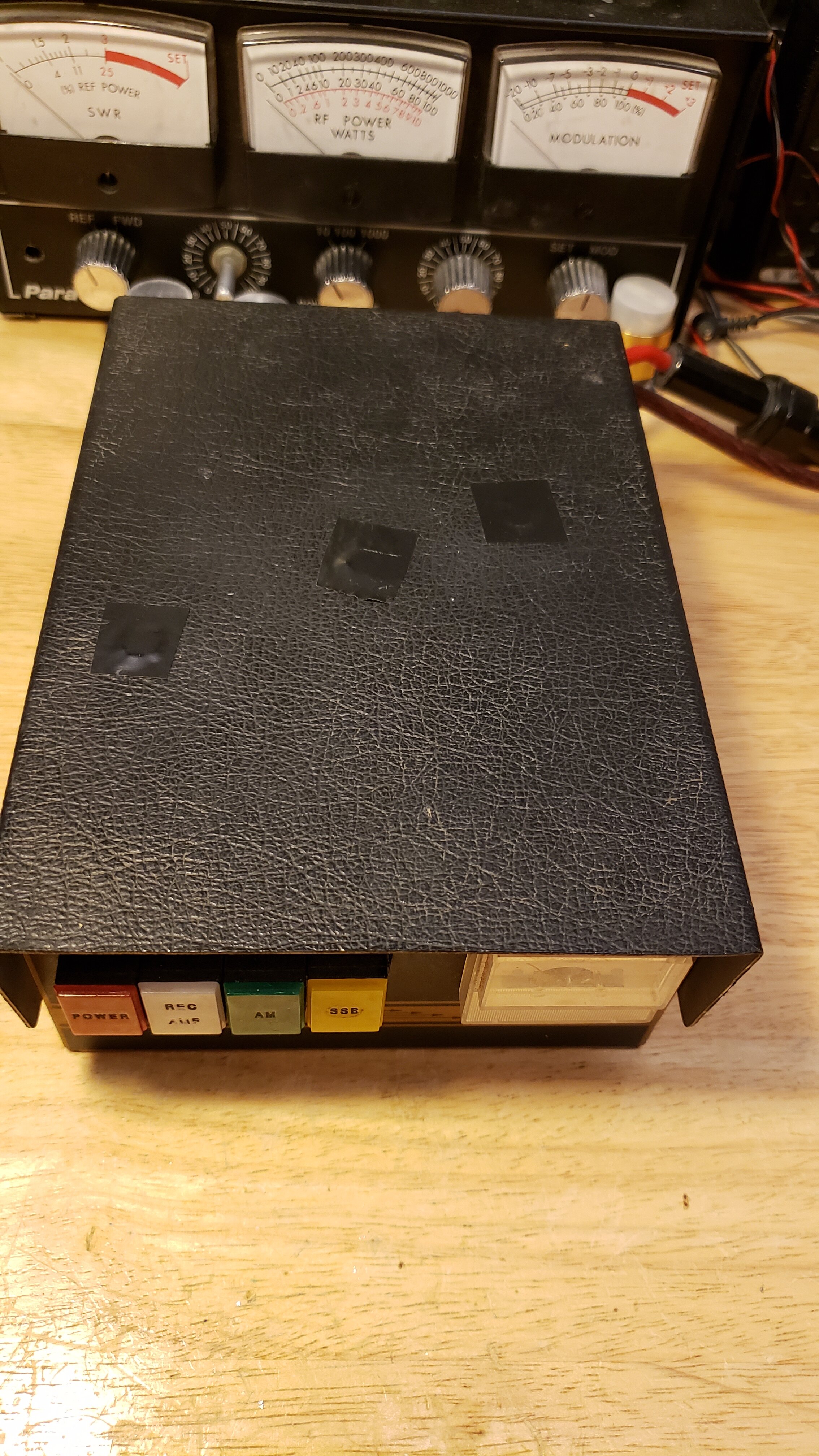

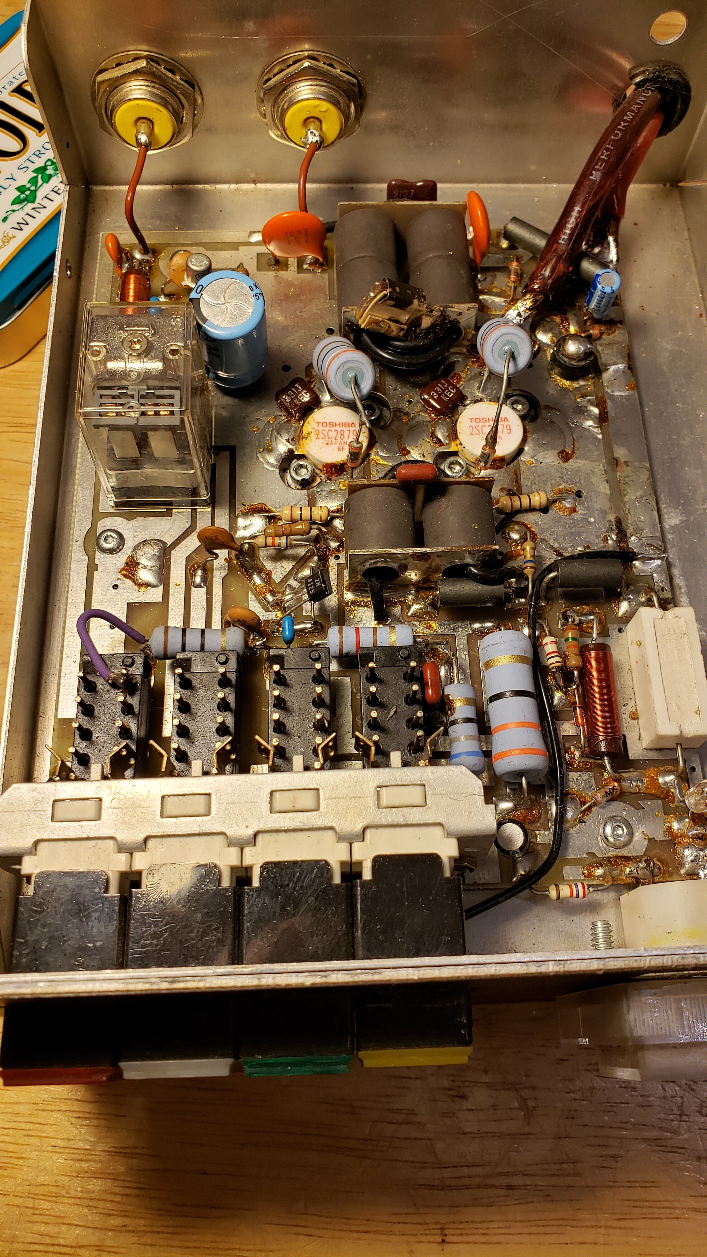

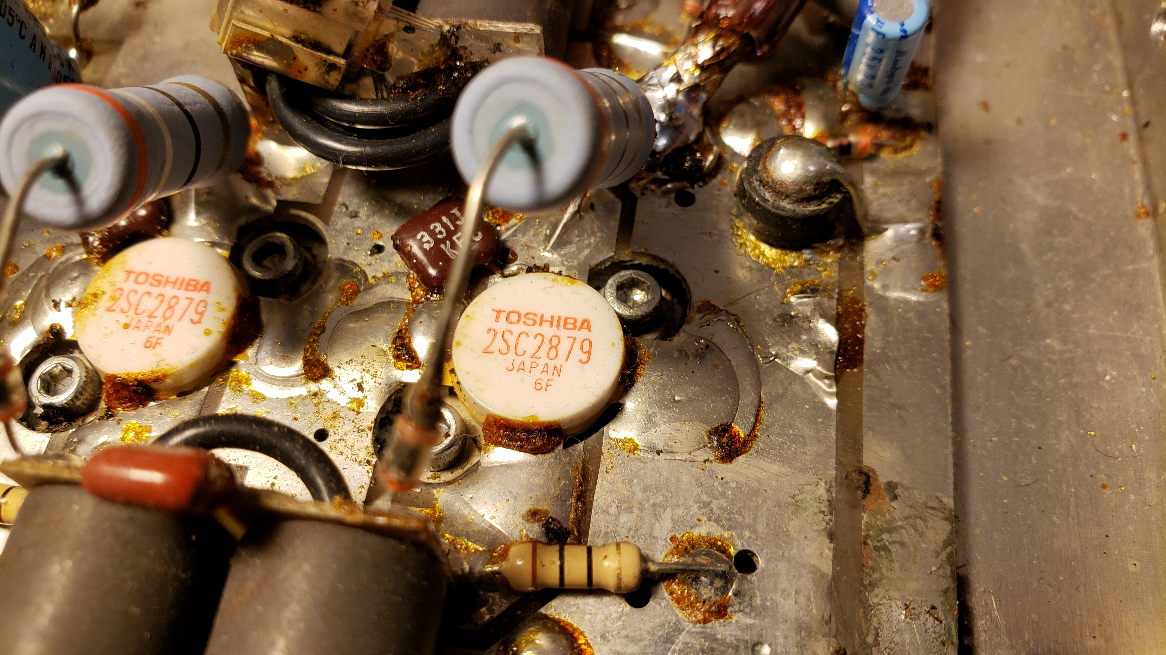

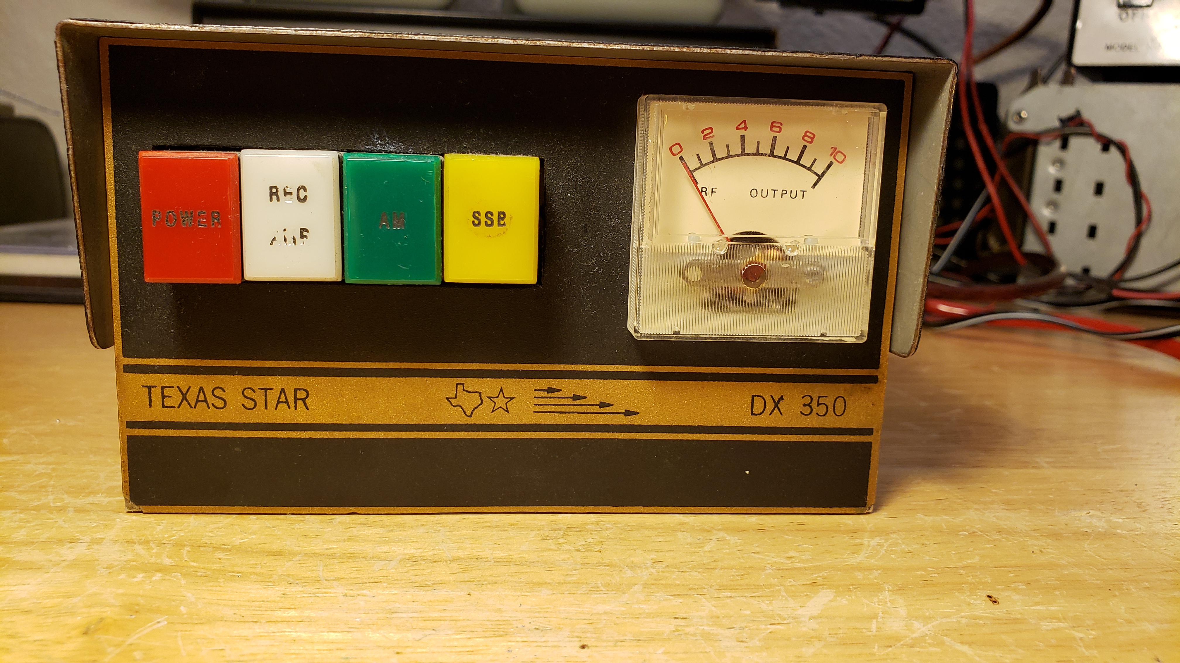

If you are looking for an external amp, I have a Texas Star DX350 sitting here that might be looking for a new home if the price is right. It has Toshiba transistors and is in cosmetically good shape except for the holes that were previously drilled in the lid. I covered them with electrical tape, so at least they blend in a bit.

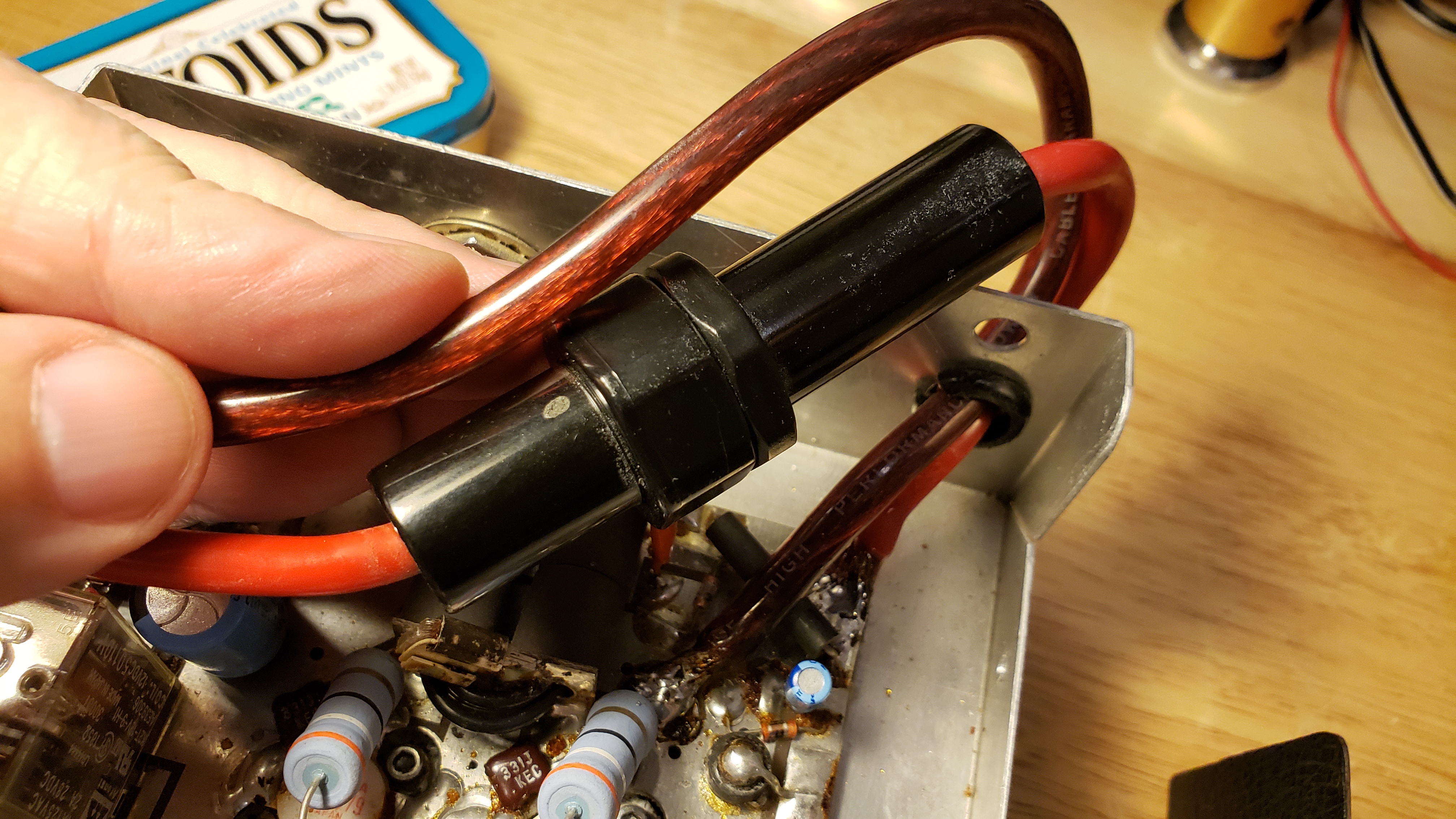

I have also upgraded the power wire to 8ga with a fuse holder.

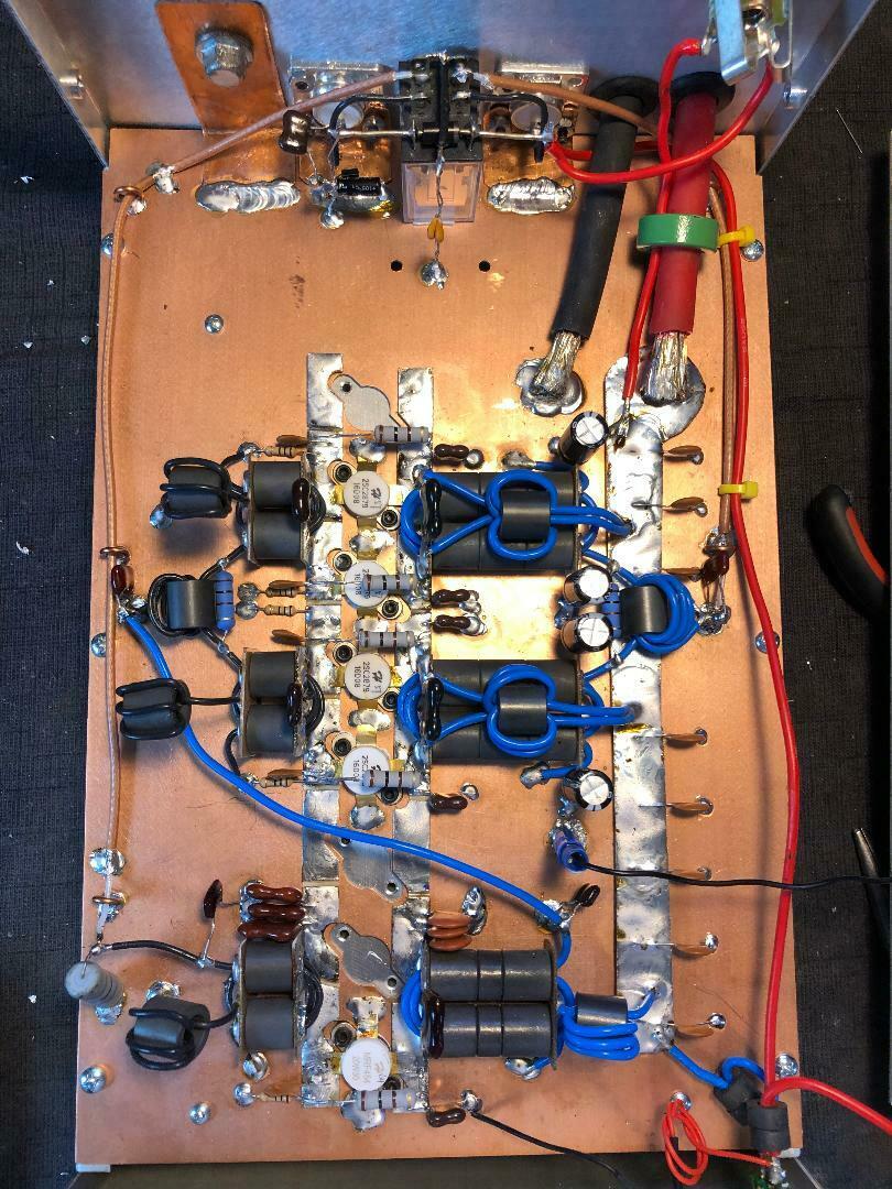

Well, there is a guy in Tampa that is running one of these, pictured.
He gets them from a guy in Oklahoma.
It's a custom unit that is a 1 x 4, puts out about 1Kw which is about average for the big bases here in the South Florida area.
I'm thinking $600 for 1 Kw, new, is a good idea.
I have a RF power control that can dead key from 1 Watt to 35 Watts, this unit can handle a 200 Watt dead key.
The more you feed it, the more it roars.
I would not be looking for it to put out as much as it is capable of, but about 600-700 would let it last a while.
It's a 1 x 454 driving 4 x 2879's.

Doesn't look like too bad of work, but I would still want it to be biased.
