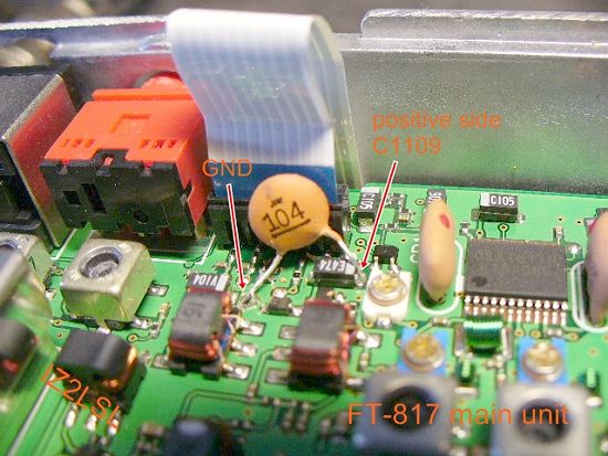

To reduce splatters of TX, 200KHz around carrier, simply add 100nF capacitor.
Thanks to IZ2LSL fro the info.
