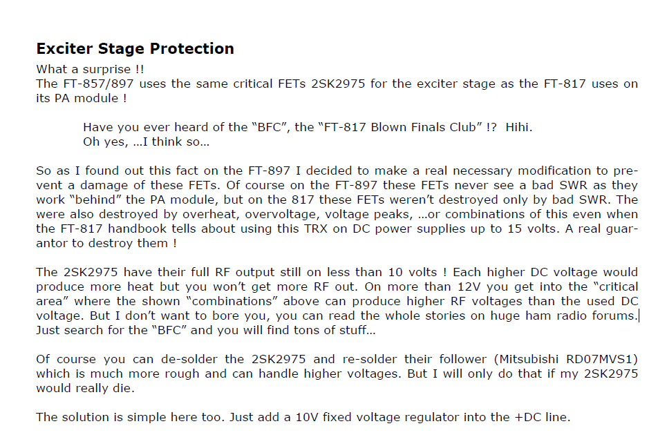

I just read this during some researching so I thought I'd reduce PSU output.

So I should just ignore that article about the 2SK2975's needing just 10vdc?

I owned an 857D and still have a pdf copy if the manual. Yaesu calls for 13.8 volts +-15% to power the radio and a 22A current pull for full power, Why would you run it at 10 volts and expect it to work? I would run it on a solid 30 amp supply at 13.8 volts.
Add a cooling fan if you have to but I think your asking for trouble down the road running the rig at a minimum voltage.

Forget the 10 volt business. The 817 was designed as a qrp rig to run off batteries. The finals may like 10 volts and everything else may work well at 10 volts however the 857 is not designed for qrp and will not tolerate low voltages. I have an 857 and it runs great on 13.8 volts but dies at 11.0 or so.
