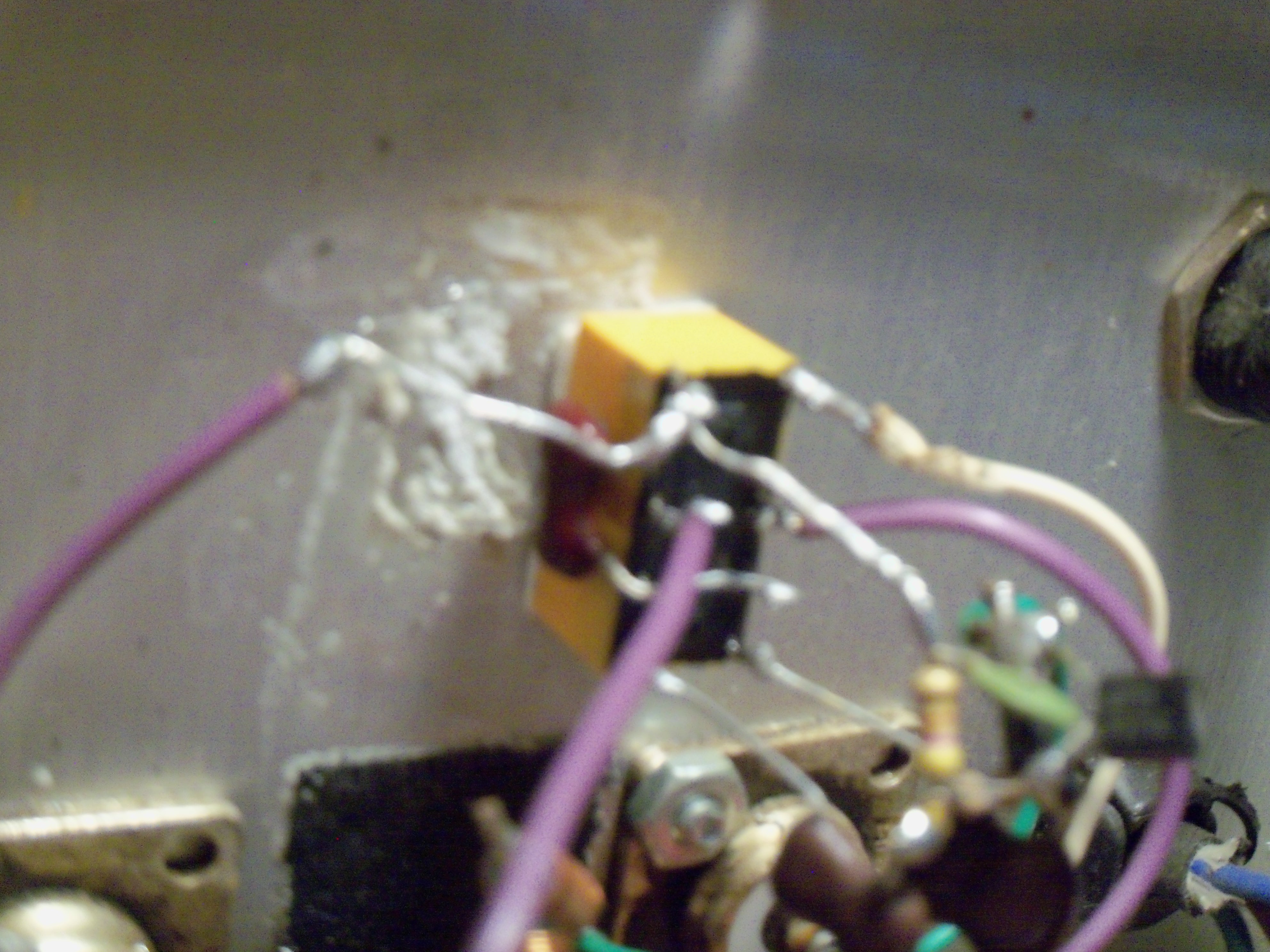

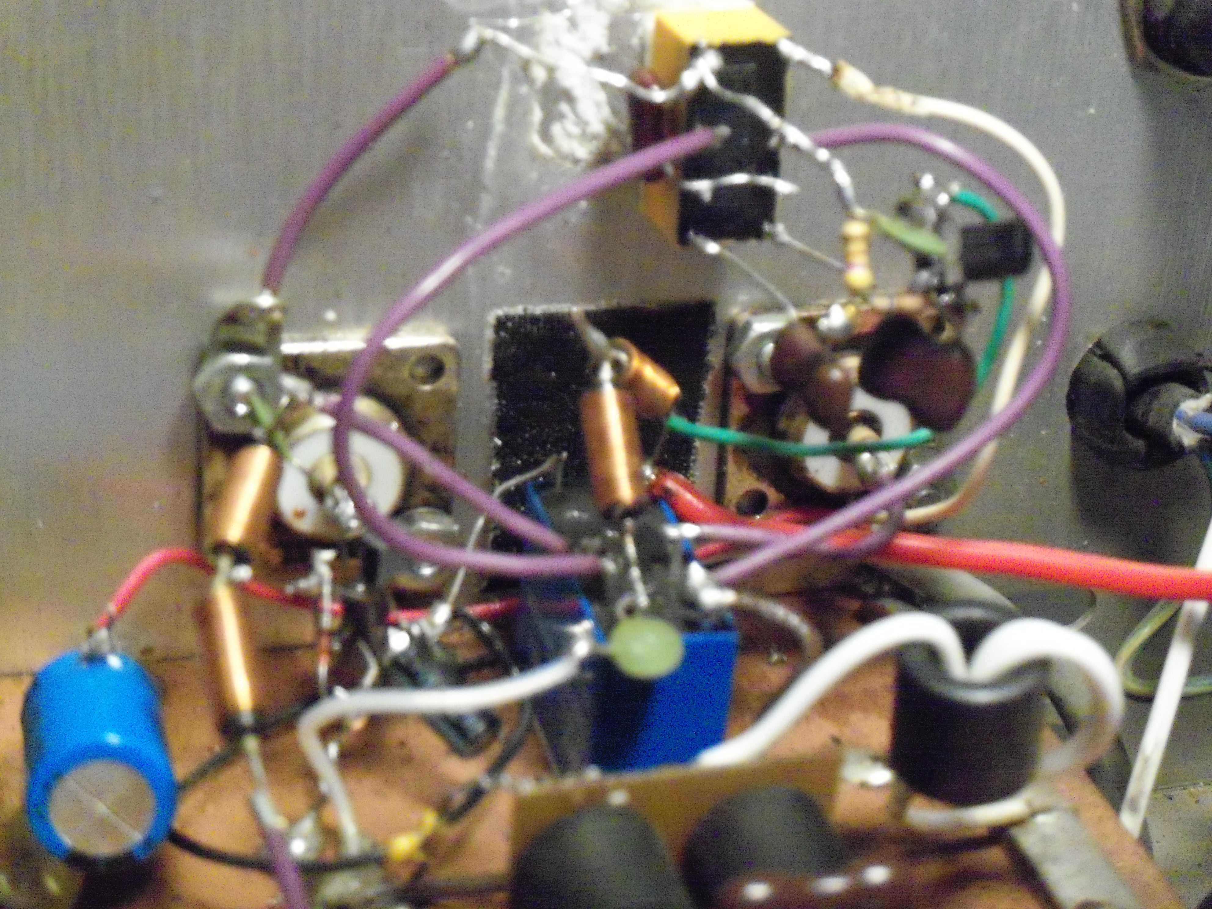

Does anyone know the wiring diagram for a xforce 80 amp? purchased new relays for the amp and made diagram from old relays that were in there.Wired the new relays up the same way and they don't work. So whatever relays that were there were different than the ones I purchased from xforce. I would like to know the wiring for the bottom relays. the choke smokes as soon as you key up. Here is a picture of the relays. 102_0503.JPG 102_0503.JPG 102_0505.JPG
Could be the pin arrangement on relays is different. Yours has class B biasing so bit more complicated. They use similar design in TexasStar amps. You have AC and DC going thru the line.
dc, Its a base amp. has a ac plug in wall but conversion to dc inside amp. I ask xforce and he said he would send me diagram for hook up when I bought the relays from them, but he didn't, been trying to call them but they won't answer the phone. he said I had it wired for nc (normally closed) and should be wired for no(normally open) and had to change wires around, but didn't say what ones to change. I'm not to up on relays, forgot how to do them, been away from working on them for 16 years. have to go back to the books I guess.
What I mean by AC and DC, one of those wires carries your rf signal should have a bypass cap to let rf thru but block DC. On same line/ feed has DC to feed bias circuit. That is why there are chokes. To let DC voltage thru but block rf voltage. It's an old TS trick.
I'm sorry, I should have known that. It's been 16 years since I've worked on these. Where the chokes hook to on the old relays was the front pin. thats where the cap was. hooked to a wire that went to the pot that controlled the wattage on the front of the amp. hooked them up the same way and when keyed the choke began to smoke. So something is hooked up wrong. I'm trying to remember all this again. thanks for the help. Ron
HEY!!!! I finally got the schematic drawing from xforce for the relays. Had 4 wires reversed from old relays. That's probably why he kept blowing the finals. Whoever wired it before had them wired wrong. Thank you for all the help. Ron
