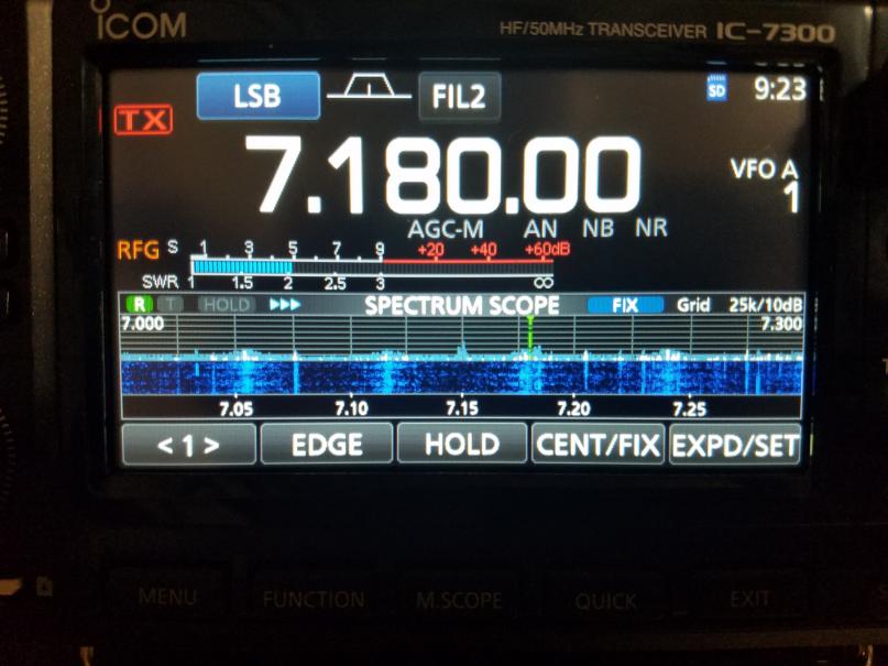

On 40m I have noise at every 60Hz.As you can see in the spectrum scope there is noise at 7.120, 7.180, 7.240, etc.
I'm assuming this is from utility power noise at 60hz.
I'm running the radio on an AGM battery and NOT running it off a power supply. If I disconnect the antenna, I get no noise...so this is coming in from either the antenna or feedline.
Any thoughts/suggestions?

J: The noise is appearing at 60KHz...not 60 cycles(Hz)...The trick to running off battery is having the house electronics shut off...All Breakers turned OFF...then run off battery.
A repetitive noise source like this could be many things...Router/touch lamp/Christmas lights...I have seen this from Electric dryers/ Air purifiers, or anything with a fan and/or small motor....Night and Day is this???... or at some other irregular time interval?

Utility noise is normally constant All across the band and fairly constant level, though can spike in spots when an ark or pulse occurs.
All the Best
Gary
PS: if you remove the antenna connection and noise goes away...it's being picked up by the antenna and/or feedline.

oops, was looking at the wrong side of the decimal point :). Thanks Gary. It does appear to be coming in on the feedline because when I take an AM radio near the coax, I get noise.
