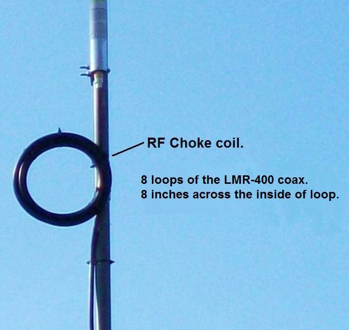

I read a few articles this is really a good one On RFI chokes I thought plus looking at ideas based off it.
www.k3dav.com/rfchokecoil.htm
Here he shows these pics

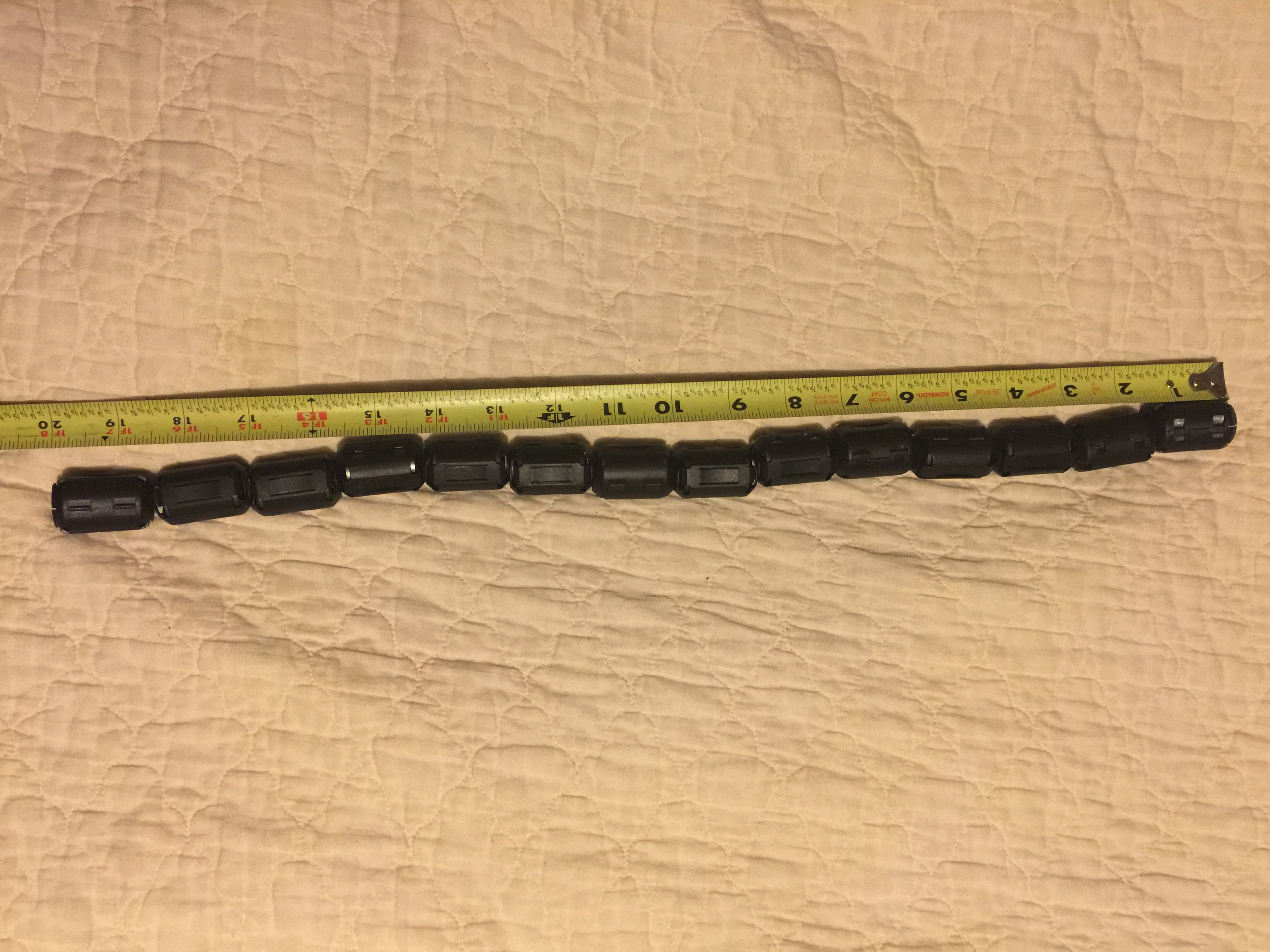

Also found this using type 31 cores and its 12"
Plus thought using @18"-21" of these
On RG 9913 and the 8" 8 turns to be safe on not only RFI coming back down into radio but being heard on other things or interfering or am I over doing it?
Which works best or can both be used

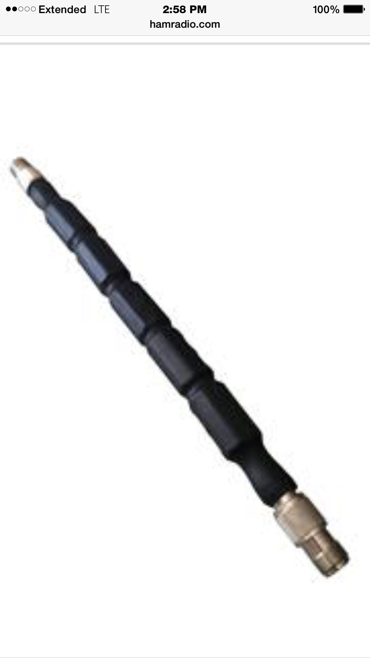

I thought of using Snap ons from PL-259 @18"-21" down to the 8" circle of 8 turns of coax. What do you think of this any other suggestions.

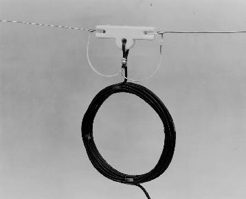

Both designs will work. The version with the ferrite is called a W2DU balun and works very well. For best usage, you'll want to pay attention to the type of ferrite: mix 77 or 31 is what you want for HF; 43 is a good choice for VHF.
31 is good from @1.5 MHz to @300 MHz
My Thing is how many ferrites to use along the 18" to 24" stretch before doing the 8", 8 turns?
Speaking for HF to 6m maybe to 300
Id like to know too for my g5rv jr. Thats about to go up. I was planning on doing the 8 8" wraps right at the feed point to the ladder line.
I was thinking of @8 to 12 of these
Sorta like this
From feed point down maybe 18" to 21", then the 8" 8 turns. And I'm using 9913f7 coax.

yes you can over do it this site may help http://www.karinya.net/g3txq/chokes/ one size does not fit all i would have thought his 8 x8 would be more suited to 20 meters may be its the scatter wind thats the problem
Seen that my thing is this, I have 9913f7 and LMR 400 UF being flexible or not aka 9913 and LMR 400, my thing is what is best as far as air coiled vs coiled around so many in diameter piece of PVC or Air wound( turns and dia needed ) it would take to cover 1-14MHz, 10-30MHz, 10-60MHz, or 1.5-60MHz in general to keep RF comming back in to shack ect as well as RFI period.
