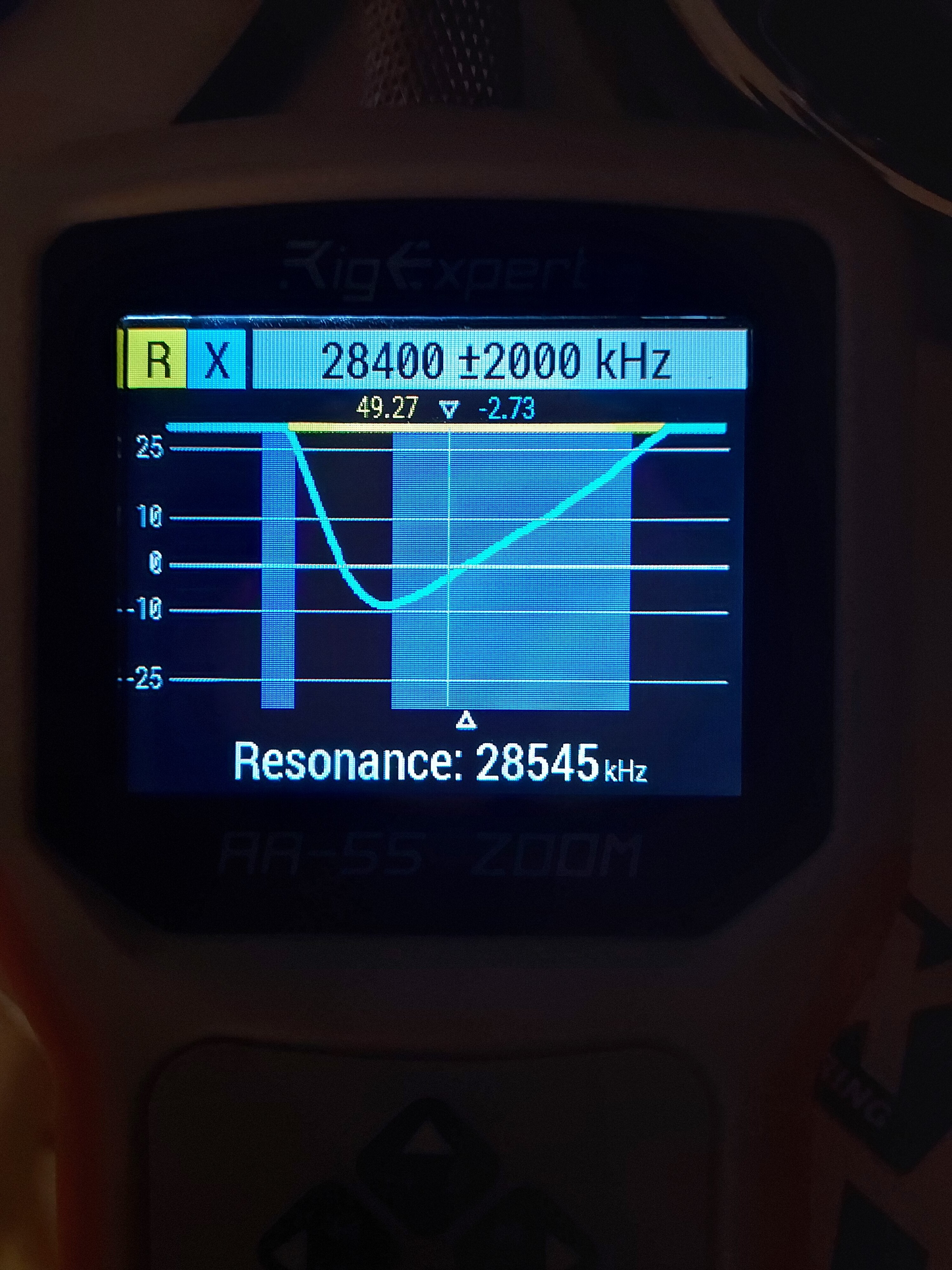

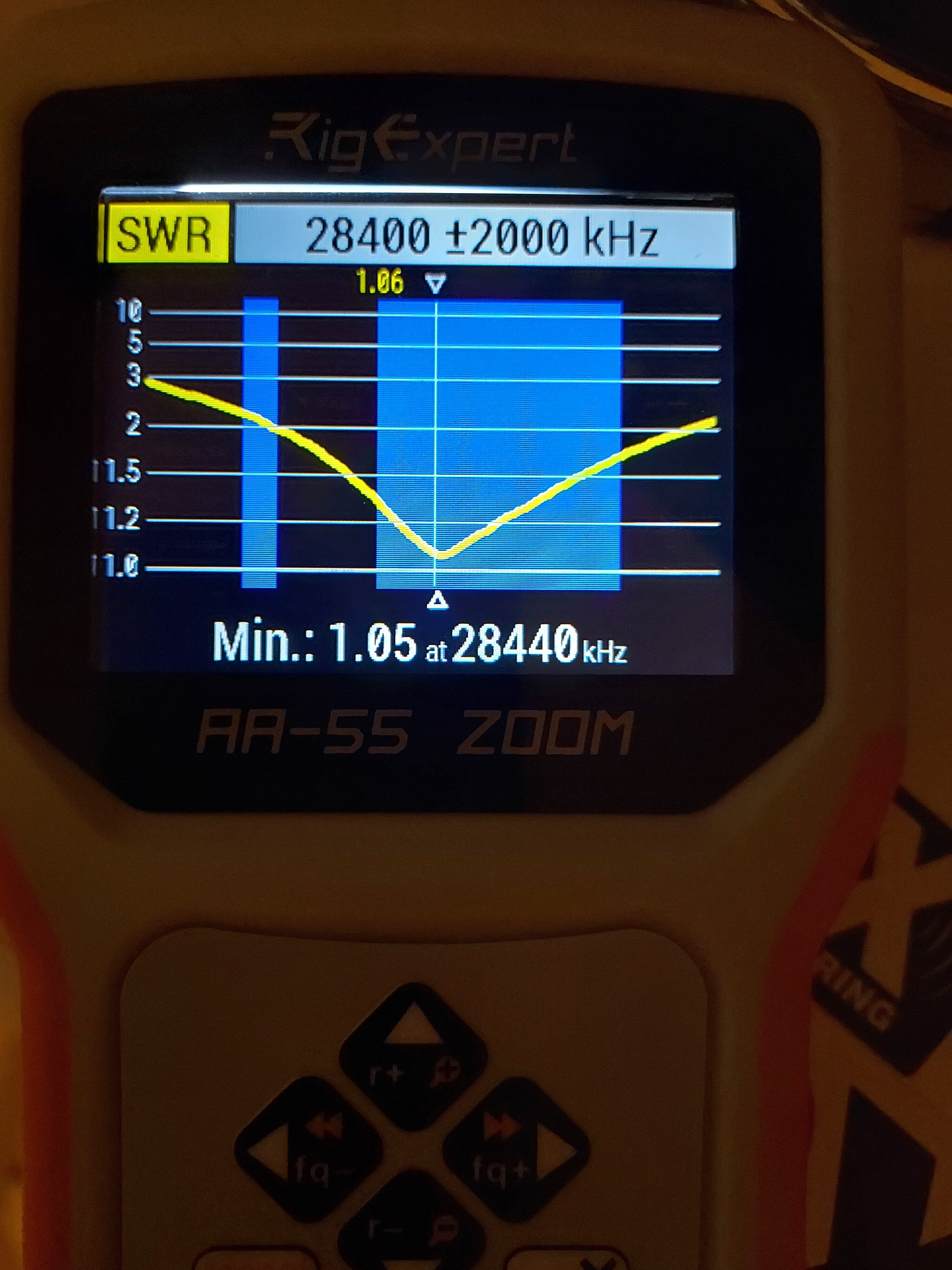

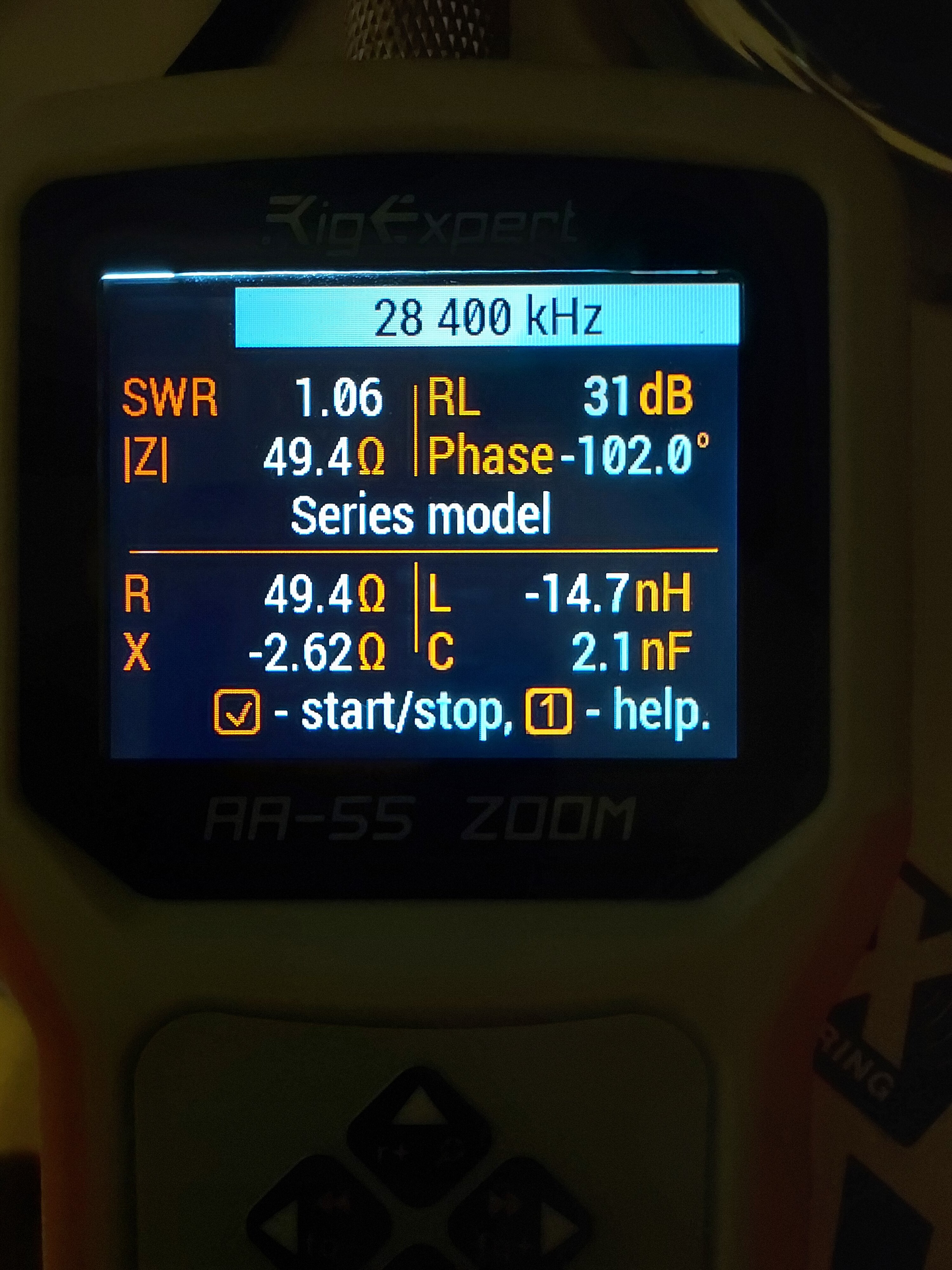

When I setup a new antenna on the truck I try to check at the antenna first. If I can hook the analyzer directly with a barrel(?) connector, good. If not I use a 3 foot jumper.When it's the best I can get it, I then check it at the radio. Has worked fairly well for me.
BTW the 55, besides greater frequency coverage will do a couple of other things the 35 doesn't.
