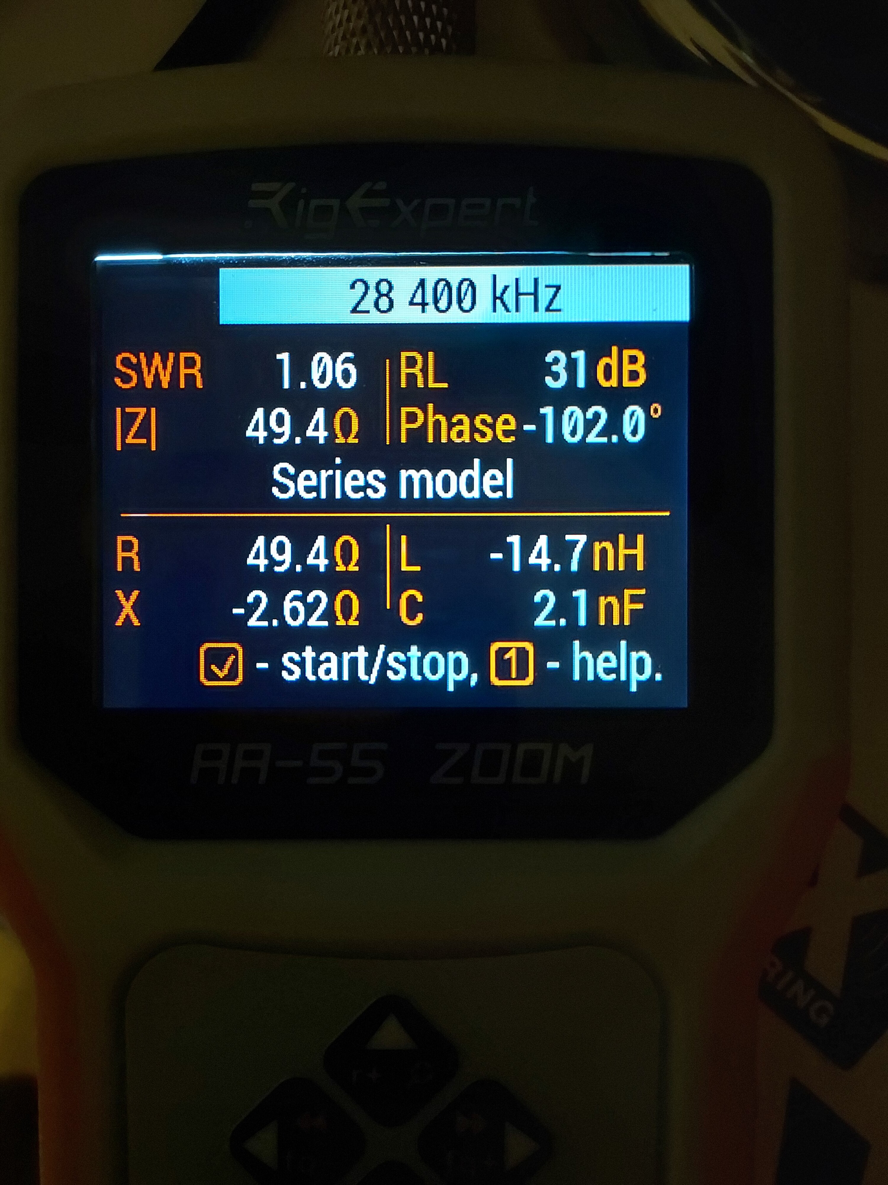

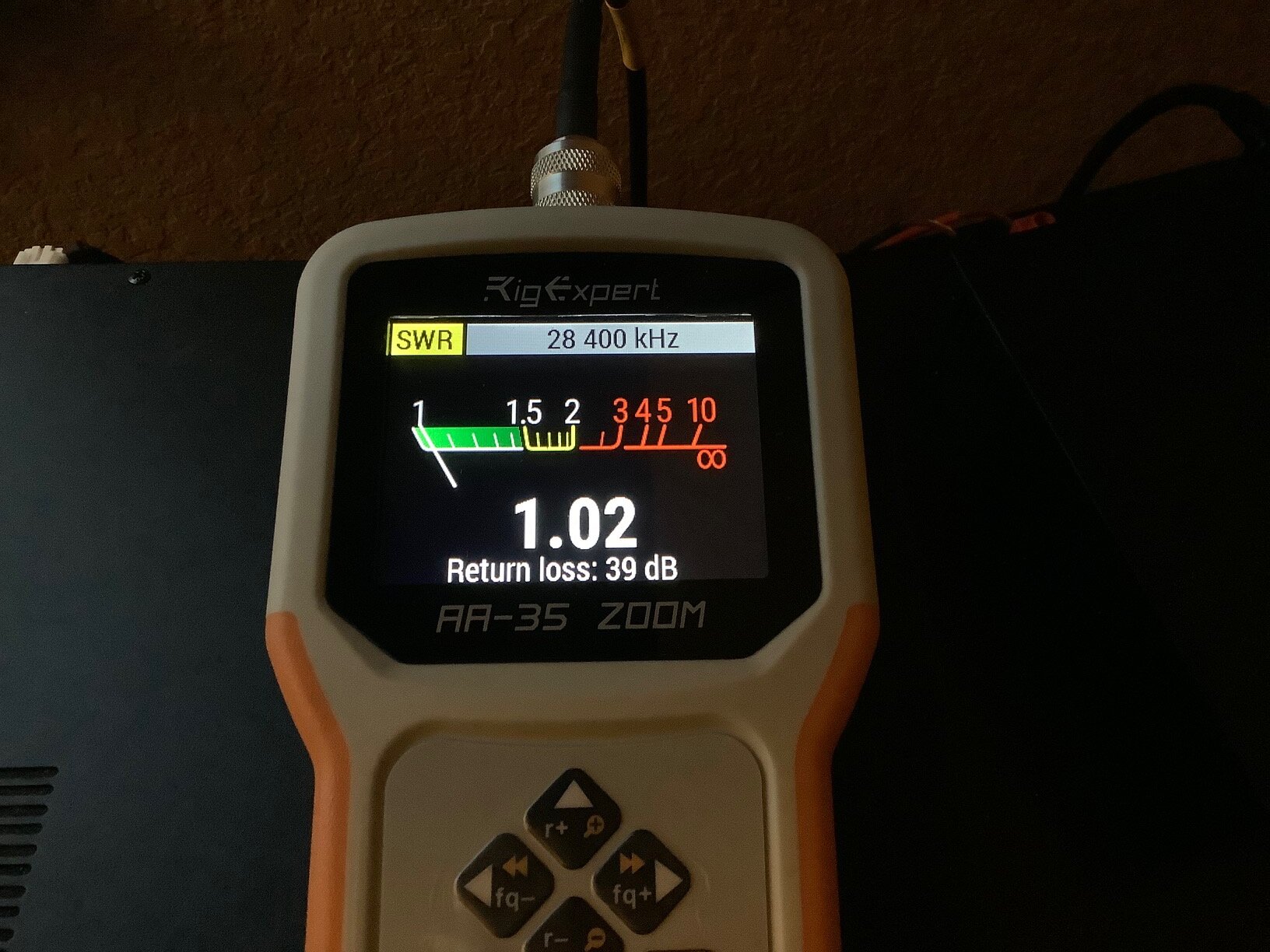

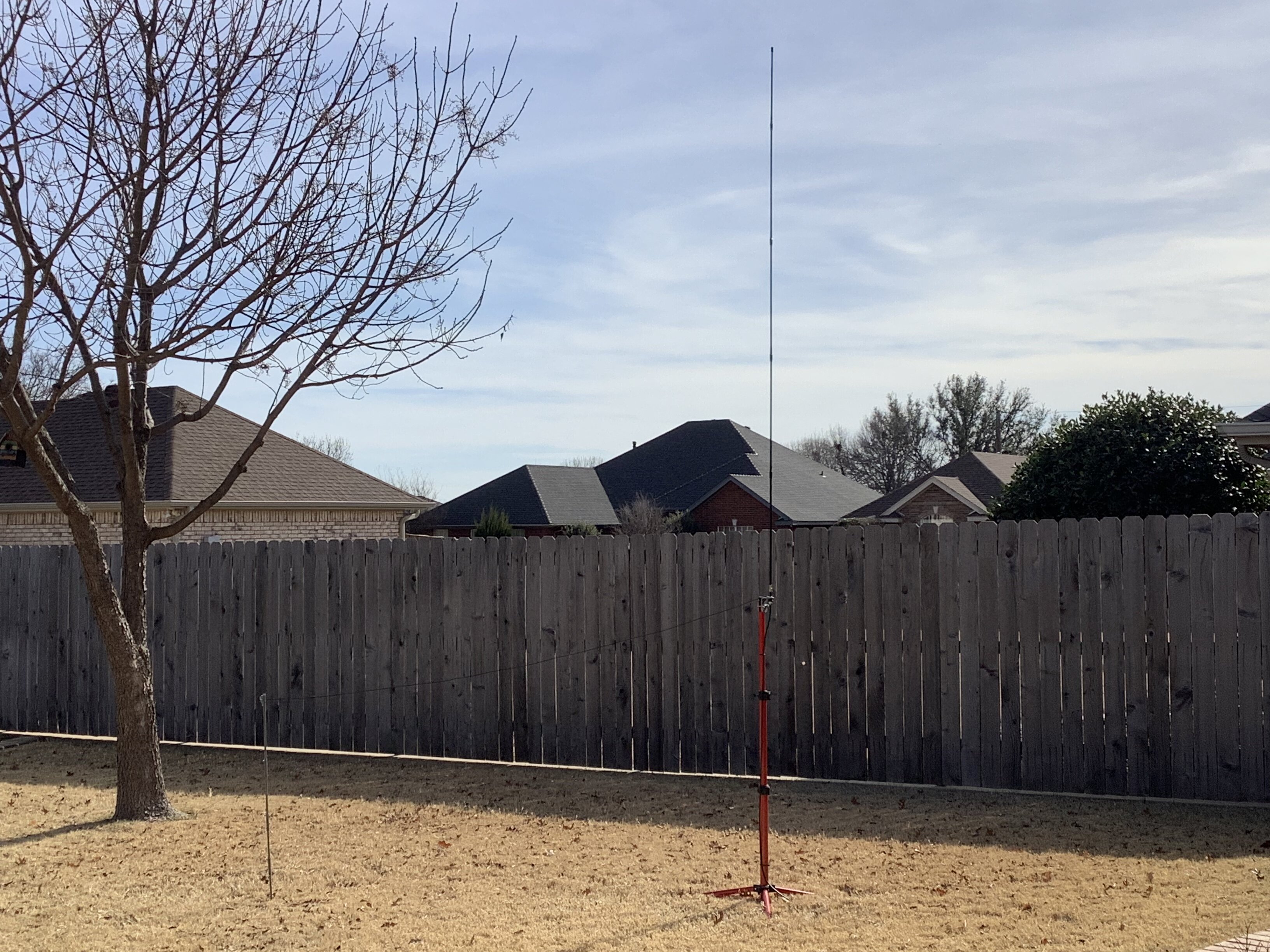

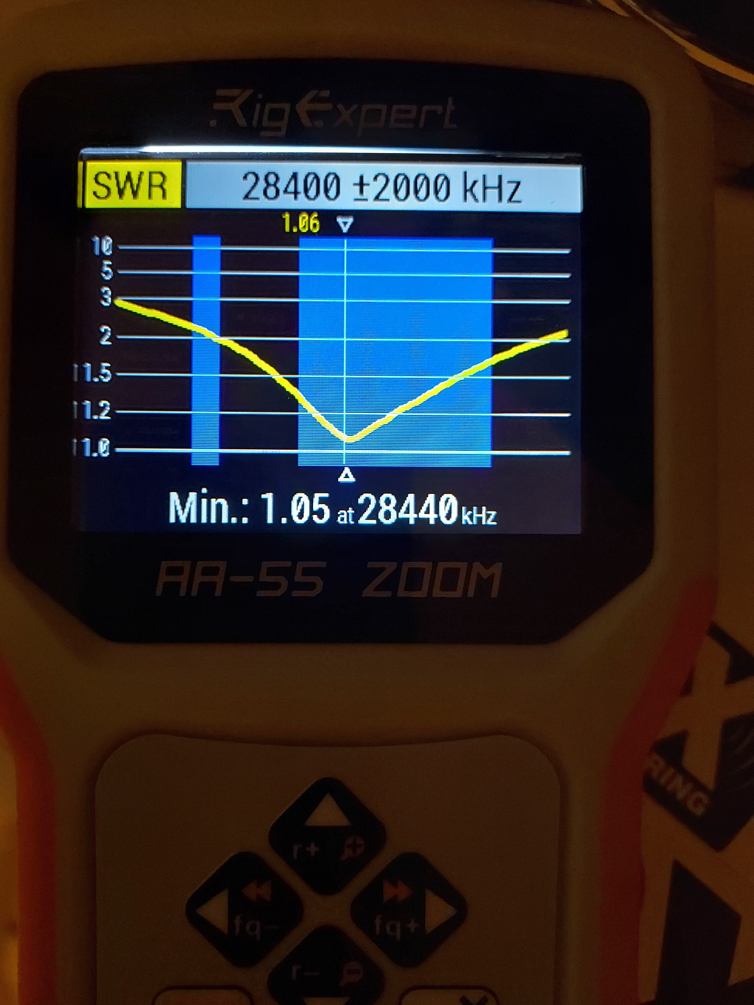

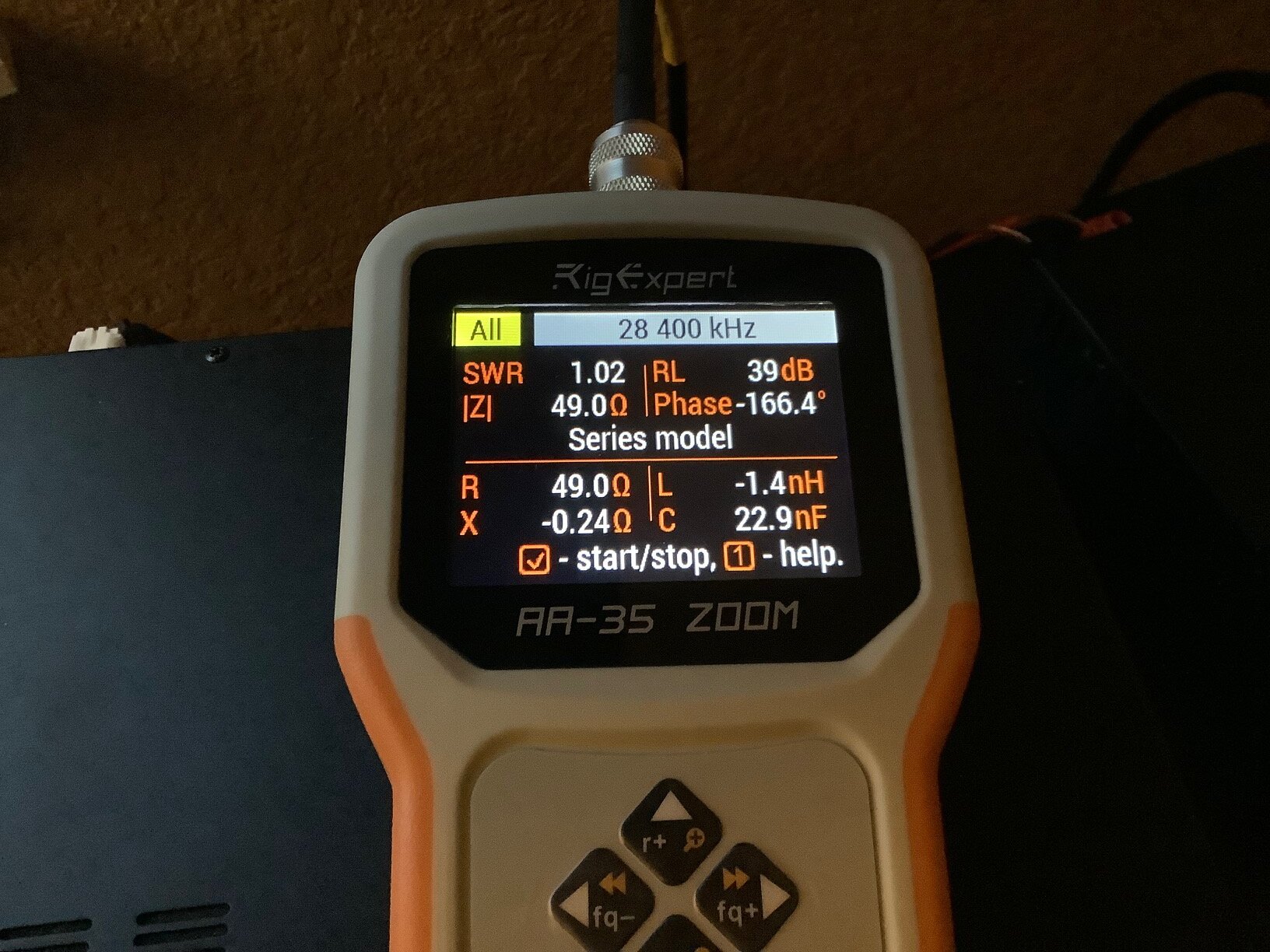

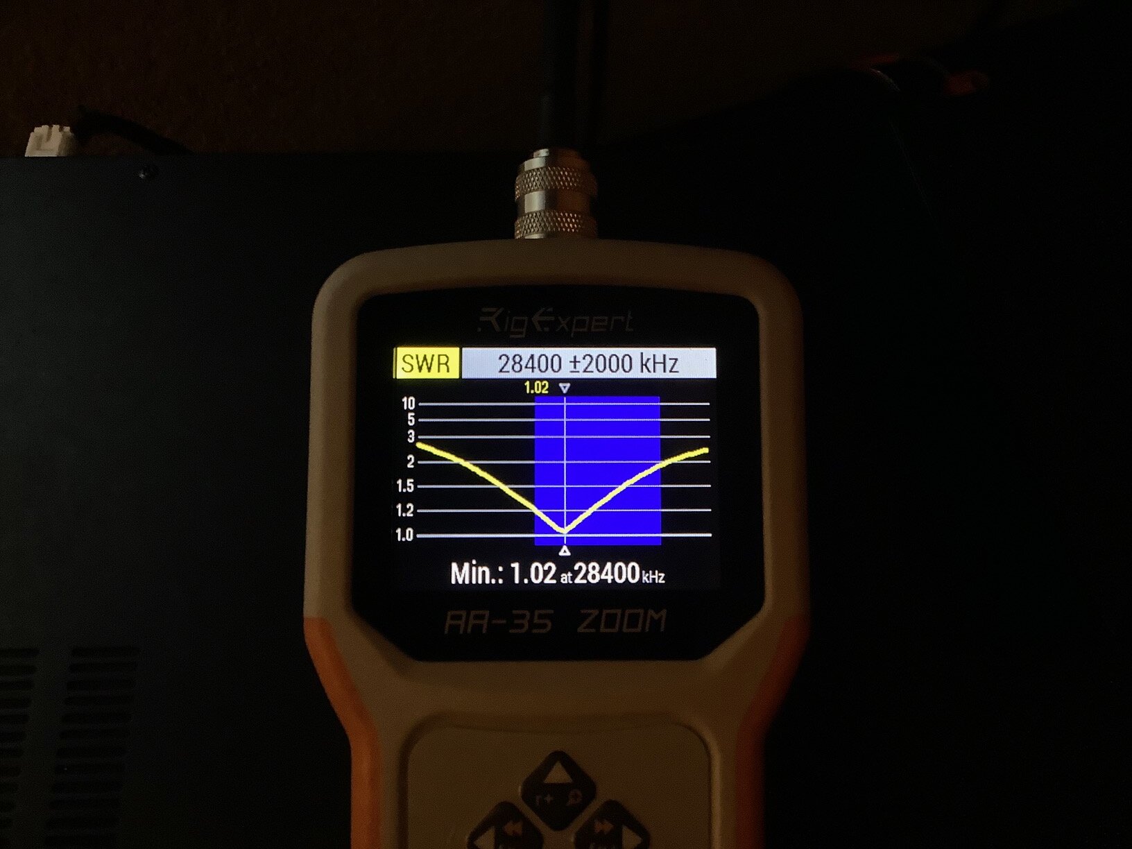

In action on my 10 meter vertical:
That's it. Good analyzer.
