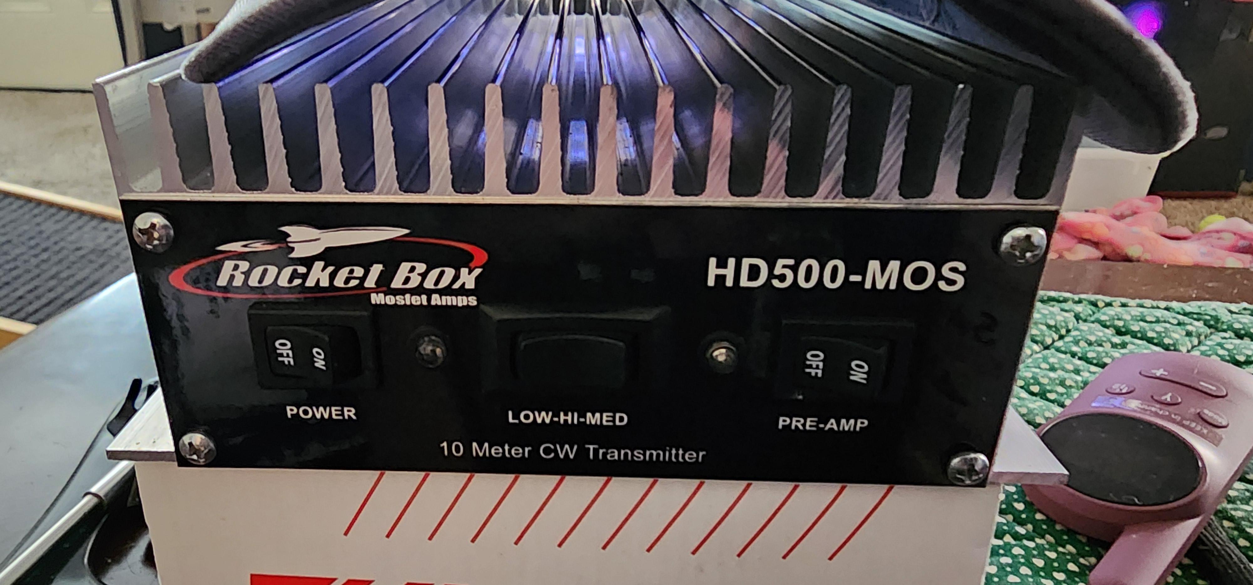

A friend of mine just gave me one of these.
Never used a Mosfet amp before, but I hear they're not as forgiving as a regular transistor amp.
Anyone else tried one of these?

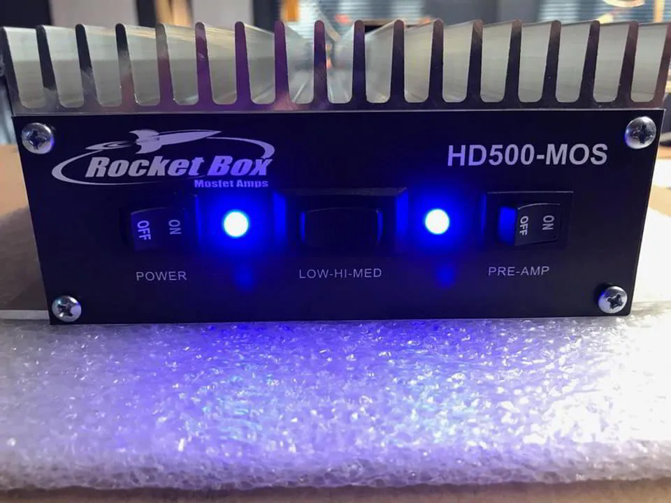

I can’t find any of the others, I must be searching wrong. I did find this link but the 500 is out of stock.
The box seems to play nice with my new Washington. But not so good on AM, because I have to turn down the RF power to get 4-7W input drive, so the radio doesn't have enough PEP to drive it and get full power. About 550 plus on SSB though.
That's the high drive version.
"Dead key 2-4 watts Max. AUTO SSB 400-500 watts
Swing 50 to (80 watts max for output). Remember this unit will output when you transmit. DRAWS 50 AMPS.
SWR NEED TO BE 1.1 NO MORE THAN 1.5"

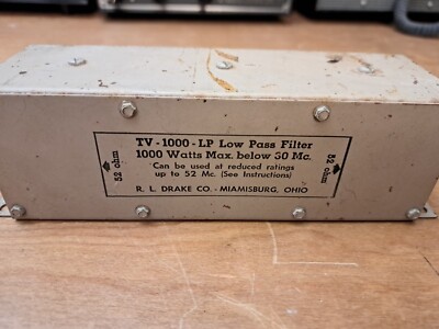

Clean? As in not dusty? Or did you mean sampled to an analyzer and you saw third order harmonics higher than acceptable? None of these off the shelf amps have output filtering. For fixing/testing/building these type of amps I picked up a copper version of one of these:
There's no moving parts. They need some Electro-Wash on the SO239s and they work.
