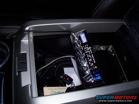

Thanks 359, I appreciate all the help I can get. I'll be sending the amp off for this upgrade as I really don't want to screw anything up. I do have a good start on the install though.
