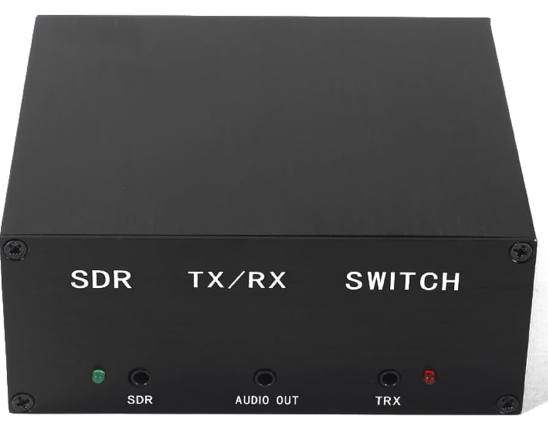

I'm running a SDR setup on RX and using a cheap PTT relay switcher box to TX with an IC-7300. It's so cheap, it's craptacular. TX bleeds through the SDR and it's fixing to eventually fry its input stage. And it starts to go bananas after a while and I have to "reset" it by unplugging it. Anybody got suggestions on something that has proper shielding and doesn't cost 500 bucks? Preamp would be nice but not necessary.
Obviously it has to work in the HF range, 100 Watts minimum.
The junk I got:

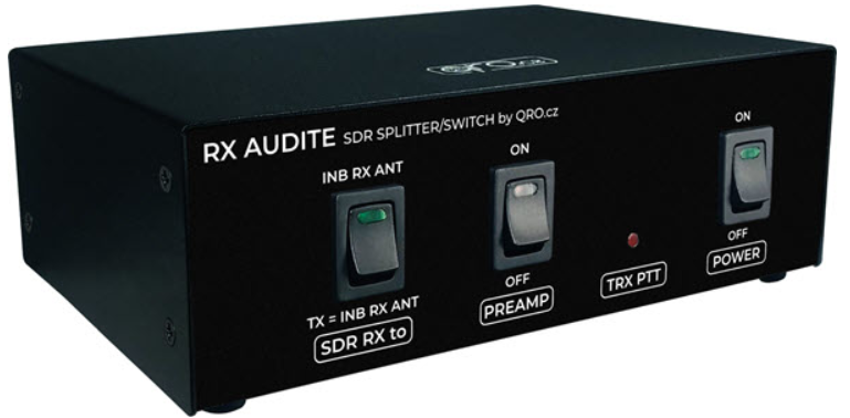

Interesting but expensive. There's also a no-preamp version. Still no idea on quality but some say it has as much as 100 dB isolation.
1776732969046.pnghttps://www.dxengineering.com/parts/qro-rx-auditepre

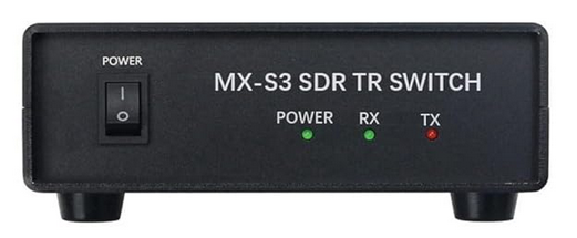

I run both the MX-S3 and the earlier version (MX-S1) in my shack. The IC-7200/R-75 pair sitting next to me has an S1 attached.
Key differences:
S1 allowed for switching the transceiver audio (when off or in TX) on the SDR audio (when on, in RX). S3 has several PTT line connections - two of which go to ground on transmit, one more is selectable (N/O or N/C) on TX.
I use an S1 with my Ten Tec transceiver/receiver combos. An Omni V/VI or Paragon II is run in conjunction with an RX-320D and the receiver's audio output is run to the S1's RX Audio connection. The S1 audio output - along with that of the transceiver - goes to an audio control console; its main function here is simply to mute the audio when the transceiver is transmitting.
S3 is used with IC-718/R-75 combos. I run two receivers with one transceiver and employ a power divider to share the RX Ant output from the S3. Remember the multiple PTT connections? These are used to mute the R-75s when the 718 goes into transmit.
In both cases I attach a Receiver Protector to the RX Ant output of the switch - even though that connector is effectively relay-shorted to ground on TX.
Both have worked well for me. I'll be happy to answer any questions about them.
Key differences:

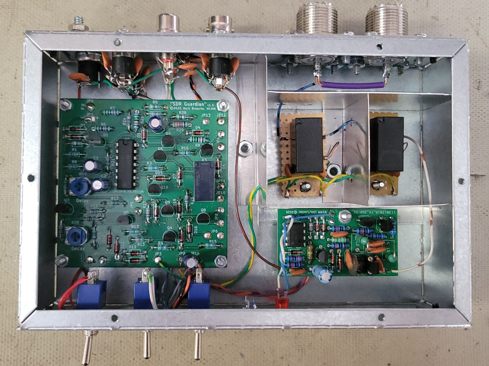

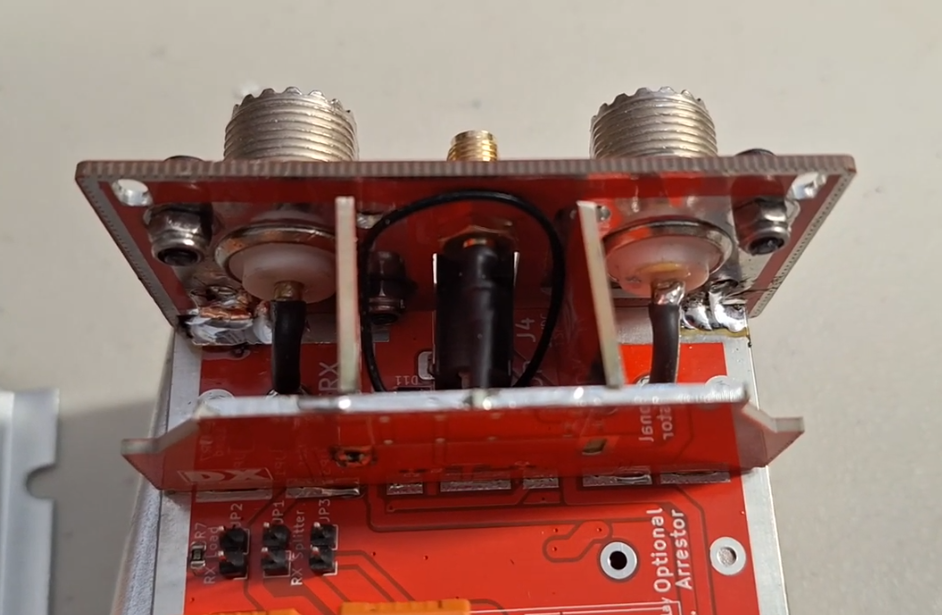

Thanks for the info! I've had my eye on the MX-S3 but I've never seen any pics of its innards. I'd expect at least some minimal distanciation and or shielding between antenna traces and ports, like in VE2DX's unit:
Not sure I would, to be honest.
That sequential triggering on the guardian whereas the bypass occurs a split second before the TX path is open sounds awesome. And when you let go the key, TX is cut before the bypass is disabled. It seems to me that it should protect the SDR for real. Also I noticed that the relay and RF bits are physically isolated in their own shielded compartments. There also seems to be an LNA in there, presumably for some extra gain for simultaneous receive on the SDR and transceiver. Might even act as an extra layer of protection. Looks superior to everything I've found so far on the net.
I went ahead and ordered it. Will report back once I've tested it.
In the youtube vid he demos his prototype at the 7 minute mark.
I'm not sure what benefits you'd gain from this particular design, unless your transceiver incorporates TX En/TX Out control lines (like certain Ten Tecs did). The key line of a QSK amp (e.g., 420 Hercules) was connected in series with the TX Out port and another line ran back from the amp to the TX En port on the transceiver. This gave the amp adequate time to sequence before the transmitter was commanded hot.
If all you're using is a standard mic with your rig and there isn't a way to insert the SDR switch into the transmitter key line, you lose this utility. The time delay actually becomes counterproductive, as you want the receiver antenna connection to immediately drop when the key line goes active.
Speaking of: The correct way to do this is a solid (always-on; hard wired) connection from transmitter to antenna, with the SDR's antenna connection facilitated via relay. It's disconnected when the device is off, connected only when the switch is powered and in RX mode and disconnected (preferably shunted to ground) when the TX goes active.
Be highly suspect of any such device which puts a relay of any sort in the TX path itself. Things do fail open or burn out.
I'm not sure what the CW In/Out function is going to buy one when utilizing full break-in, either, if there's an appreciable differential between the rig's T/R timing and that of the SDR switch. I can see a delay being introduced for the secondary receiver coming back to full sensitivity. Not an issue if you're using the transceiver's RX and filter sections to copy transmissions. It WILL be a problem when using the SDR for same, particularly during QRQ operation.
