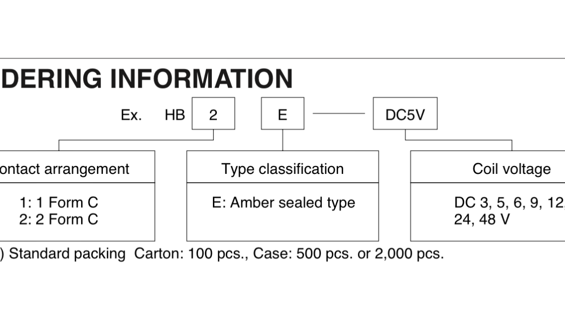

upon closer looking i see where the contact is burnt off reply. any ideas where we can get a relay for a silver eagle 200? its very small
Does the relay by chance have a part number on it?
I worked on one for a friend 20 some years ago, and if I remember correctly it was a little tiny pcb mounted relay.
Is that what you’re working with?
Reactions: NEONNIGHT34609
I have the small reed type relay used in RMItaly linears. The relays are at the bottom of the circuit board. One white and the other is black.
