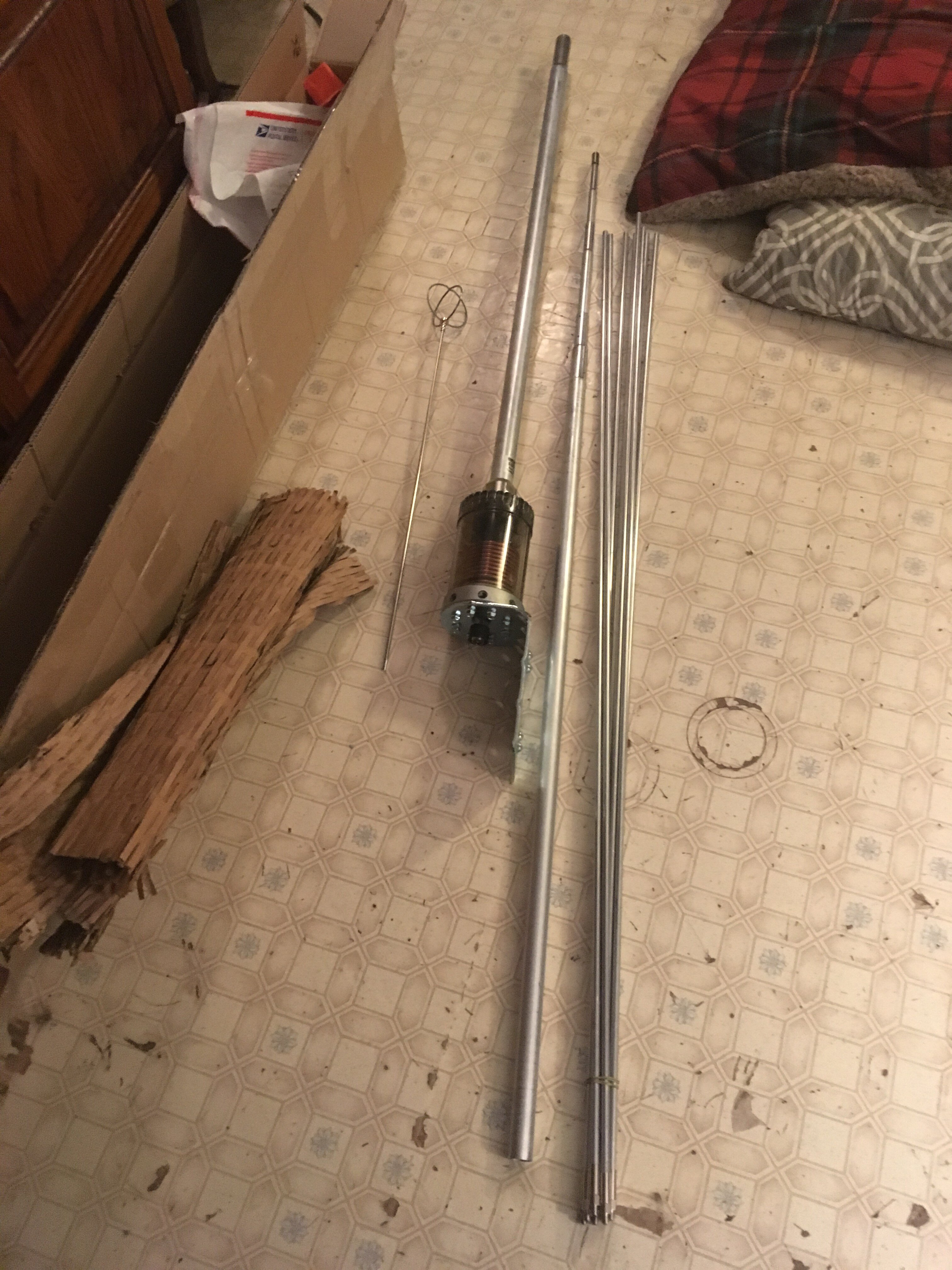

i got it mounted to the steel fence post i use to set antennas and use a few days before they go up high.
my first impression was DANG ITS BIG.
was easy to assemble. i did some thinking and marked the top stinger to the lenght of each band. ive got it set on the 10 meter measurement. first try was just a tad high,lowered it half inch.it set on 1.1 to 1 across the band.above and below 10 meters it was decent vswrs.
i did notice couple things im concerned with. the 2 little screws in each section in the plastic housing and how stout is the coil?
if the screws work loose im cutting a slit and using hose clamps at every joint like the first joint is coupled.
another thing to ease assembly use majic marker make a line where all screw holes are in each mast section. so far i got a few contacs and am happy.

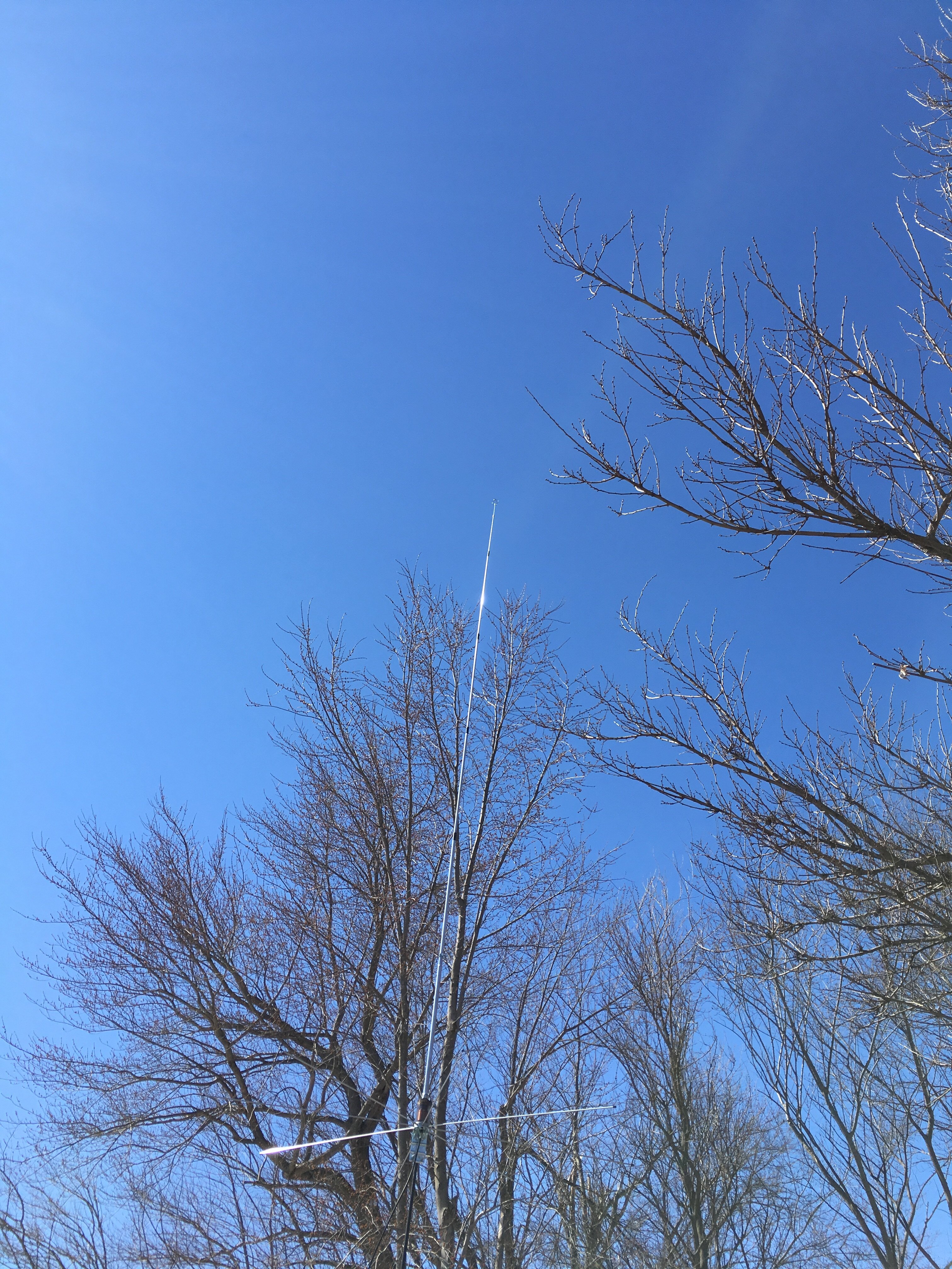

NICE!! How tall is your antenna to the feedpoint? What state are you located in? - 553 around the Alamo

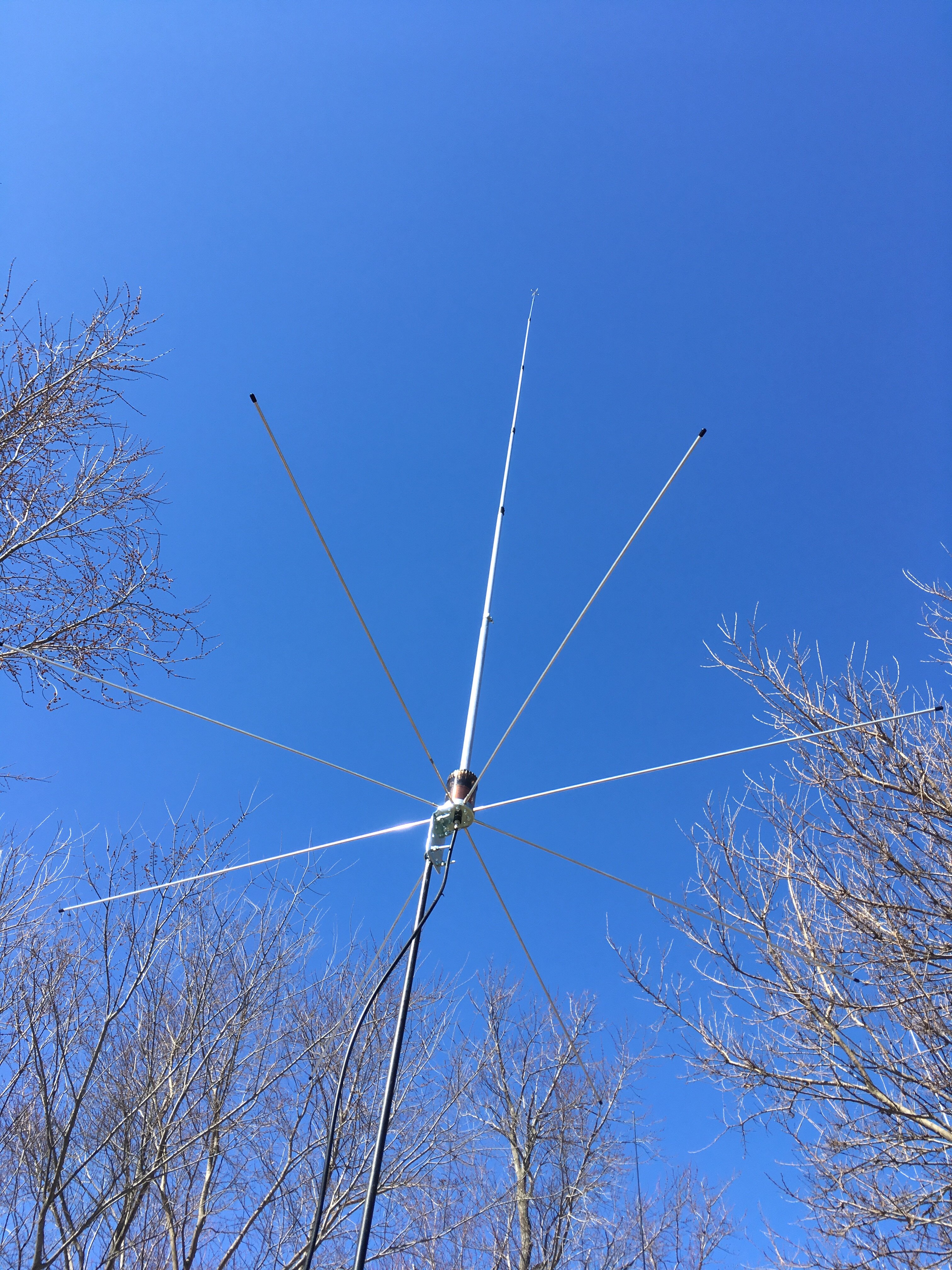

Once i has swr set as i wanted we had a decent wind storm and it loosened the allen stud that sets the stinger/swr length. I went back and slightly counter bored the stinger and loctited the allen into the stinger at correct swr location.
No more sliding down.
It was a pain in the butt to have to take down a few times to readjust due to the sliding down but since i did the small modification its been perfect!
My vector 4000 has the same egg beater top. My set screw fell out one day. This was completely surprising, because I had accidentally overtightened it when I first installed it and stripped the hex out of the end so I could not get it out to make adjustments. After about a year and a half, a buzzard landed on the egg beater and bent the stinger. Not a big deal, but then I noticed that it was twirling and swinging with the wind like a weather vane. I put a stainless metric bolt in it, should have done it when I first installed it.

its only 10 ft up but will be up lot higher.
yes ray wylie hubbard. im in southwest missouri

Congratulations, I have one of those still sitting in the box waiting for Summer and warmer temp's to show up,normally I install antennas on top of my roof by myself,but looking at the picture, I have a feeling that I need to reach out to my neighbors and ask for help getting this one up!! Looks Great...........
tis lengthy a hand full for sure
