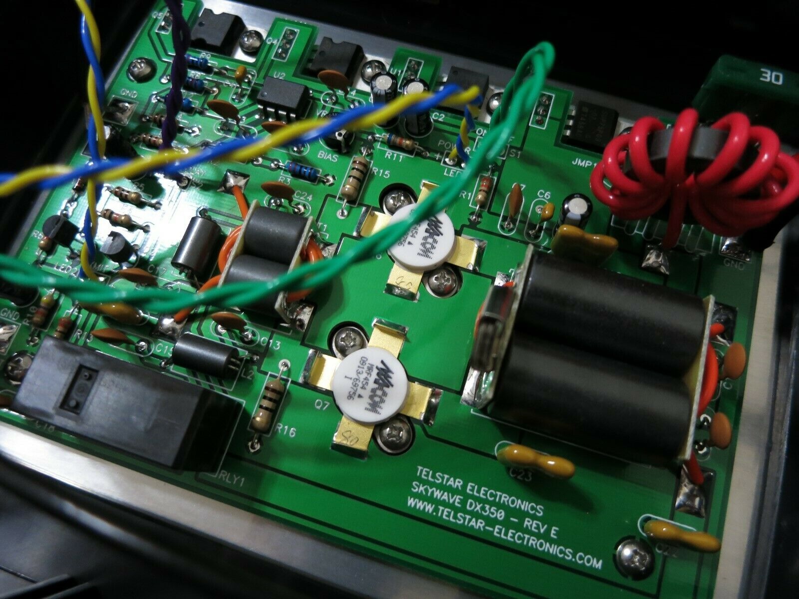

Seems to me Brian used a trick in his Skywave boards that was also seen in the "LA" 800 and 900 amplifiers. He feeds the DC power to the RF transistors though a common-mode choke made from ferrite cores straight to the output-transistor collectors, and not into the far end center tap of the ferrite RF-output transformer. It's a trick Helge Granberg shows in his book from 1993. This way only the RF current flows in the output transformer, rather than the RF and DC supply to the collectors, both.
This increases the RF power level that saturates the core of the RF-output transformer. This is how the "LA" boxes would show 200 Watt peaks per each 2879 with only a 14-Volt supply.

The DX350

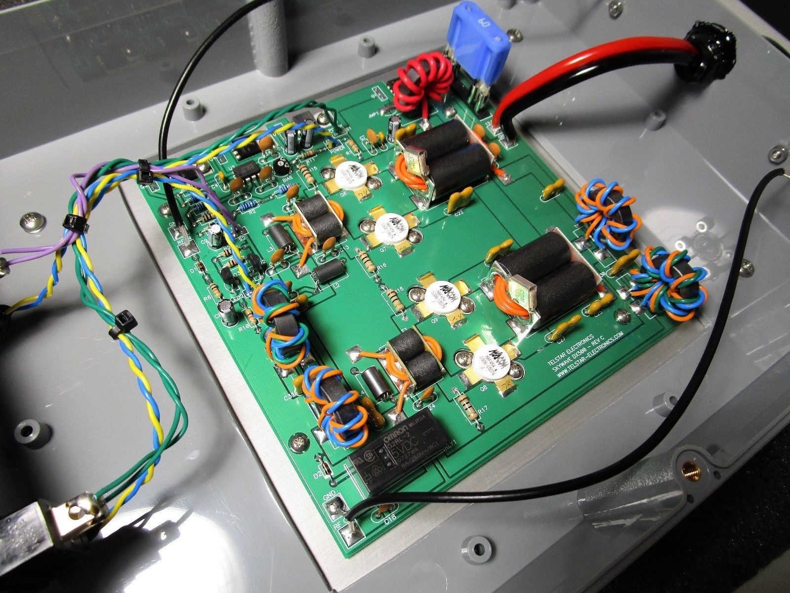

The DX500

The DX350
The DX500

That looks like 14Ga wire on that "DX500" to me. Just a TAD small, dontcha think?
