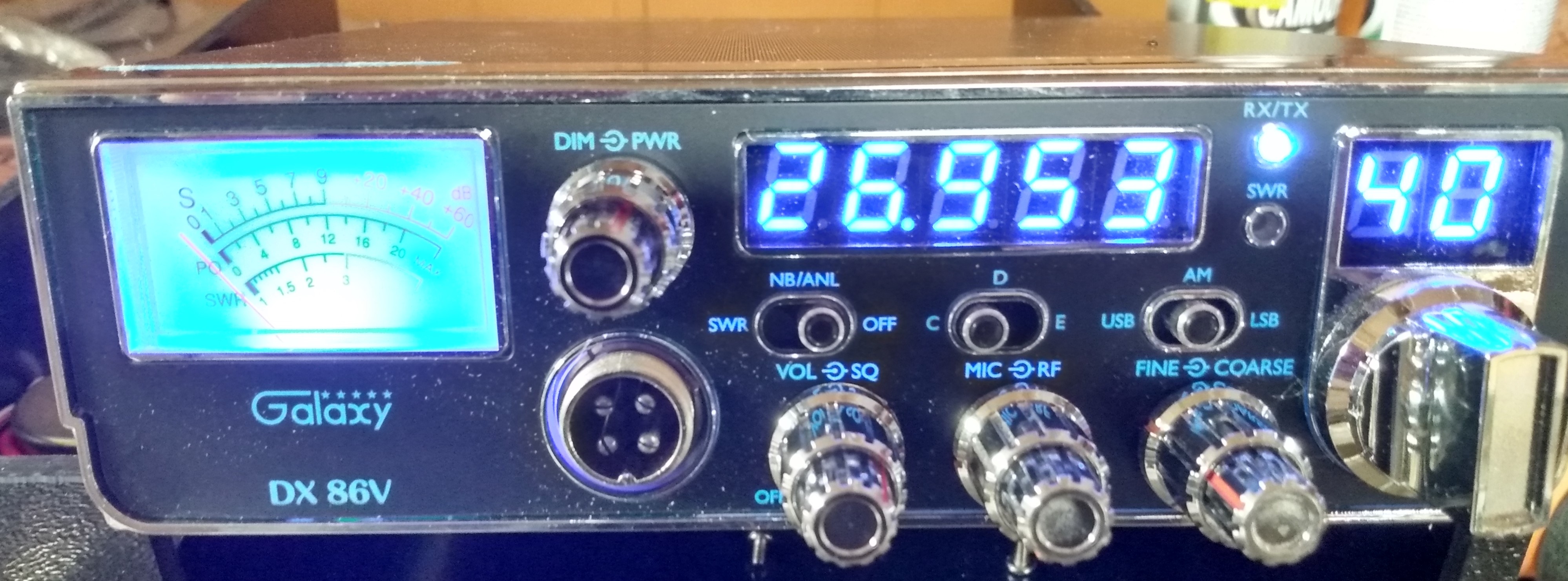

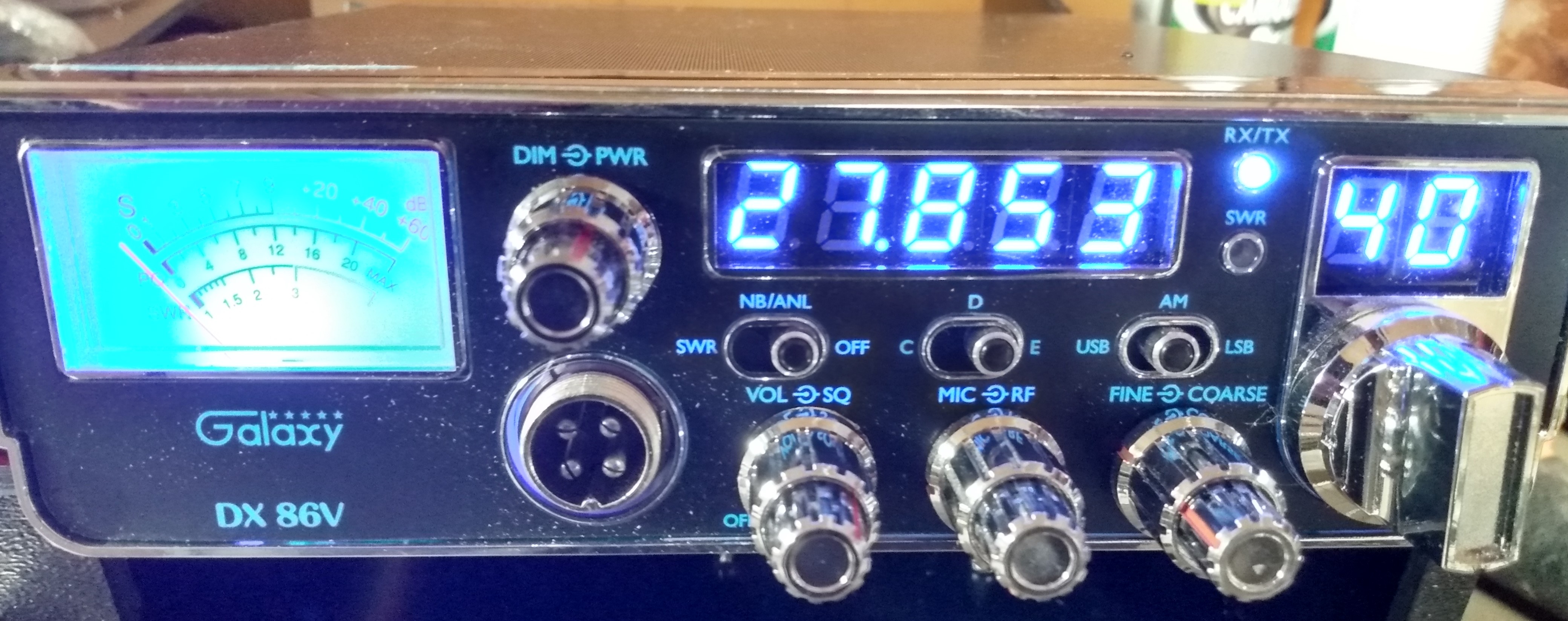

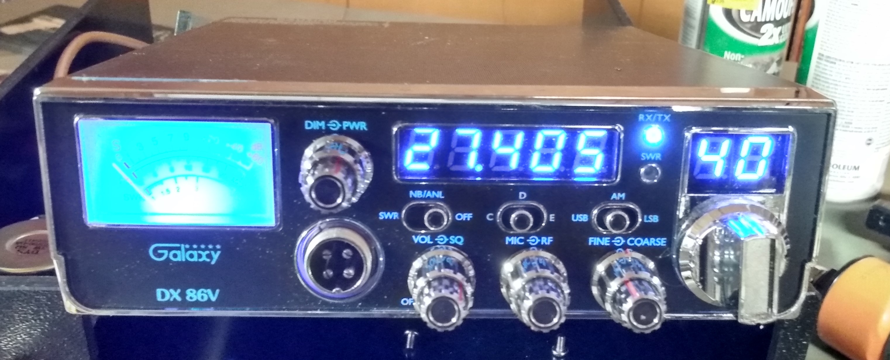

I picked up a Galaxy DX86v, to dip my toes into 10m. this one was supposedly "tuned", but i think it has been modded
Channel 40 in the band switches are as follows:
C=26.953
D=27.403
E=27.853
my radio knowledge is woefully limited to Chinesium SDR's, and i am at a loss as far as how to get this back over to the 28.4 i need it to be
any tips?

Welcome! I have some information in another thread about this, let me see if I can find it.
Edit: Found it. The conversion process is on page 2. Looks like yours has already been converted to 11m. Simple solder job to pick other banks of channels.
Reactions: G-Golly Wally
I reverse-engineered the modifications in the video, unplugging the 3rd Molex pulg, and resoldering the blob, but it still didn't get me back into 10m. but i'm gonna dig deeper into that thread.
