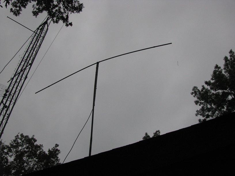

I think everyone has their idea of "minimal" cost. I live in a heavily wooded area with no room to swing a beam, my options(without trimming trees and increasing cost are to go higher, or go longer. I have a mutiband antenna which is much longer, that would be at vitually the same height, with slightly better RX, TX is comparable.
I went the high dollar route in the 11M days, so I'm well aware what is capable in this frequency range.
10X the DX would not happen in this location even after spending 10X the dollars.
If I want to play on big $ radios, I can go down the road and play with a locals antenna farm with multi element beams on 100' towers, hooked to all the contest rigs and all the Ameritron power you can shove in the shack.
Or I can just wait patiently with my crappy little dipole and "get lucky" by being patient.
Was last night a fluke? You never know, but it worked on 2 completely different stations, and about 40 other countries in the last couple months a few minutes at a time, so I guess it's a start. Either that or I'm just that darn lucky ;)

I am not even talking yagis. Get the same antenna up a lot higher than 15 feet and see the difference. You say you have trees? Use them to your advantage. String that dipole up in the tree tops. It does not have to be in the wide open spaces. The only extra cost is a few feet of coax and some rope. That is indeed minimal cost in anyone's book.
Height makes some difference, but not a tremendous amount given the fact I'm tucked at the foothills of the blue ridge mountains, My Imax is tuned for 10m with the base at about 85', I have a pulley system where I can drop that down and simply suspend this in the middle, from the tests I have done at least, not enough trouble to flip the location on the 2 antennas, unfortunately I'm in a bit of a hole and surrounded to my immediate west by mtns with 2200' change in elevation. I have antennas and pulleys strung all over this place for a variety of setups, but this is what I ended up with as I have a duplicate that clips to the side of the camper when I don't bring the Imax.
I think next will be to build a duplicate for 6m and see how it does. For the price, I'm not exactly out much.Or anything in this case.
