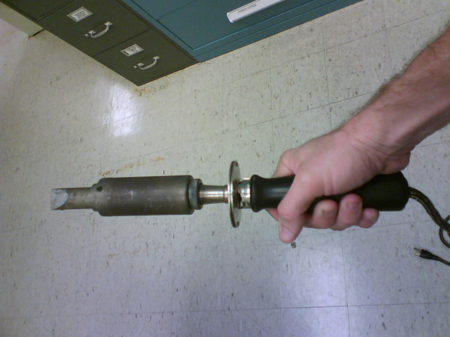

I appreciate the info, but unless someone states otherwise, Ill probably get the Hakko 888. I have never had any success with a gun. I thought soldering heavy stuff was hocus pokus until I got an old craftsman 200 watt iron. Now I can solder 6ga wire to .25" plate if needed. My problem is tip life with pencil irons. One use and I'm going to town with a file because the tip eats itself away. Maybe a good station will make a tip last, or maybe I just destroy things, I don't know.
