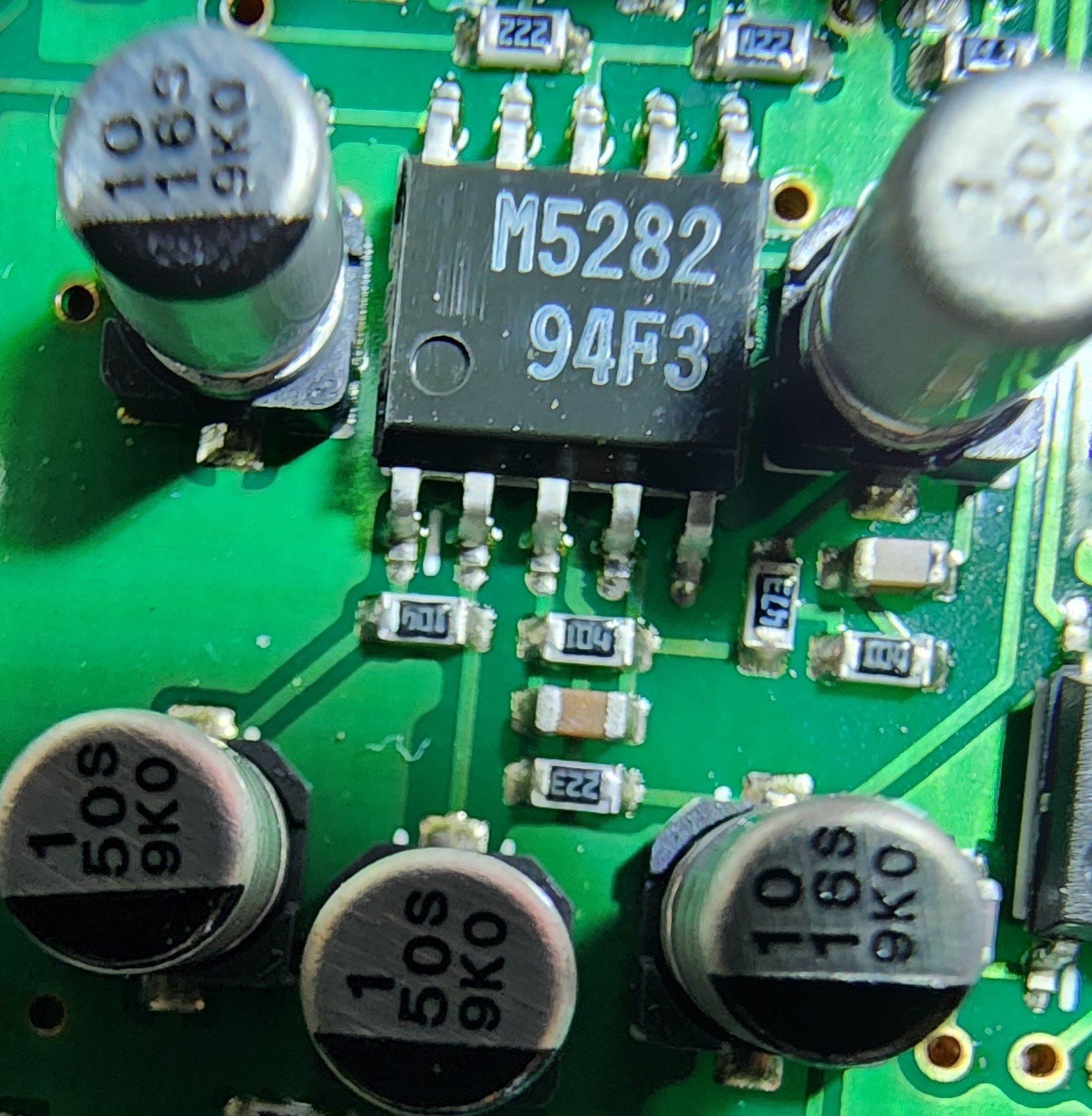

I'm trying to do a mod to my ICOM 746, a small tight spot needs to parallel a 4.7k resistor to R1087. What temp setting would be a starting point to avoid damage

you're going to end up moving that surface mount resistor i can almost guarantee you, so you'd be better off removing it and just putting the equivalent value part in it's place.
it looks like the chip resistor is a 1K, and if it is then the equivalent resistance to those two values in parallel is 816 ohms.
my advice would be to buy an 820 ohm chip resistor, and if you're not comfortable soldering those, then an 1/8 watt through hole resistor would be your best bet.

Look at the schematic, it's a R108720250820_211932.jpg22k ohm resistor. To me, it looks like i can put the 4.7k to pin 3 and pin 4 ?? Icom printed boards on the service manual suck, they use a red color for background so you can't see chip lay out

yeah that was a bit confusing, as i looked up the mod and it did say it's R1087 that needs to be paralleled instead of R1082 as you originally posted.
im not sure what resistor you were holding that 4.7K above in your pic but it was definitely a 1K resistor.
If it is indeed that 22K resistor that you are trying to parallel with a 4.7K then absolutely yes, soldering it across pins 3 and 4 will be easier.

Thanks, loosecannon, i fixed the typo, but yes, 1087, and i uploaded the right pic. The resistor with 223 is the 22k ohm

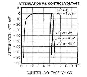

Looking at the VCA's datasheet, we can see control voltage vs gain curve to give us an idea (once we know what the DA is doing to pin 8's quiescent state).
The real question is whether or not the DA can bring the voltage up to at least 2.5v where the gain cannot go any higher. If pin 8 is above that voltage, then the feedback path is the only way to increase it further.

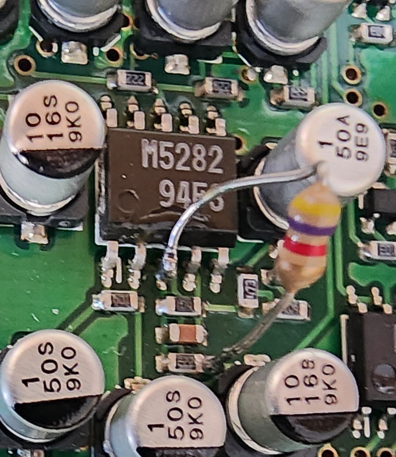

i can verify it does work without the resistor i had to have the volume at 12 to 1 o'clock i held the resistor on the 2 spots while the wife connected the power cord, listening through the headphones, i had to lower the volume to 8 o'clock. Now the bad. i need a better headband magnifier. 3.5 is not enough for my bad eyes, and 2 is very tight to solder i just can't find a good, clear copy of the service manual to see if i can tap somewhere else for the 2 spots. The funny part my hands only shake when i grab the soldering iron and bring it close to the component.
Well, i took a chance, heart racing, feeling like them guys in the movies trying to defuse a bomb, red wire, white wire, shaky hands. But I solder that sumamabitch resistor on there, thanks for the replies. Now the 8 o'clock position is like 1 o'clock position. Reason for the mod is when the volume at 1 o'clock to monitor my audio, when i unkey the volume is super high, whether through headphones or an external speaker, compared to now at a reasonable listening setting

The monitor function on the IC-746 tends to have low output compared to receiver AF volume; therefore, in order to listen to yourself, you have to increase the volume. When the PTT is released back to receive mode, the AF setting nearly blows your speaker or your headphones.Add a 4.7K resistor in parallel with R1087. This brings up the gain of IC1082 to a more reasonable level that can still be controlled by the monitor level function, but with plenty more gain
