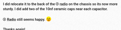

Forum gripe. I looked at this page in a private tab (not logged in) and it seems things are being inserted into the middle of peoples posts. I can see a little advertising at the end of a post, but in the middle of it, and using their own words as links? I think trying to make something appear as if it were posted by a user is a little on the shady side. I happily pay to have no ads, and I totally understand having ads to further support the site, but it should not be happening in this manner.
The lightning symbol and the word Radio become a link. The site is literally turning peoples words into links. This is what happens when clicked.
Look, I get it, ads pay the bills, but when you turn the words of your forums users into marketing opportunities, it is a misrepresentation of that user. The person writing the post, paid member or not, did not endorse whatever product or service the link goes to. Mods/admins, please put a stop to this.
