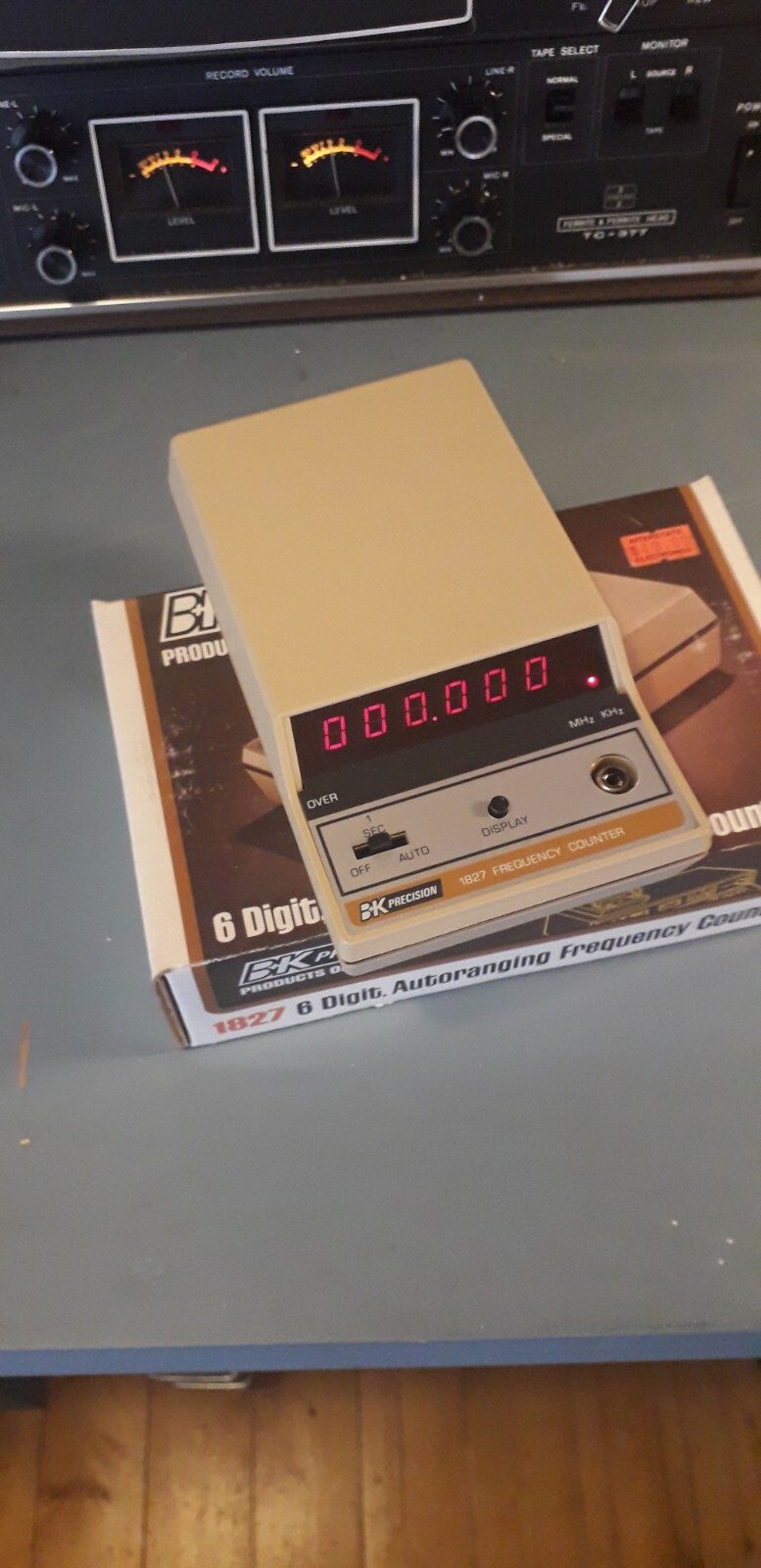

andy this is the freq counter i had which is perfect for my issue i got lucky and found another new in box never been use all the way in spain
B&K Precision 1827 Frequency Counter
NOS , new in the box , never used
Awesome, but have you "tested" calibrated it to a known standard?
NOS is great, but older components and aged caps - work against the ppm accuracy the counter was originally rated for.
So I wish you the best with that, neat little unit that I'd like to have on my bench as a simple go-to tool for pretty much most of the work done around the bench.
I'd use it a lot - I just hope the age isn't affecting the performance knowing the years and many changes - that have occurred since then.

well I got 1 of the 2 b&k-1827 freq meter today this was $20.00 guy claim it doesn't power up I knew exactly what was the problem corrosion by batt pack easy fix well here is my reading for adjusting my SSB for tp-3 on ct-2 was a hair off on am is spot on with my new dosy counter
tp-3=lsb-7.80149 usb=7.79850
