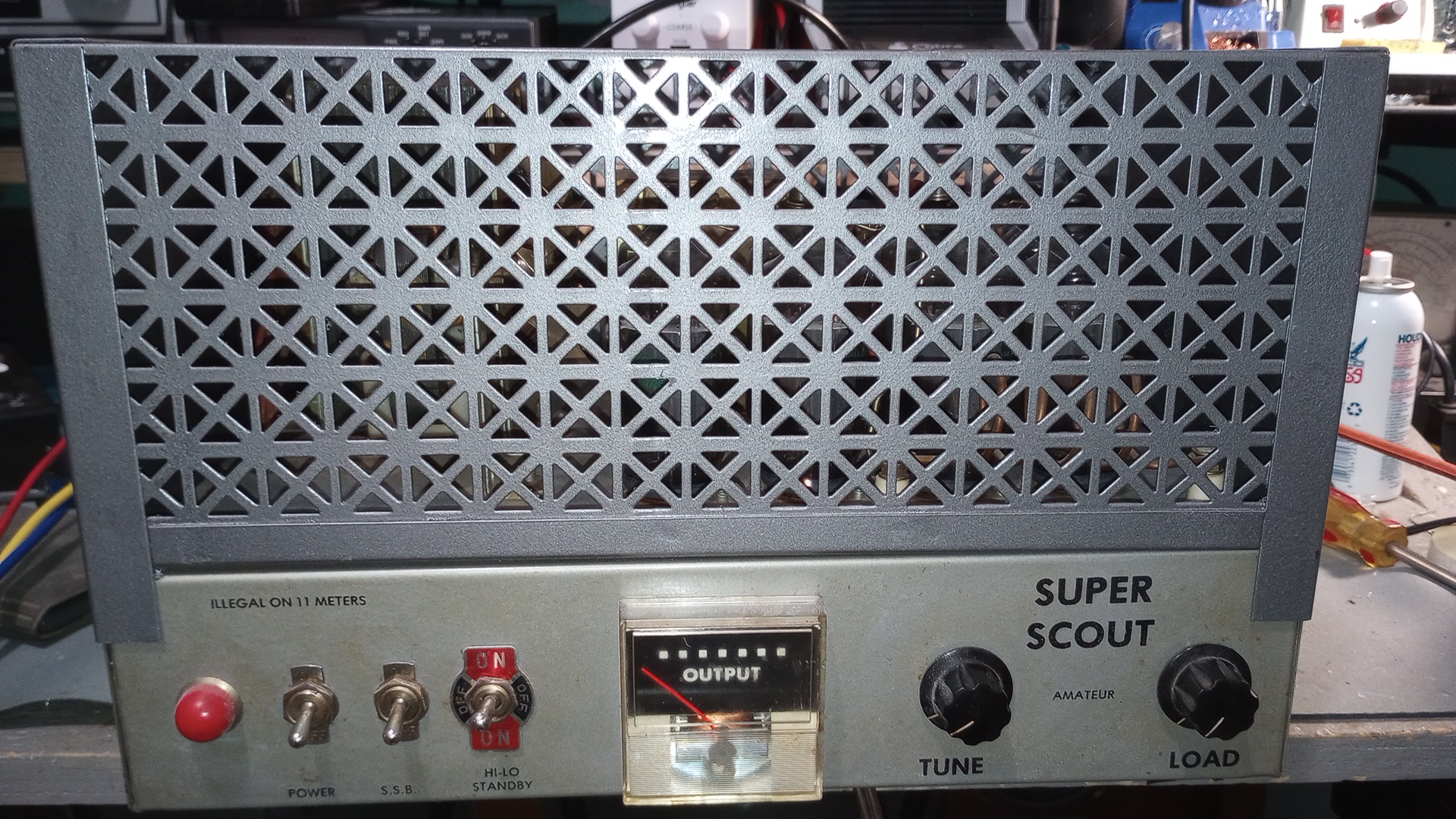

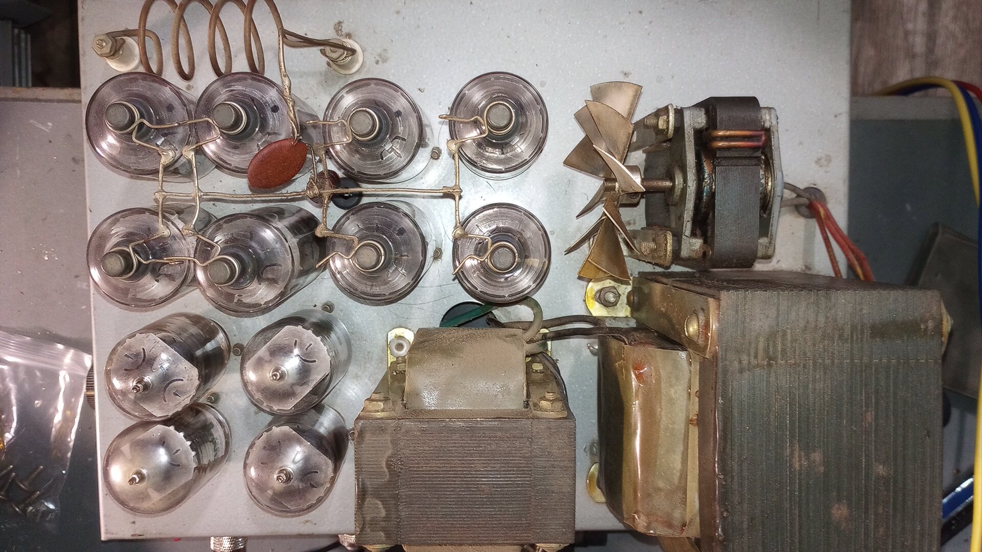

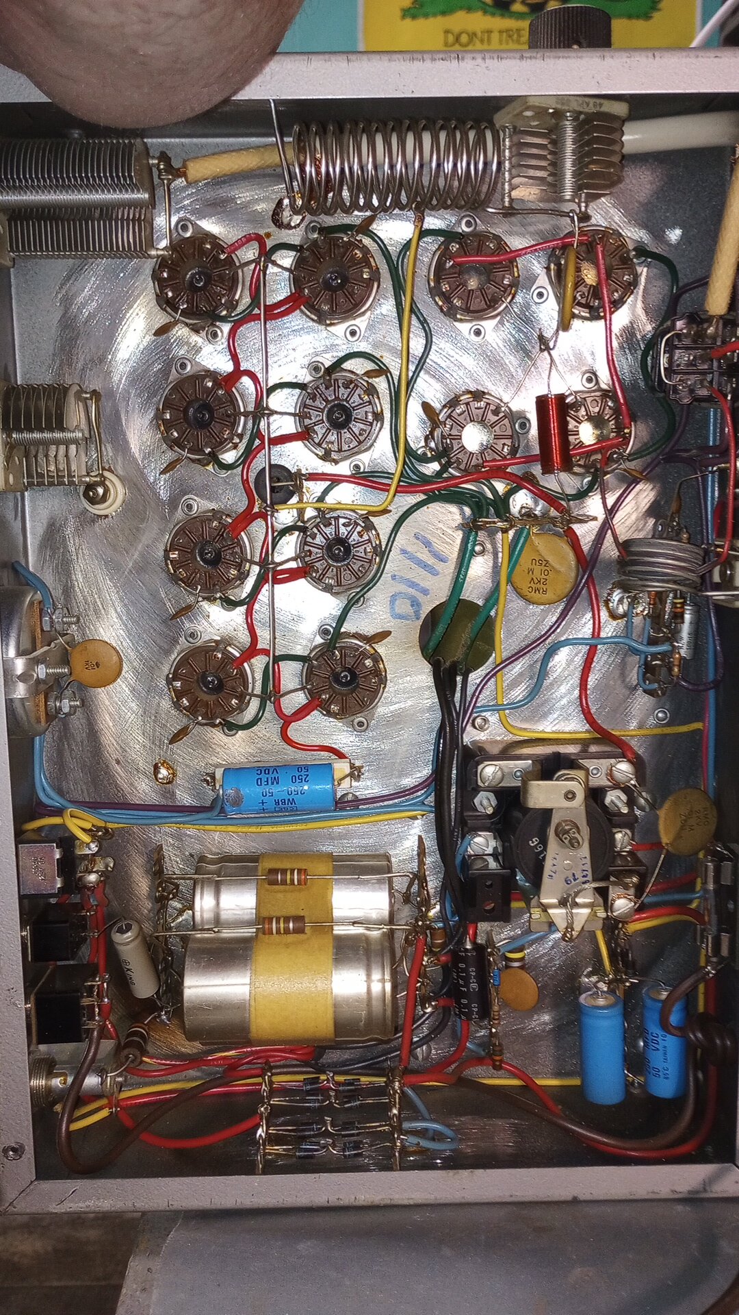

Hi all,
I got a 12 tube, 4x8, super scout. I think it's a sos brand, not sure. Looks pretty good under the hood, but doesn't work. Putting 4 watts in gets 4 watts out, regardless of hi/low switch. Both relays make contact when keyed.
Was told it was working fine, until a spark was observed near the tubes, at which point the output dropped to nil and the plates cherried up. The operator was probably driving the snot out of it at the time tbh. :sigh: I can't see evidence of a spark under the hood, but could have been arcing inside the tube i suppose.
So does anyone know what voltage the hv trans puts out? I cant see the capacitance-voltage multiplier values to figure it, and I have a gut feeling the hv transformer is shot. Any other info would be appreciated as well. I'm in no hurry with this thing. Thanks for looking.

The good news is, you can't turn tube anodes cherry red with a bad power transformer. My first question would be, what tubes turned red, drivers or finals? If only the drivers turn red, check the plate choke feeding DC into the caps of the eight finals. The flash that was seen, may have been that choke burning open. The choke is the part that is fed from the bottom, with one wire through a grommet, at the center of the eight finals.
Proper plate voltage would be someplace around 900 volts DC, plus or minus about 75 volts. Judging by your description, that is very likely to be intact and lethal.

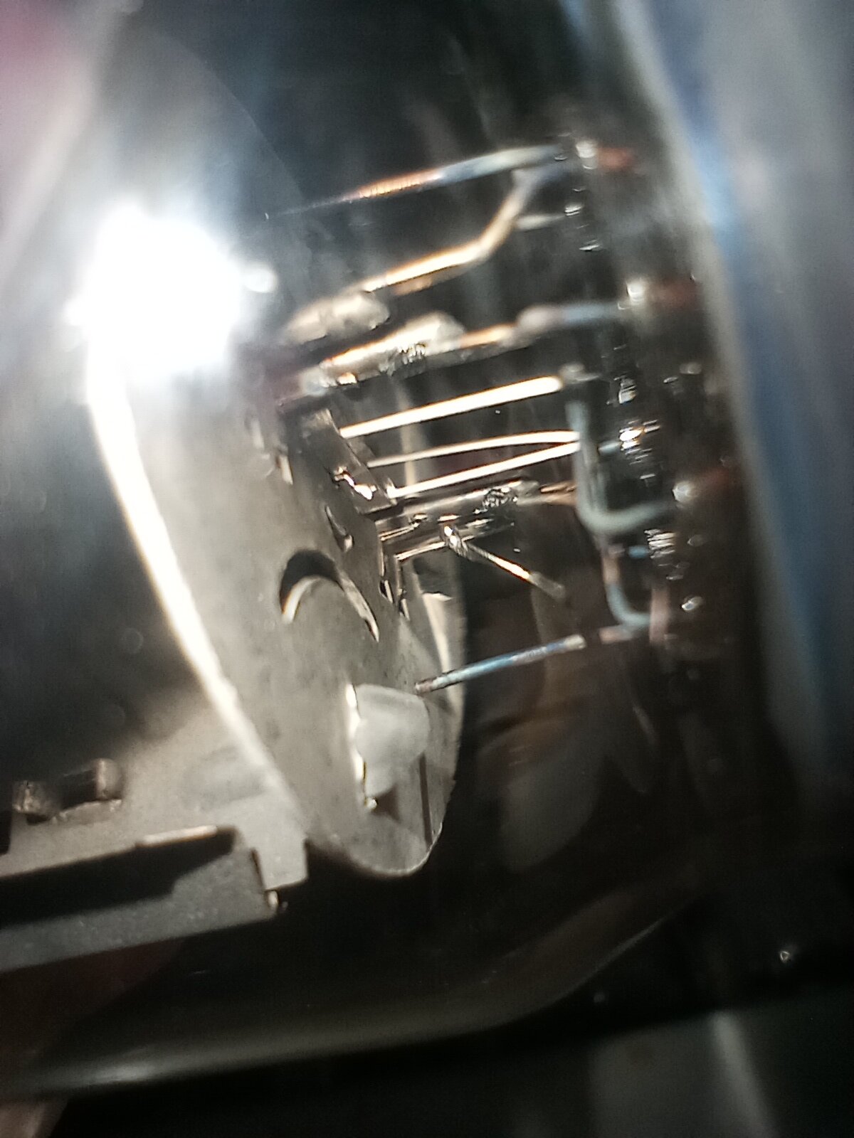

I don't know for sure, but I think these tubes are goners. There is what appears to be a burnt link in every final tube. The trans is good, the cap multiplier checked out and the diodes are rectifying, and then there is this.
Per the datasheet, that link connects the cathode to pin 3. Every one of the finals have a blown cathode to pin3 link, so this is a lost cause. Thank you Shockwave and Nomadradio for your insight. I can't say for sure what caused this condition, but I feel the foiled fuse, and a short somewhere, could have been the nail in the coffin.
