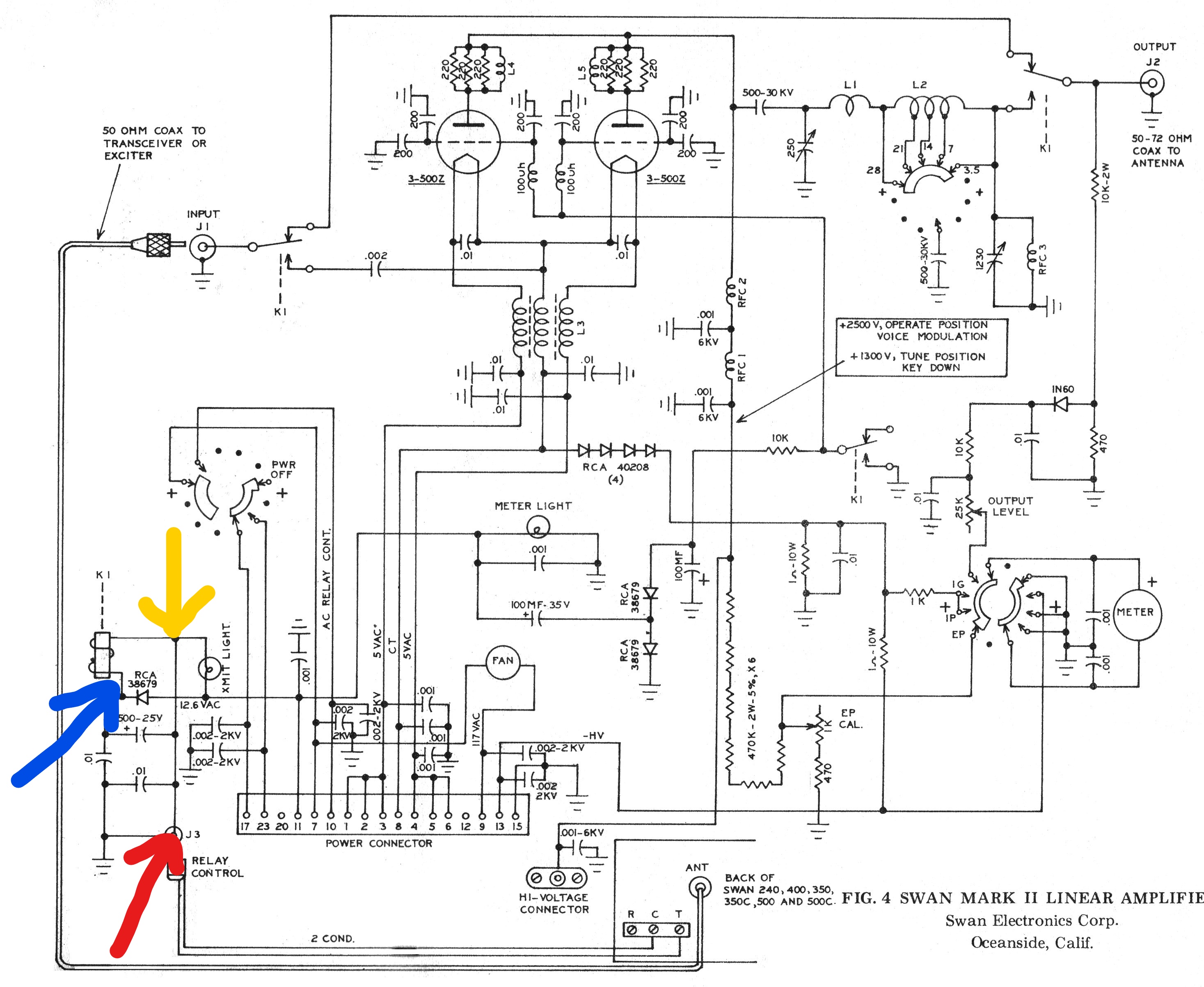

As you can see from the schematic below, the blue arrow indicates the 12.6Vac provided to one side of the relay coil and the Transmit light by the amplifiers separate but necessary power supply. The yellow arrow is the negative side of the relay coil and transmit light. When connected to chassis ground via the J3 socket (red arrow) on the rear of the amplifier chassis, the relay is energized and the transmit light is lit.
You do have both pieces (RF Deck and Power supply) of this amp don't you?

thanks, Dmans
yes. I do have the power supply, so i can make my own open and close foot pedal?
Yup!

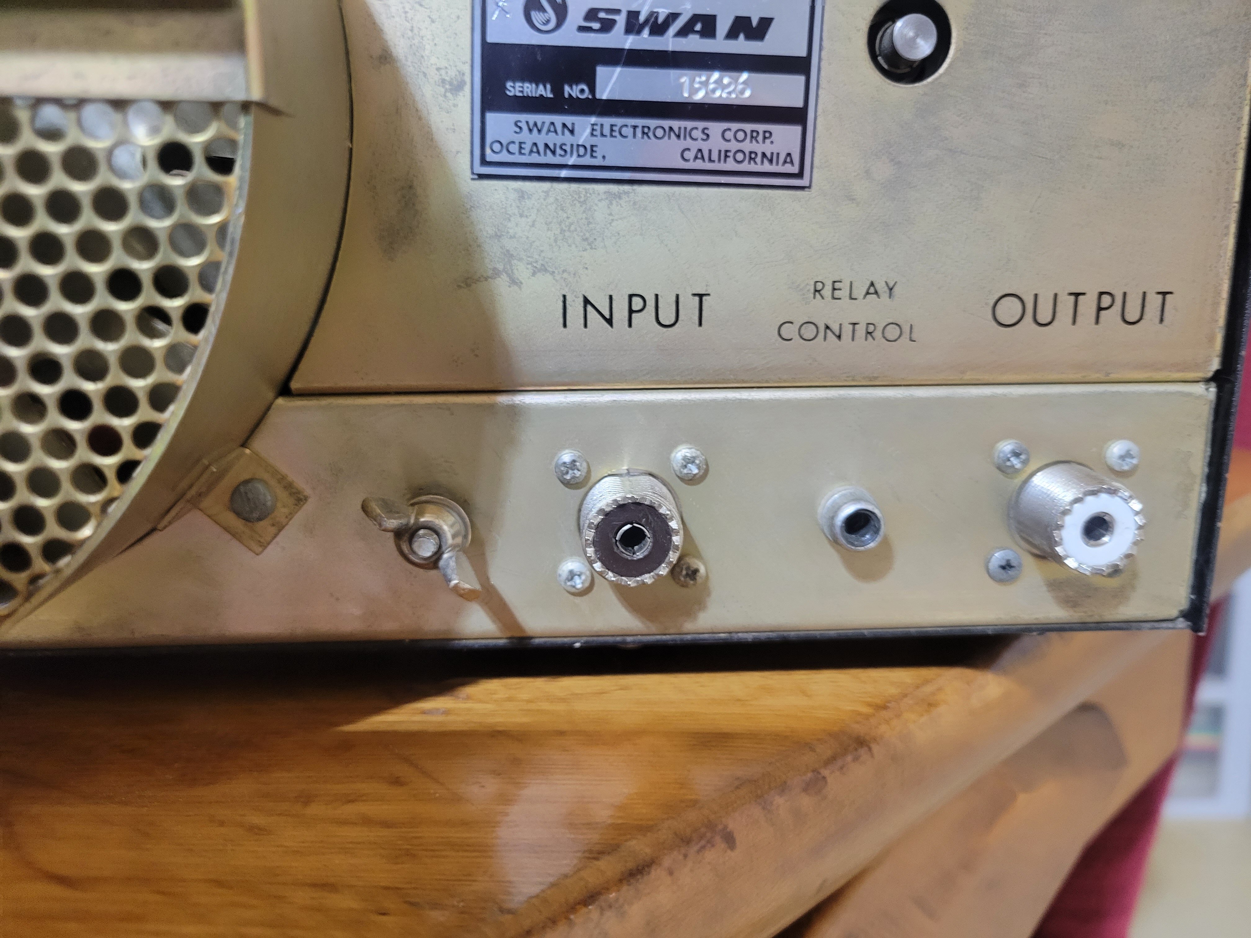

Older Swan amplifiers saved a buck by leaving out the power source for the relay coil. The keying cable to the radio had a 'hot' and 'ground', but both were hot until you keyed the radio's mike. The keying cable was wired across the radio relay's coil. Placed the linear relay's coil directly in parallel to the relay coil in the radio.
Quick way to tell was to look at the keying jack on the amplifier. If the outer body of the jack had an insulating washer under it, a footswitch alone won't do the job. And if the body of the RCA jack is grounded, you're good to go with a footswitch.
And if you get tired of the foot switch, you can put a relay in the radio put a RCA jack on the rear panel and key it with a patch cord.

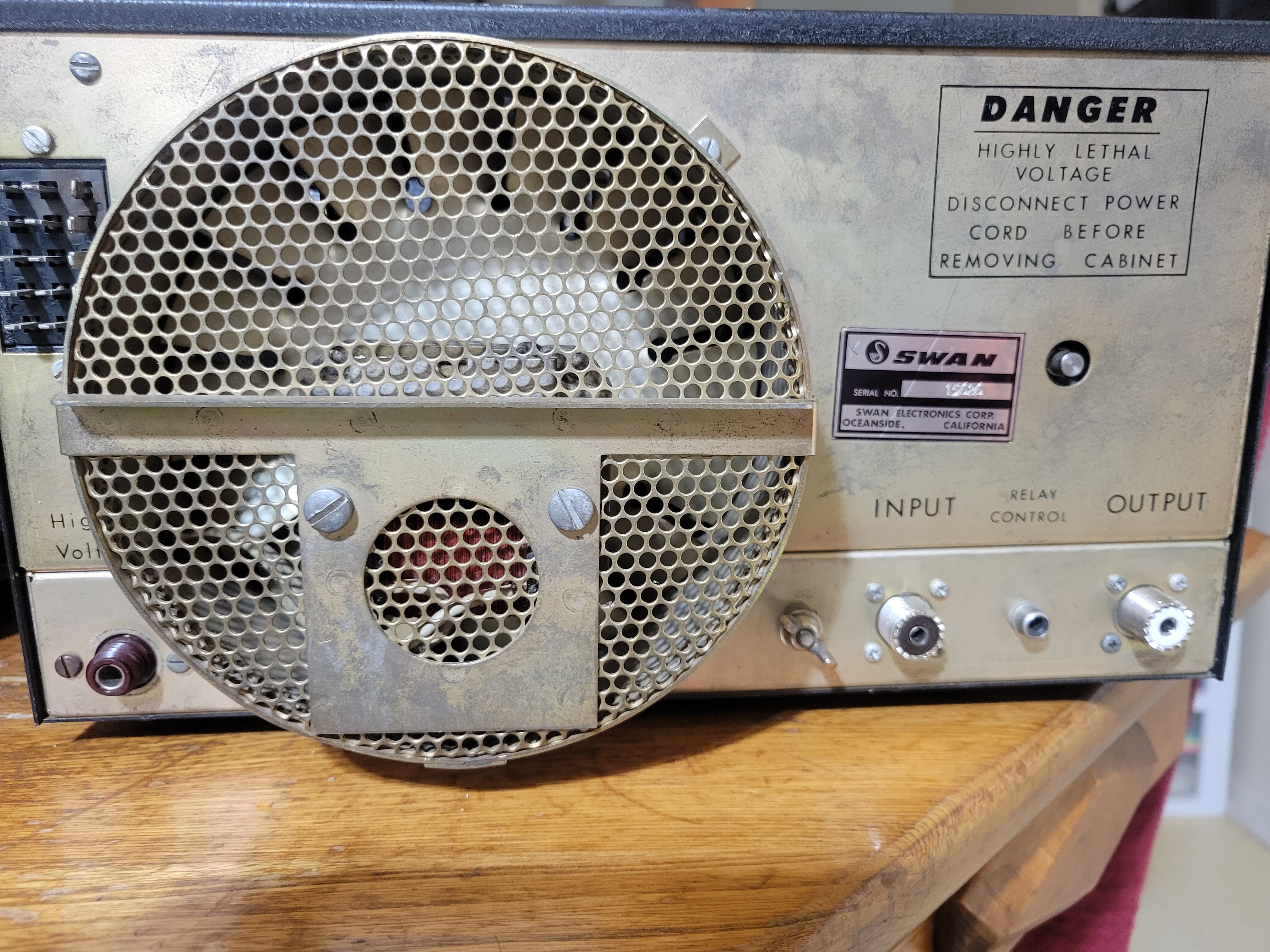

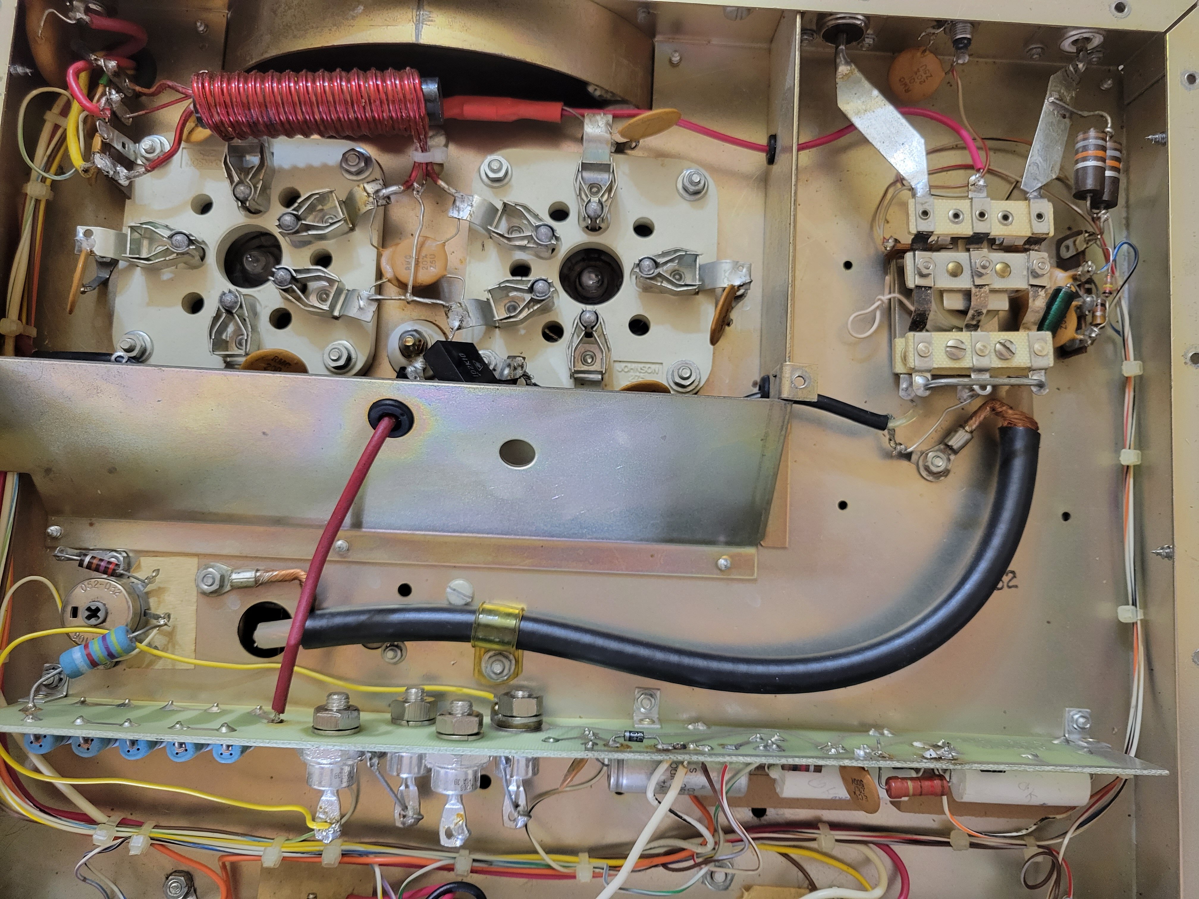

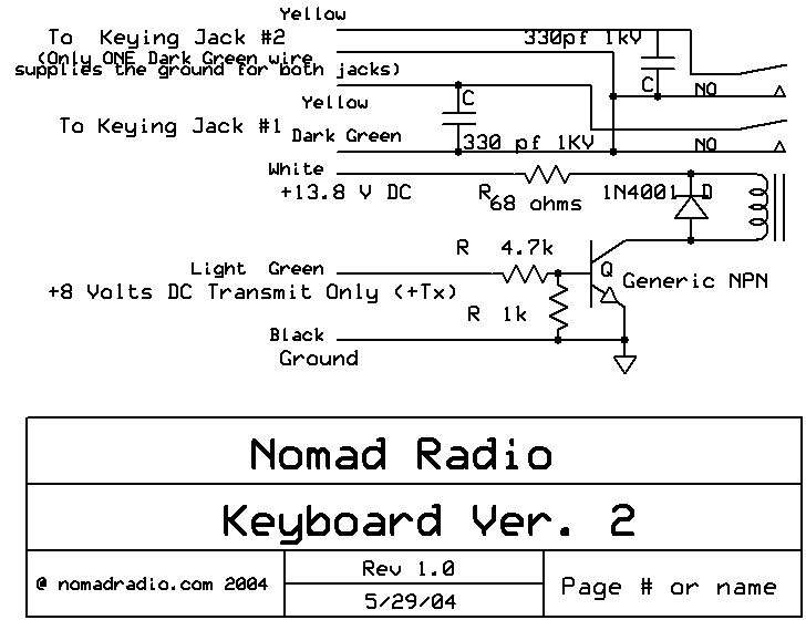

I already sent a couple weeks back a message on ebay for that nomad keyboard relay, there are the ones that told me that it wouldn't work. See below the attached pics of rear of amp.
