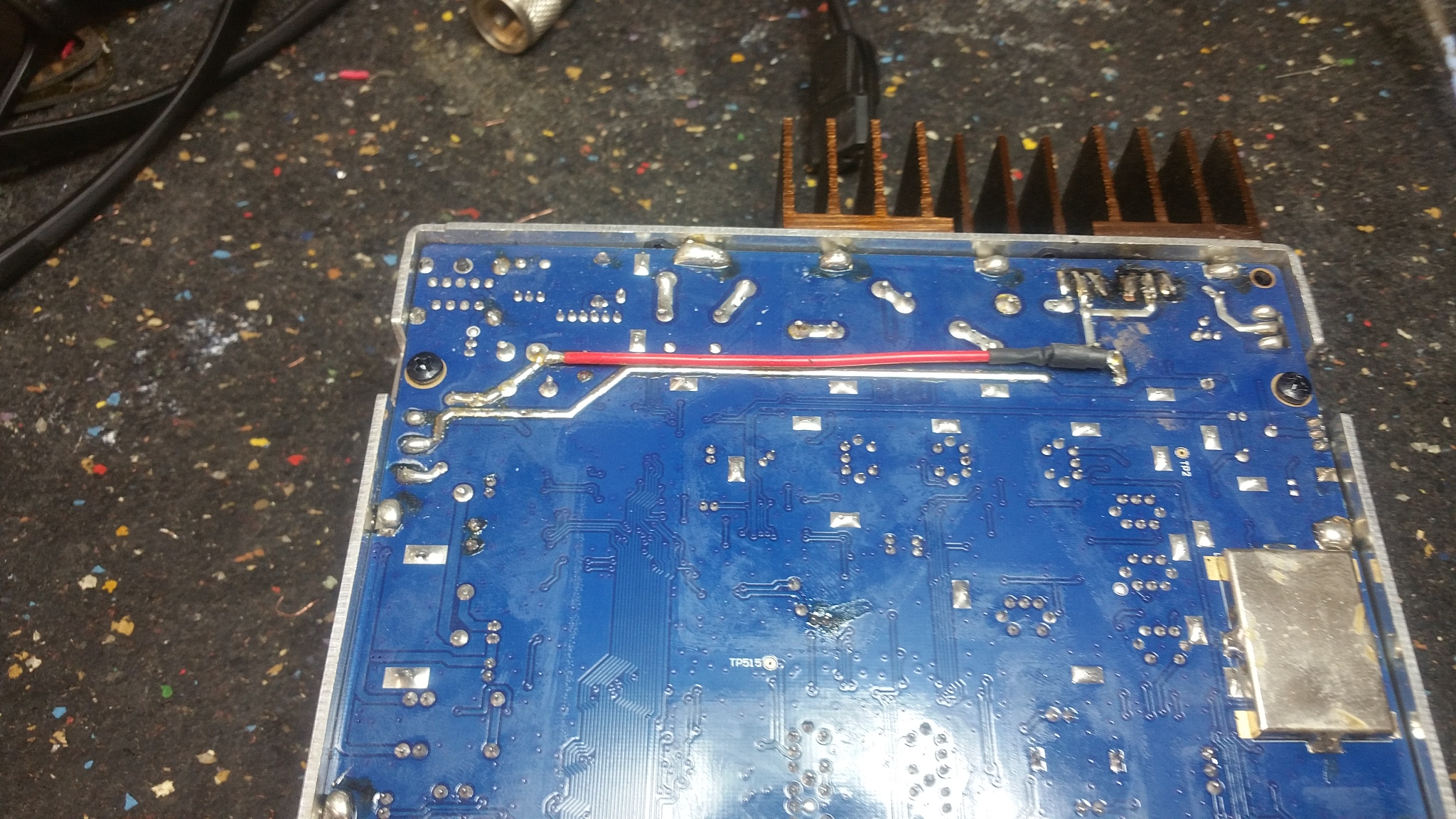

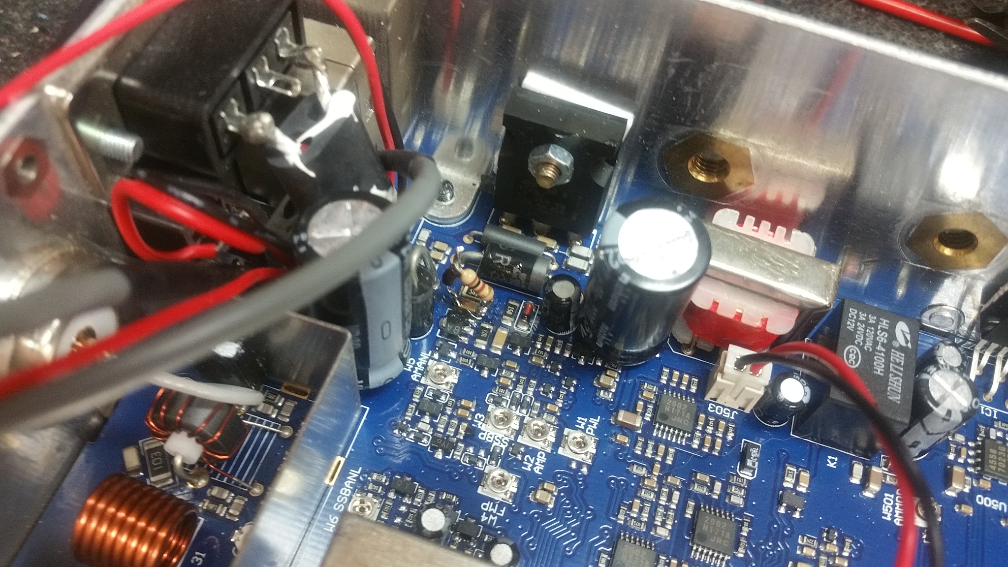

The prwvious owner of this lincoln did the rwob. I tried to copy the mod on another lincoln 2 and it keys 50 watts no mater where I set the variables. What am I missing?
Reactions: grunt07
There's a thread here somewhere in which another tech did one with a diode resistor on the bottom. I'll look for it.

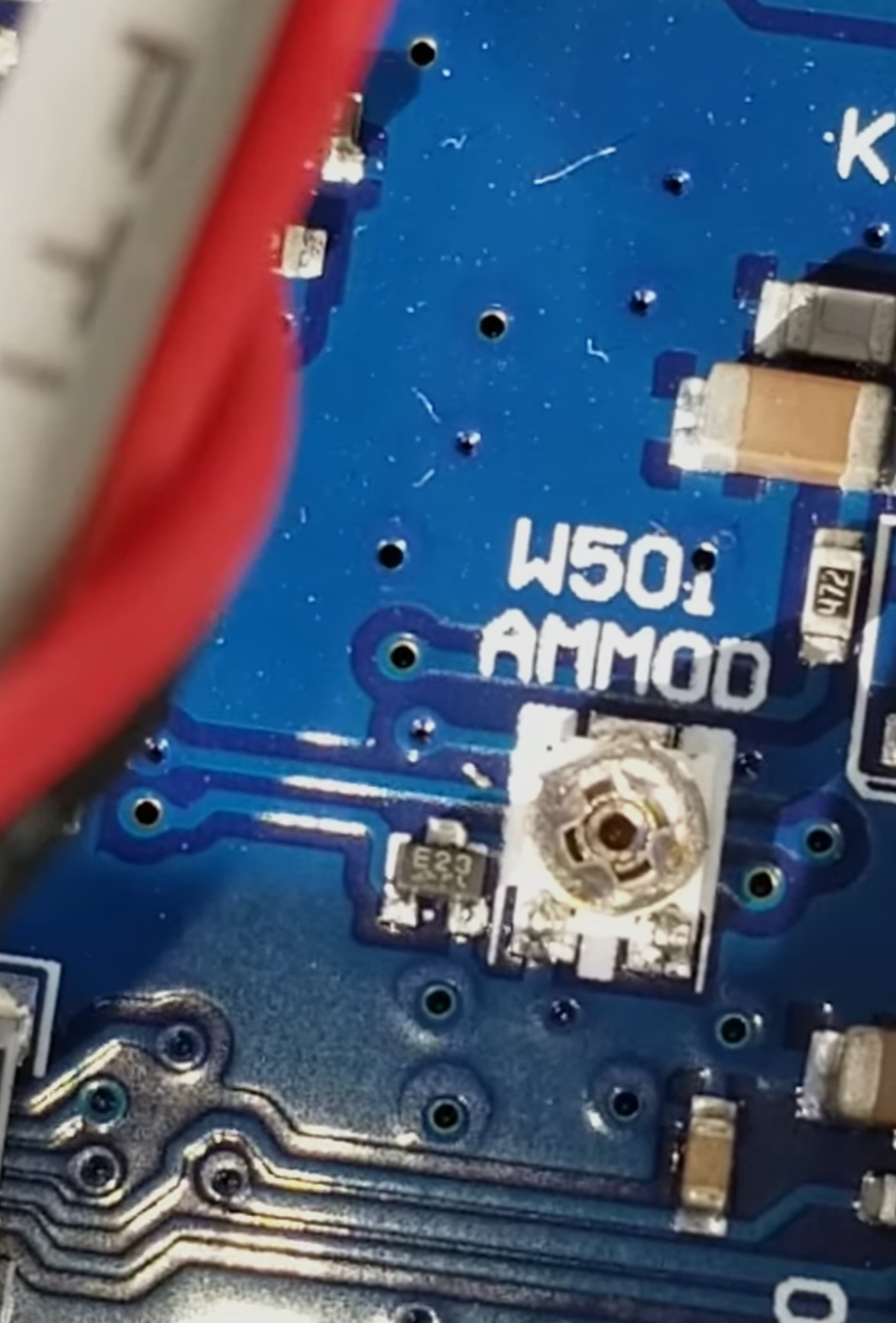

Hey I don't mean to Hi-Jack this thread but while your talking about the Lincoln II+ where do I turn up the modulation ? Is it in a menu ? I looked on the board today and didn't find it. thanks for being patient with us young guys ! LOL
Reactions: Enterprise312ok
Look at the bottom right hand corner of the picture above. AM Mod should look like this below
