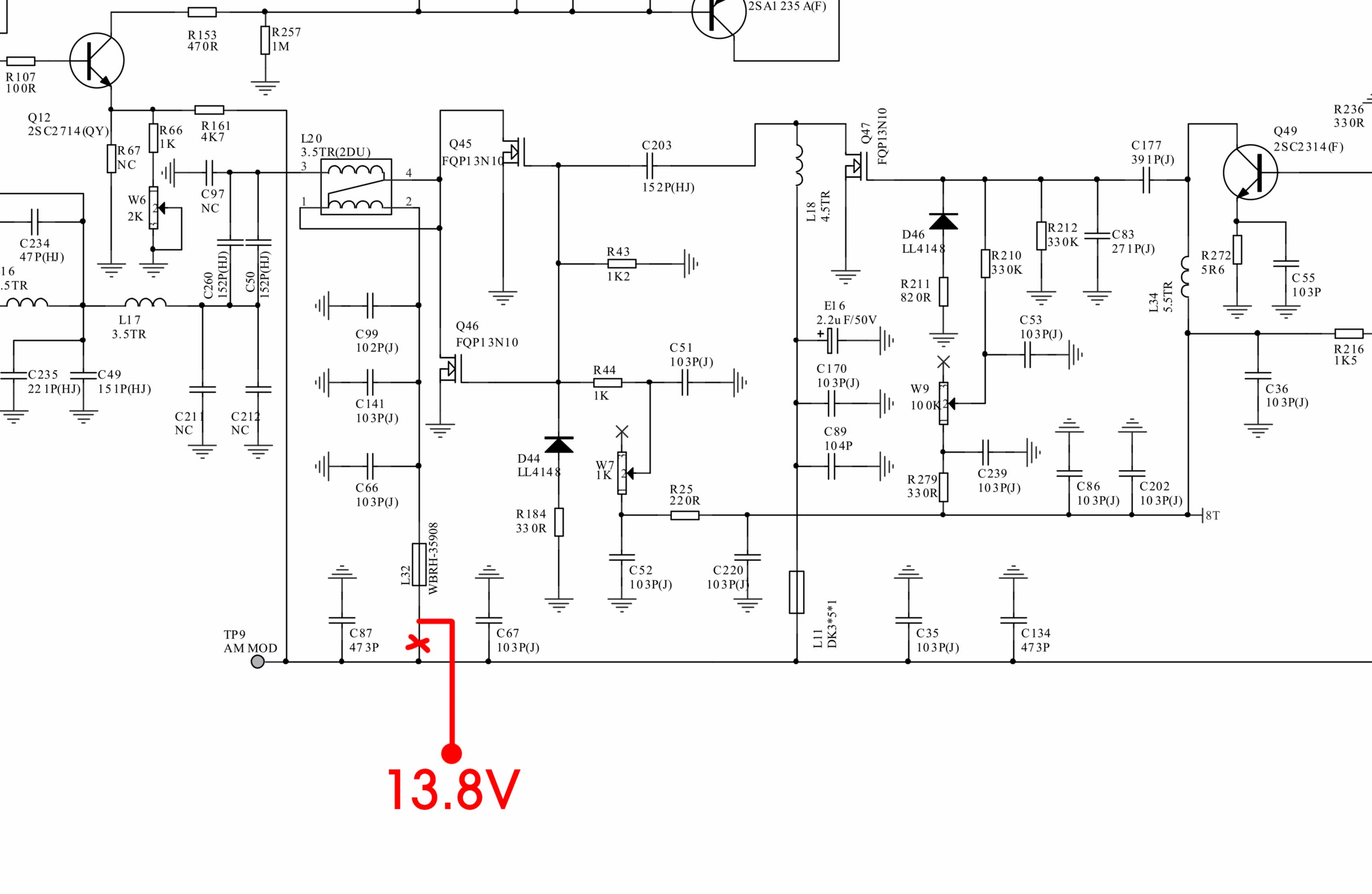

RWOB attached here.
Do not forget to lower power with W2 and W4 before doing RWOB. Set power after mod.
Mike
I did the Lincoln II mod last week - thank you to sp5it for all of the information.
Extremely small SMT parts but I managed to get my resistor and diode attached.
The big problem with these radios is they aren't designed to be set low on AM and swing upwards. The NPC mod allows you to set the deadkey below 1 watt and still swing upwards for use with an amplifier on AM.
