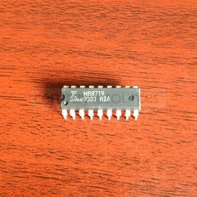

Regarding the MB8719, I purchased a few from this Chinese eBay seller a few years ago and they tested good.
