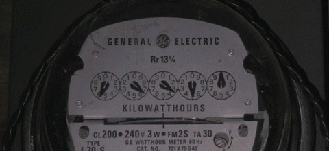

The best way I've found was to disconnect the house electric meter ground rod, if possible. Measure for any AC voltage from the house meter case to the ground rod. If not removable, pound another 4 footer into the ground as close as you can to the original rod without touching it, and use that as your ground reference instead of the meter ground rod... You're checking the AC voltage potential at the house meter coming in, and it's earth ground via the meter's ground rod (or your new substituted one). If there is any voltage at all, you need to correct that first.
Then, go to the shack's closest earth ground source and with the voltmeter, do the same type of check. Any voltage is not ideal, but more than 3VAC indicates woefully-insufficient ground at the shack. But I would check the utility's incoming potential first. You'll never have a good ground if electric coop's potential coming in is out of whack. If it is, call them and ask them to fix it. THEN, you can fix yours if needed. But not until.

Let alone watching the Power Company Meter Spin from the shorts...
