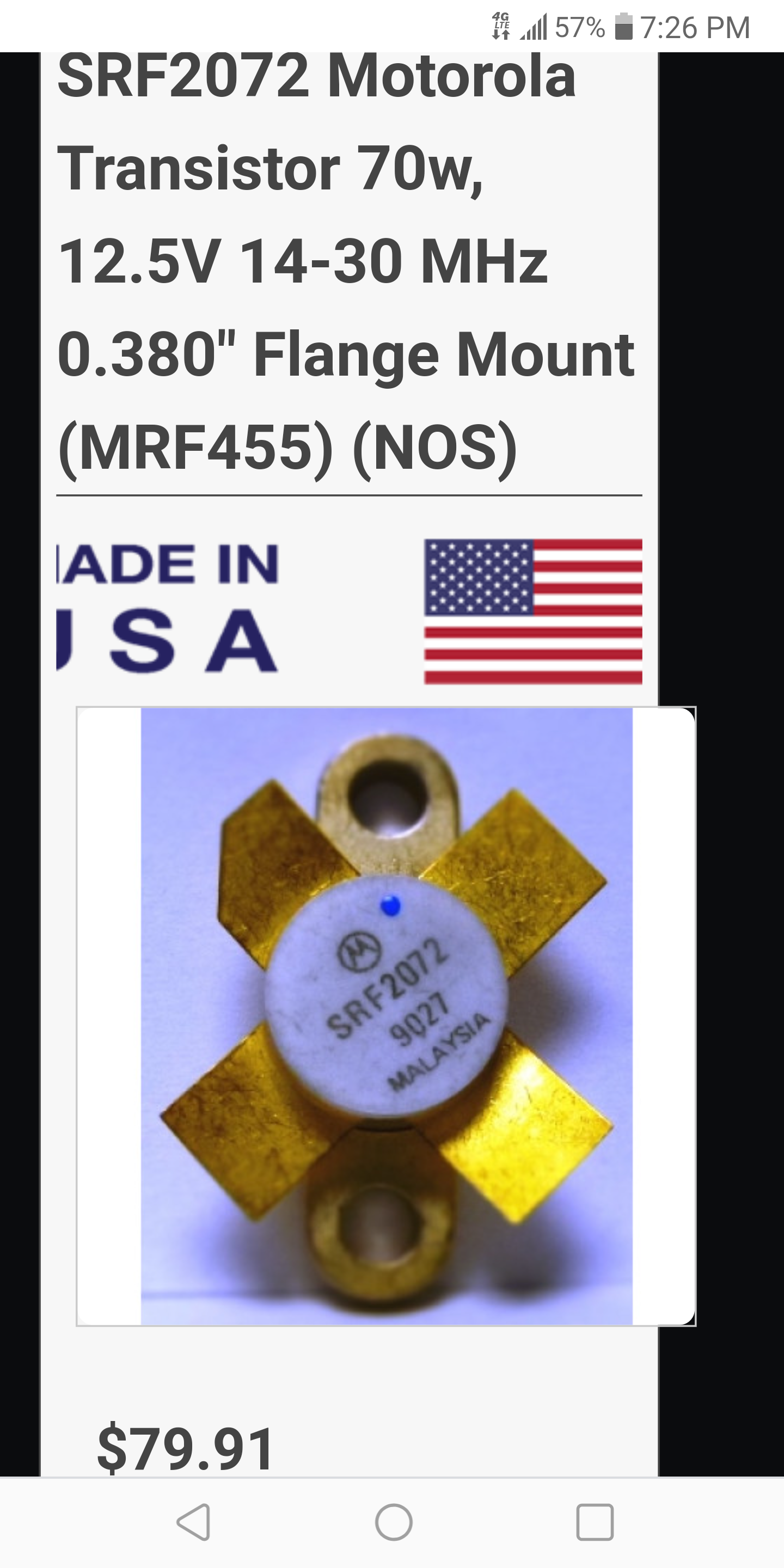

Well, that's the thing, the transistors are SRF 2072 and I'm guessing from late 70s to 80s. I could actually change them, myself, I've done quite a bit of soldering and such, just not a diagnostician. I've scrutinized the inside and can nothing that was overheated, no discoloration of anything. The radio was throwing a 15 watt carrier on SSB so my guess is the outputs are toast. He has the opportunity to buy another DX-250 from a guy, but we're trying to see if he'll let us test it first. He can get it for $150.00. More than likely cheaper than two transistors. I'll just have to do the power wire upgrade on it if he gets it.

$80/pill at rf parts
